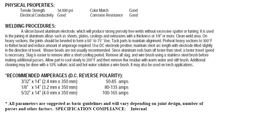

I got on the online chat with Harris, and they sent me a spec sheet. I couldn't post the whole PDF file, so here is a clip of most of that doc.
Attachment 3256
Thank you Dave. I will have to give those rods a try sometime soon. Have you ever welded aluminum with a stick welder?
For the moment I'm limited to my little AC crackerbox welder (altho I'm planning to upgrade when finances allow), so I haven't stick welded aluminum. At $25 a pound these electrodes are pricey, but keeping some in the inventory sounds like a smart idea- could prove very useful for a field repair, say, if MIG or TIG is impractical.
haha we are in the same boat.. We have a 1940's-50's AC buzz box with kill-ya-off 295 amps. Gotta be really careful not to step on the cords or drag the cords across one another it WILL shock you. Even through 600v rated Redwings...Lots of bare spots in the cables. We are really thinking hard about a PowerArc200 or 300 (Everlast stick welder) to replace the killer queen buzz box.
Well I got a email back from Harris inc. She said the beryllium content was in the flux and the filler metal was indeed 4043. So yeah, Hobart sells the stuff too as 4043. It's about $9 for ten rods. Buck per rod :O 7018 rods are $0.16 for me....
