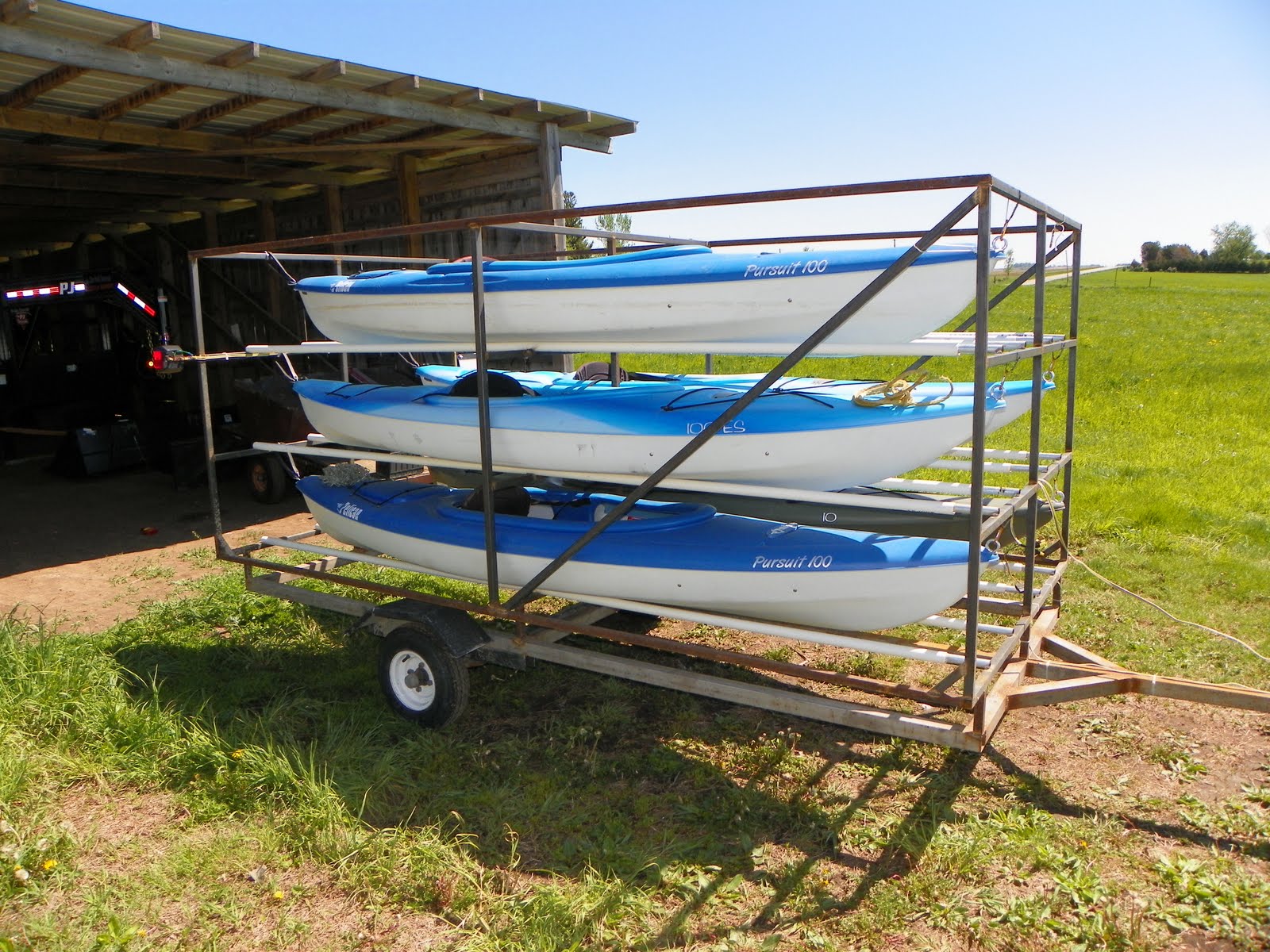

We are planning a trailer to build haul 6 kayaks 10' 1"L x 28"W x 16"H. Trailer must be fully enclosed by semi tarp or aluminium. Weight limit of +/- 1200 lbs total (pulling with a Honda 4 cylinder LOL). Don't worry, it pulls like a Dodge. Max tongue weight of 200 lbs. By now you see why I want at least tips and ideas. The boats will be loaded by sliding them lengthwise with the trailer, each boat having it's own compartment conduit dividers possibly. We would like the compartment configuration to be 2 wide x 3 tall.

You don't want put too much weight forward of the axle. You'll want to put about 10% of the weight on the tongue, when loaded. That's the biggest mistake most people when building a trailer, and a cause of hard pulling. Too little will make it fish tail uncontrollably. To much will drag the vehicle in the back and cause it to seem to lack power and control.
That's kinda what we are doing. But my Dad's built several "DOT road legal" trailers. Thanks for the 10% rule of thumb, We did know about it. That's a very nice ATV trailer you built BTW. I will post pictures eventually. The trailer building has halted because we are short on square tubing. Wish we could afford a TIG welder for the thin walls :(

The frame's done. Axle and wheels are installed. Doesn't look good yet, so no pics. It took some doing to keep the frame square while it was welded, it is square now.

Yep the frame is 2" x 2" square tubing. The uprights are 2" x 2", and the rails are 1" x 1". We've got to get 'er all welded and sand blasted, then I'll grab some pictures. I've got a 14.1MP camera, so I always upload pictures to my Picasa account then link them here that way they are full resolution.

It's coming along slowly but surely. We have rented a tree spade and are moving 200 trees I believe. But last weekend Dad got 'er all tacked the trailer frame is done. The racks are welded, but we need to put in some stiffeners ("X" bracing). I'll get some pics soon. So far it's staying under 150 pounds.
How bout some pictures!?!? ha ha. Pulled it 120 miles on Friday and it's still in the same condition it left the shop in! :)

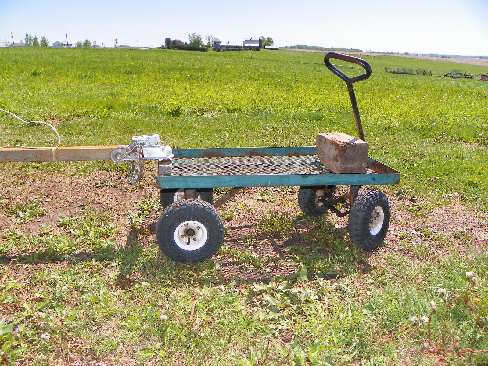

How do you like my trailer hitch wagon LOL?https://lh3.googleusercontent.com/_K...0/100_0559.JPG

It takes about 4 minutes to load, latch, gather belongings, and go; after a good day of "fishin n boatin". Which is way better than about a half hour to forty-five minutes tying them all down with ratchet straps and having to re-adjust or tighten every 10-15 miles.

If you ever have problems with the welds holding the round tube to the frame breaking, put them back like this. Weld a short piece of angle onto the end of the tube and then weld the angle to the square tube. This way your welds on the tube are 90deg apart instead of close together at the bottom and should hold better.

Yeah, roof racks are pretty high up... We've strapped 5 boats on a ATV trailer before, didn't work so good. We used like 10 or 11 ratchet straps, you tighten down the first two, then the second two, finally tightening the fifth boat. By now the bottom boats are severely crushed under the weight/tension of three sets of straps...

Oh, BTW, the trailer weighs in at a reasonable, 648 pounds loaded. We are thinking of putting a piece of aluminum sheet to cover the front lower third of the trailer to save the boats from road rash.
