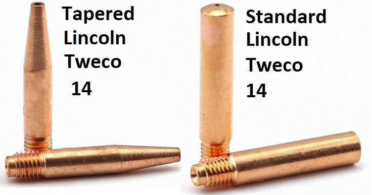

What do you cut with? Have you tried spray arc on your 275p? I try to spray everything I can with the 250p. It's got power to spare and sprays very well using regular 75/25 gas. https://www.everlastgenerators.com/f...250p-Spray-Arc A tapered contact tip is key to not overheating your gun.
