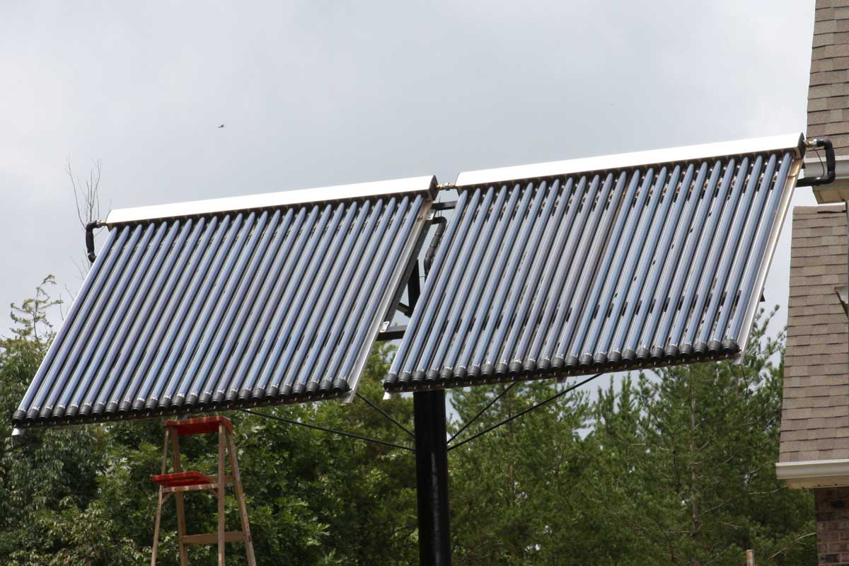

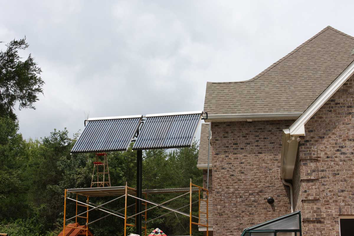

Well I am 99% finished with my solar water heater project. I purchased it from here: http://www.dudadiesel.com/choose_item.php?id=SHS400
If anyone out there has ever considered adding solar to your home, a solar water heater is the most economical option out there. After federal and state tax credits the payback time on the project will be right around 2 years. That's hard to beat!

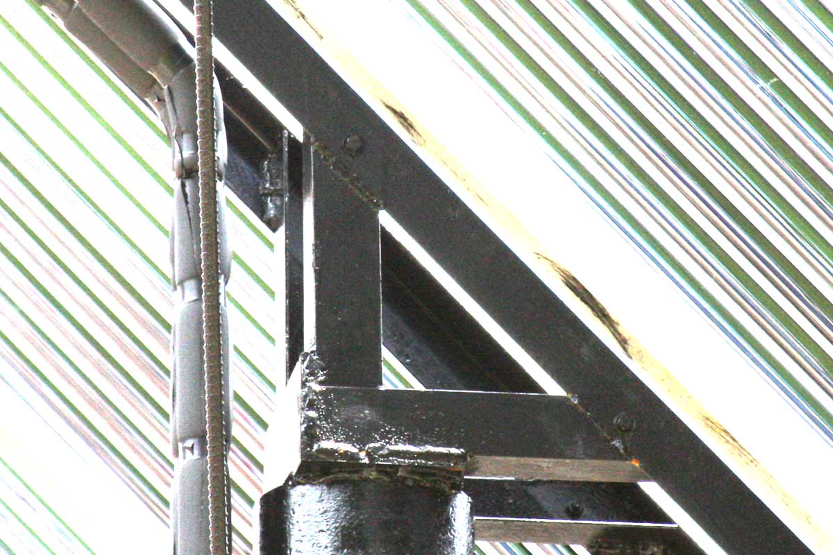

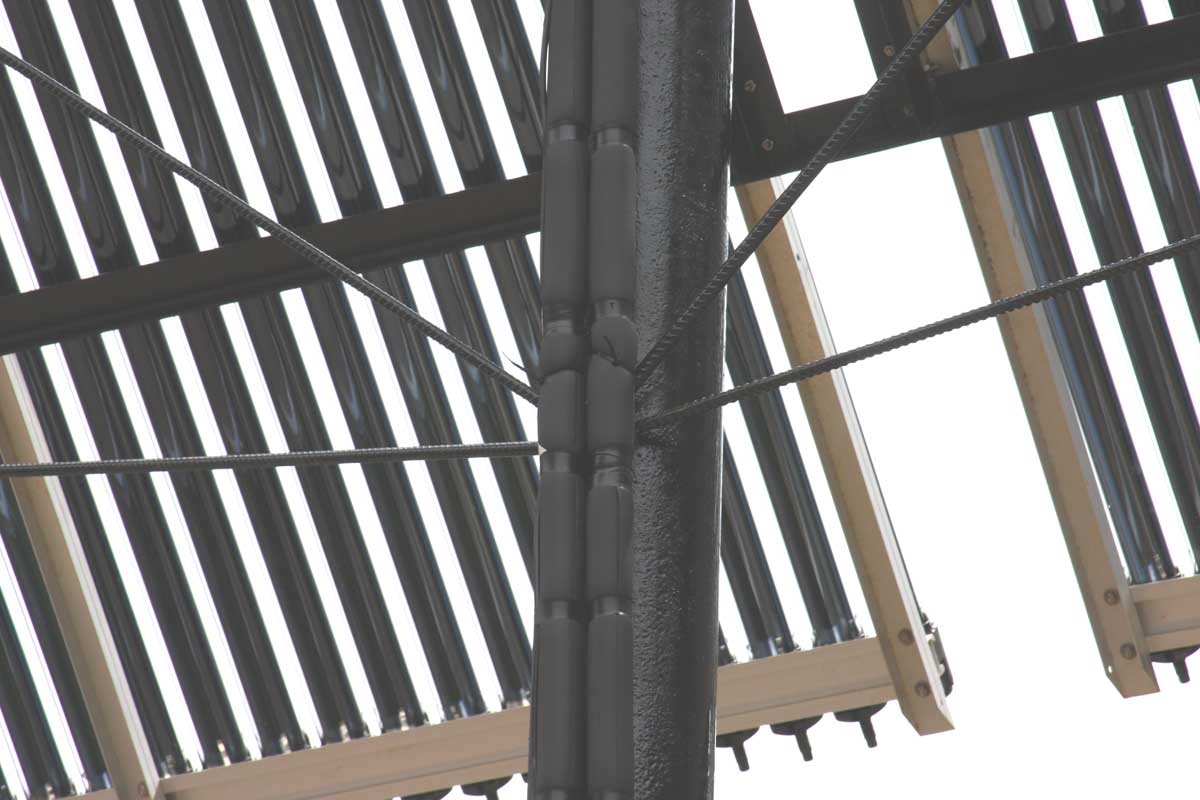

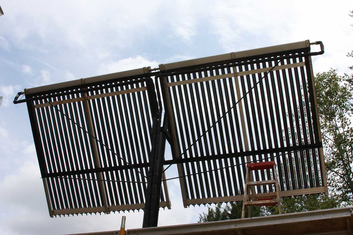

For mounting I built a steel frame and welded it to a 21' stick of 6" sch 40 steel pipe. I'll try to post pictures tomorrow.

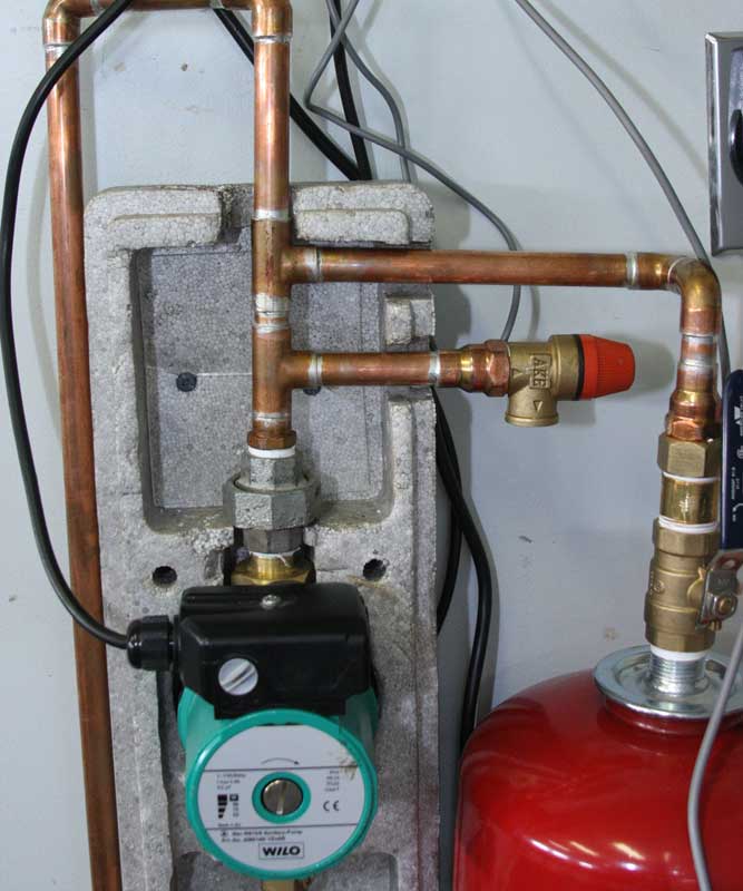

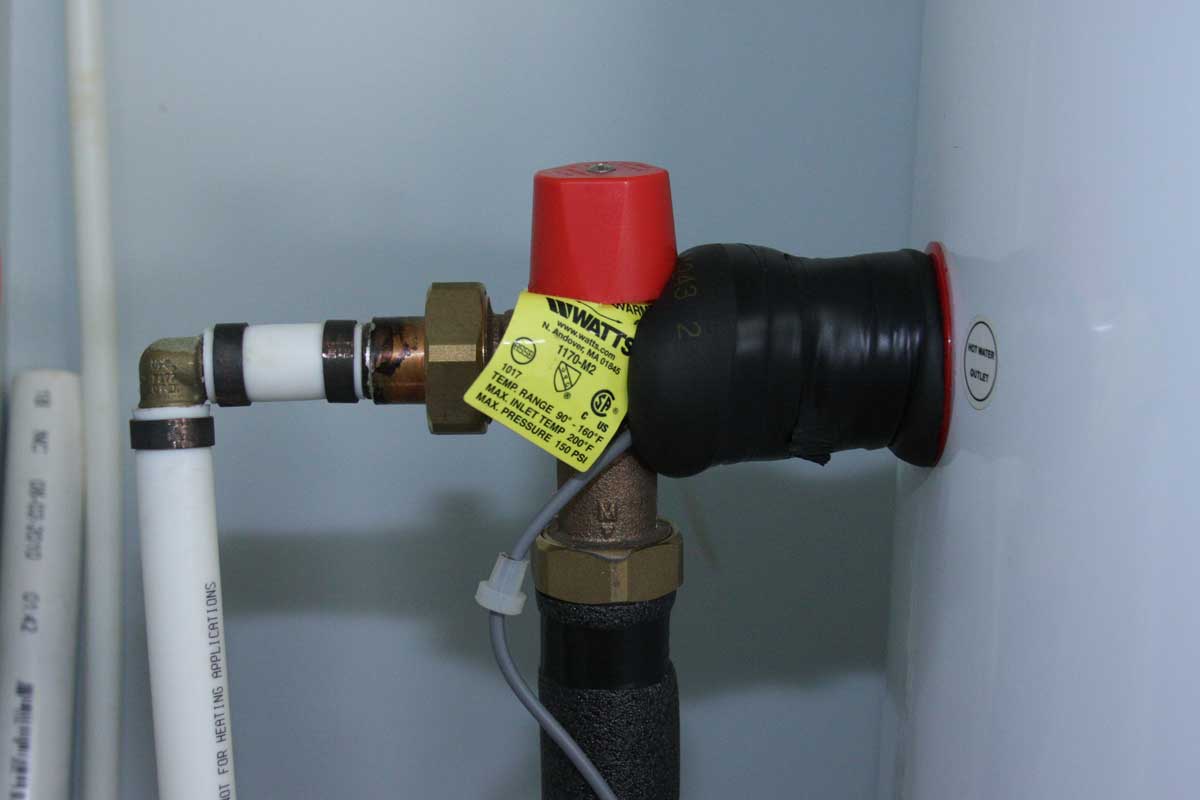

Everything seems to be good except the cheap piece of crap "working station" more like "leaking station" almost every fitting leaked as they were glued together. so I had the bright idea to take it all apart and put it back together using Teflon tape... problem is the fittings used are crap and you can put 12 layers of tape and they are still loose. So for now I am debating on exactly what to do. I removed most of the fittings by removing the expansion tank but I figure the best solution would be to either braze the bronze or just replace the crap fittings with good quality fittings. I guess I always could just glue the crap back together... LOL
