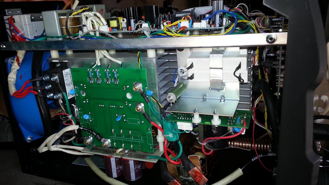

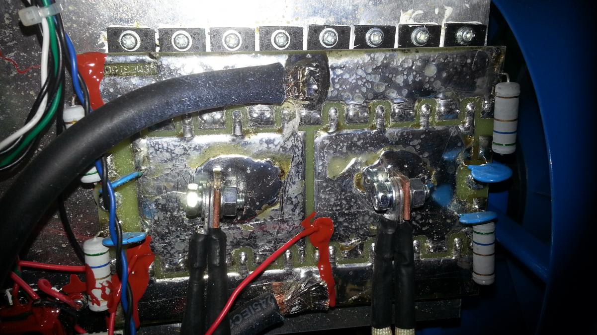

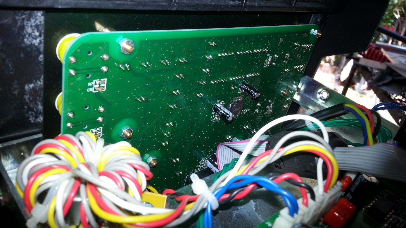

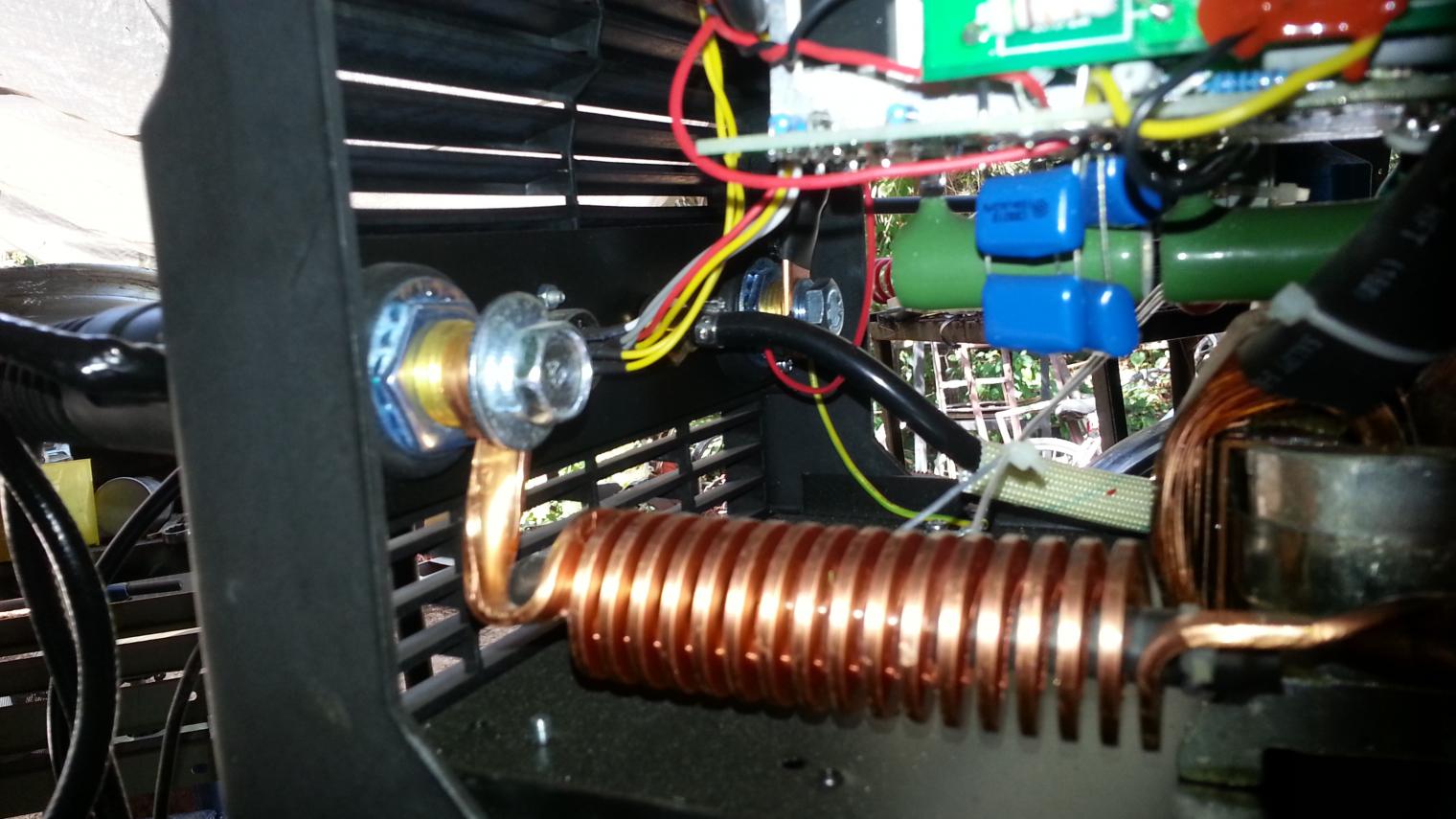

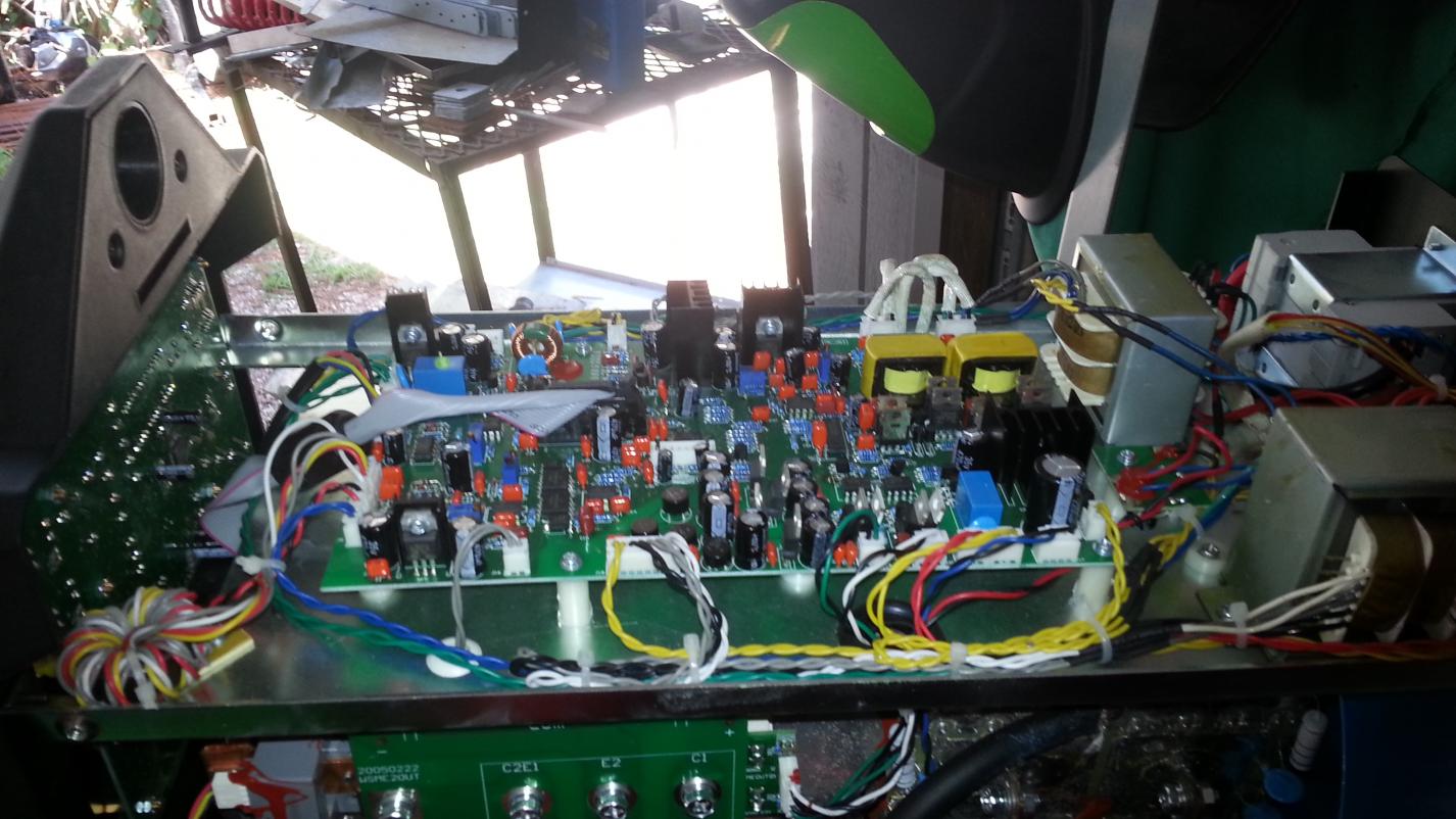

Some inside pics. Forgot to look for a spot to hook up the scope. Will have to open it again.

Thanks for the pics. Did you notice what brand caps were used? That fan looks pretty substantial, how is the noise level and is it a fixed speed, or does it vary with temp? Look forward to your review. Is this an actual production unit, or a pre-production sample?
Fixed...and loud. secondbatch

Any info on the brand of caps?
For me, I find the fan louder...I can't remember the name of the capacitors. I believe it's the standard we use in the 250ex and others. Korean name, if I remember right. Name brand, but I'll have to or Mike will to post.

I like what is being reported, as looking at the pix, Mark's machine has a black fan, and Mike's has a blue fan. I am hoping that the later builds use the quieter blue fan.

This one has the blue fan. I think Mark has the black one. So the blue was 5db less.

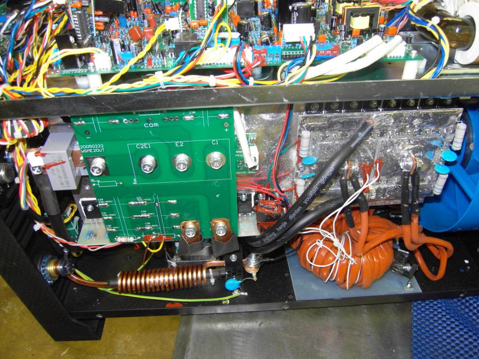

the inside of the 250EX and the 255EXT are very similar it should be a very good machine the 250EX is.
Attachment 10849
250EX
Attachment 10850
255EXT
The "final drive" so to speak is very similar.

The final drive is the same, 250amps of power.
