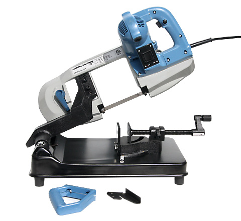

This is the version I might spend the time to make or modify something else into.
http://www.littlemachineshop.com/Pro...0/480.4829.jpg

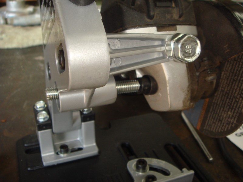

Well, the Northern Tools stuff came in. The mini chop fit the HF $9.95 4.5" grinder with no problem. After attaching and tweaking, it was a good choice as it will stay attached. Will not be pulling it off and putting it on, for sure.

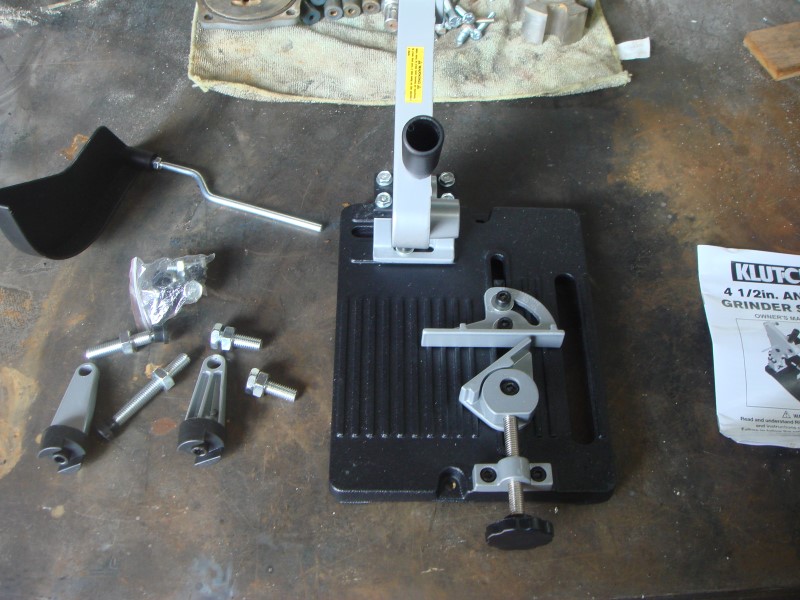

Not bad. Showed up today, and is a mix of cast iron and aluminum. The iron base gives it enough weight that it sits on a bench without wanting to fall over at the slightest touch. The vise jaws are kinda short, but that is needed to give good clearance. Lots of adjustments, so I would imagine almost any grinder can be mounted, as long as it has threaded holes for side handles. It came with 10mm bolts which fit Hitachi and others, along with 8mm for DeWalt and others, and 6mm for ?. If you have a really old made in the USA grinder, you might have to supply your own USS/SAE bolts. The fit of most parts are sloppy, but that is both good and bad. With some tweaking you should be able to get it adjusted to cut true with almost any grinder, even if things are not all machined square. I have yet to use a square and indicator to make any fine adjustments, and just eyeballed it for now, but I can see that there is plenty of room to get it all dialed in. The added guard is just plastic, so I didn't bother to use it. Maybe I'll make a metal one if I fit a larger blade. I think a 5" or 6" blade will make it a lot more useful, if this grinder has enough power to drive it. One thing is that I thought that once it was setup, you could remove and replace the grinder for hand use. Well, if you do, you will lose some of your setup. So I think it's best to dedicate a grinder to this. Overall I'm happy with it. I'll have to see how handy it is over time.

Like I mentioned, grinder is dedicated and not coming off. The HF grinder used 8mm and also they do give you plastic filler plugs too. Not unhappy. Gonna try it tomorrow. And the vise is short like you say, but figure the wheels will shrink up fast no probably not a big deal unless it affects angles.
I left the guard on the grinder and did not use the plastic (if you are lucky) deflector that came with if :D
