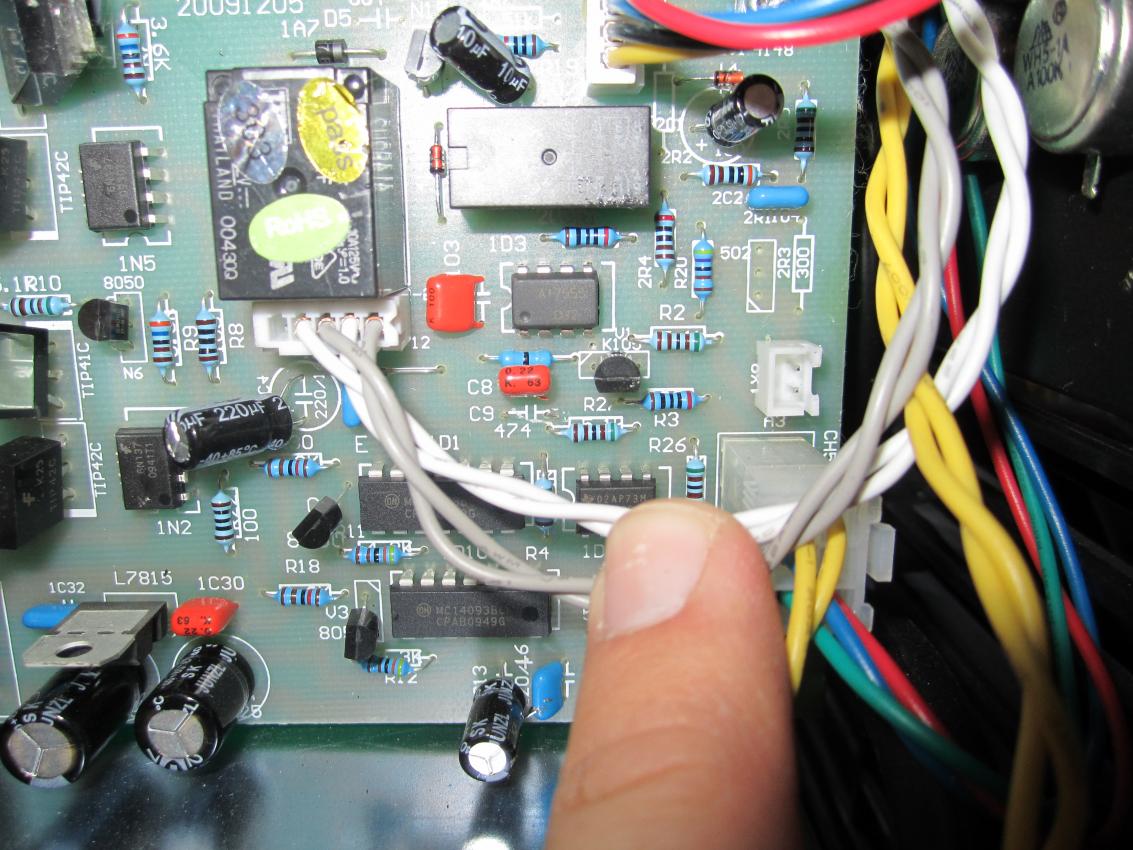

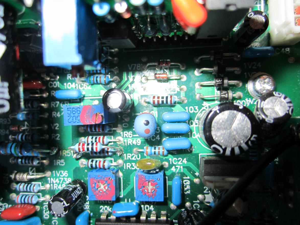

If you get a chance... next time you have the cover off shoot me an e-mail (btp -> s16v.com) or call me (two five three 951-4712). There are three places inside my unit where components have been cut or are missing, so I'd like to compare.
Diode V55 here on the main board up top:
http://s16v.com/photos/2011/01-29/P1...oken-diode.JPG
1K resistor (next to diode V79) on the main board up top, near the front:
http://s16v.com/photos/2011/01-29/P1...n-resistor.JPG
Capacitor C9 on vertical board mounted near front on left side (when looking at front panel):
http://s16v.com/photos/2011/01-29/P1...-capacitor.JPG
Thanks.
Bradley
Sorry for the delay Bradley, but I replaced my rear cover today and checked my unit against the pics you provided. In each of the three locations, I had the same modifications. My unit functions perfectly now, so if you still have any issues it is not because of these particular mods. ;)Attachment 1206Attachment 1207Attachment 1208

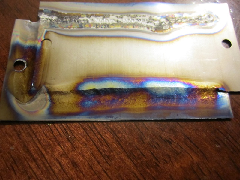

To illistrate how well the welder is working, here is 2 titanium coupons, .015" thick autogenously lap welded together. I'm looking forward to getting a back purge set up to do the welds properly.Attachment 1209 I'm also looking forward to getting some titanium tig rod and making a custom Ti battery box for my old Kaw :cool:
