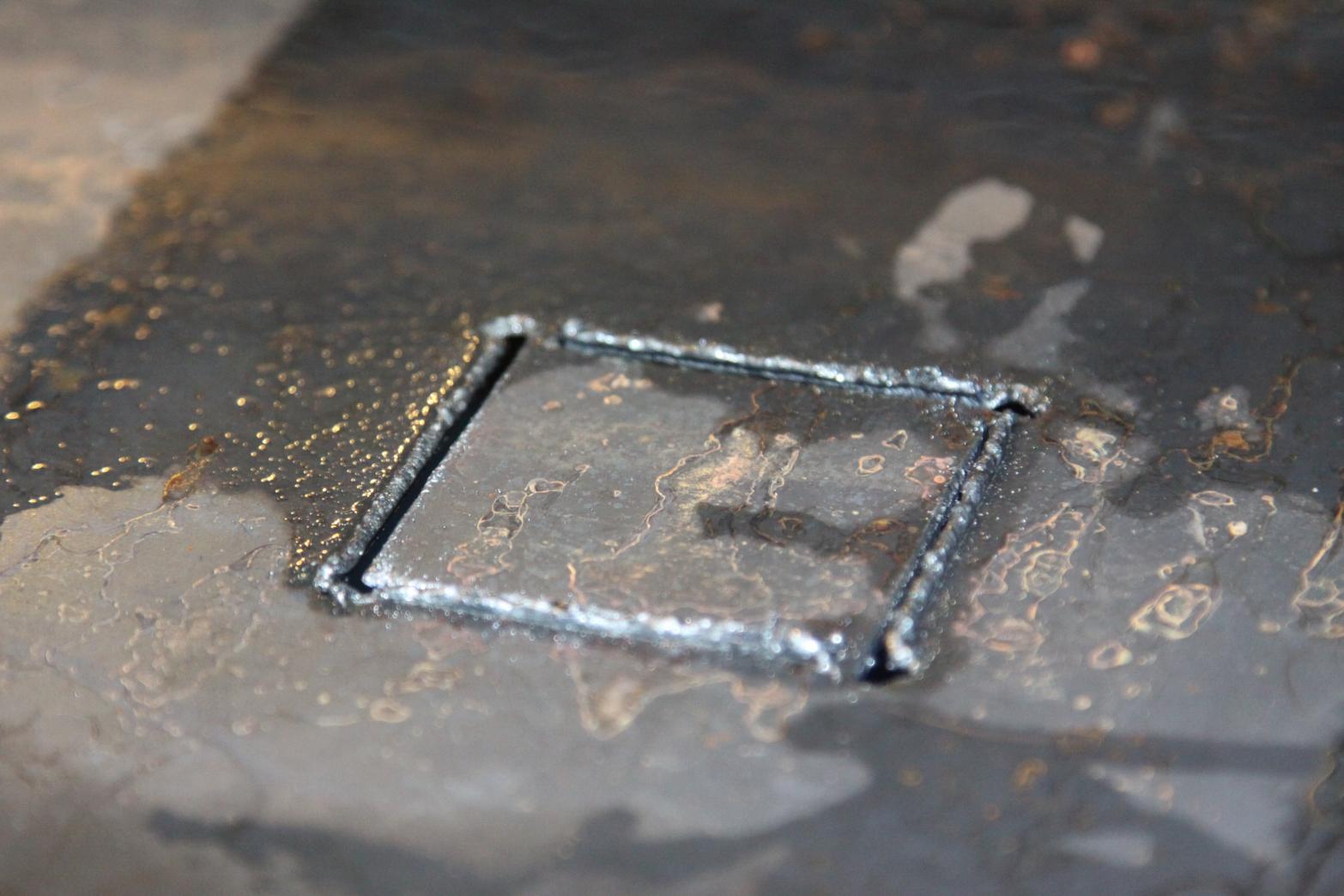

Because of all the problems, I stepped back and spent the day watching Mach and SheetCam videos and reading the manuals and just doing some testing to learn a little more about how the plasma cutter works.
I hadn't used the plasma enough to realize that I'd loose arc at about 1/4" above the metal. (I had always been dragging or using the standoff when cutting.)
At a minimum, some of the issues I found were:
- pierce and cutting height too high (causing the arc to go out)
- not really understanding Mach's coordinate systems and how to use it
- Spindle delay was on which added to pierce delay
After reinstalling Mach and Sheetcam, I was able to successfully cut a 1" circle. I still have to tune my settings (Ram - your straight line method with different speeds is a great idea).
Mach seems to have very little documentation on using plasma. It was only a side comment in one of the videos that said "THC On" actually is the "Arc Good" input. So, I've configured that - but it doesn't seem to stop the motors if the arc goes off. Does the "THC" feature have to be turned on?
Given how such a small gap can cause loss of arc - I can see why it may not be practical to cut thin metal without a THC.
