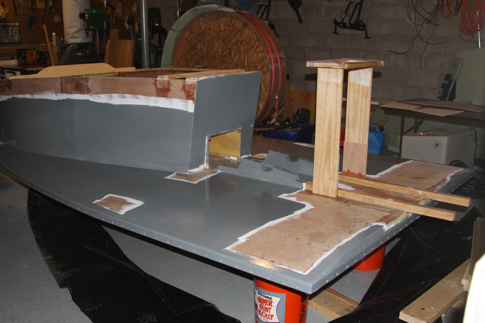

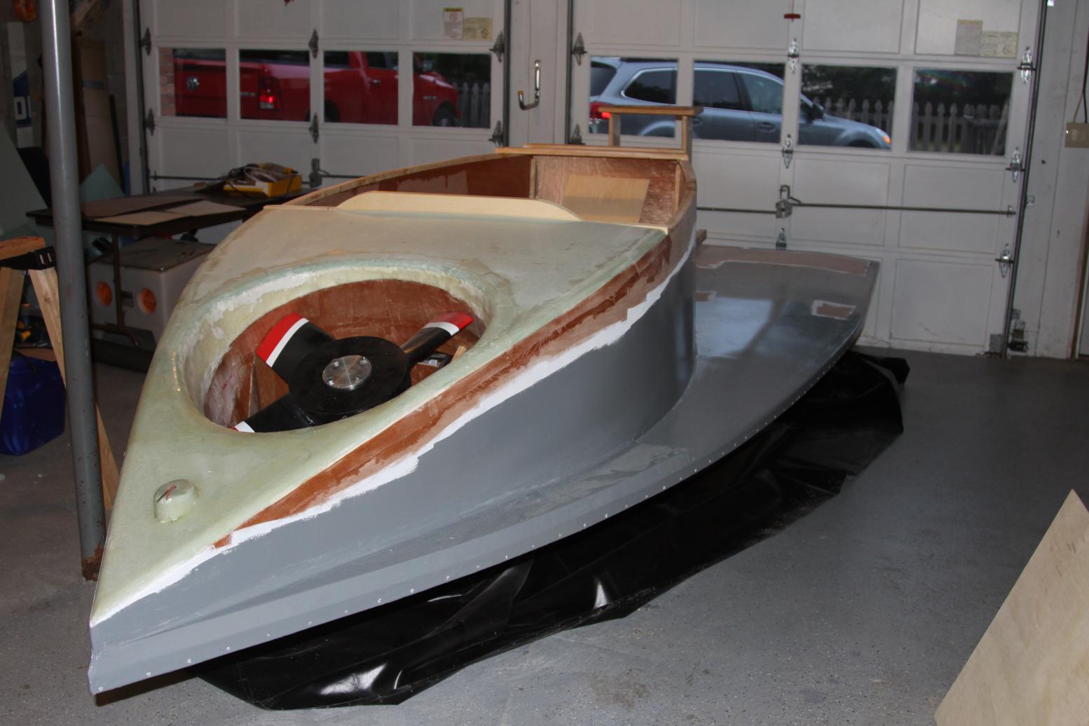

It does have a muffler. Originally, the engine was mounted per the plans with the muffler facing forward. However, my muffler goes lower than the engine mount. Because of that - I had to increase the forward up angle of the engine so the belt didn't hit the muffler. As a result of the up angle, I had issues with the rear/drive belt coming off.
My last mod was to rotate the engine 90 degrees and remove the added up-angle on the engine. One of the problems with the current mount is that the output of the tailpipe is only 8" from the base of the lift duct. In the last test (probably only 15 or 20 minutes of running), the heat of the exhaust gas cracked the fiberglass on the duct.
I need to figure out how to divert the exhaust. The problems I have are two-fold:
- finding the right diameter and type of pipe to use
- getting a bend in it with a radius that will fit the space I have (both how to get the bend done, and how to get it to fit)
The exhaust ID is around 1 1/4" and the OD is around 1 3/8".
Attachment 7449Attachment 7450
Any suggestions would be appreciated.
