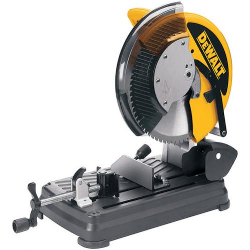

I was going by the UPS label. But then in another spot it stated, 47 pounds. Did come with ALOT of extra cardboard reinforcement.

Maybe I'll try it on that piece of Scrap from the Metal shop. Try to square up the ends.
I am starting to use it to make my cart. Currently working on the Lower Frame. Seems OK. Dewalt gave me a used blade. Didn't have the print on the side. Throwing Sparks and Metal. I would recommend an Apron/Work coat, Hearing protection. Face Shield. Loud. About as loud as a Chop Saw for wood. Maybe a little louder. Have to use a Square to get my angles correct. The supplied gauge has some play in it.
Sounds like you might have gotten a dull blade. The carbide tips are wider than the blade disc, so if used properly, there should be little to no rubbing on the sides of the blade. Mine has a few hundred cuts and pretty much has all the blade printing intact. Also very few sparks, almost none when it was new, but a few now that the blade is slightly worn. For sure it does throw hot metal chips. Here is a comparison between a dry cut and an abrasive saw on 1" x .120" wall square tube.
http://youtu.be/t9417R4QztE
Its not throwing like the abrasive one. Little more than the carbon blade. I contacted Dewalt. Waiting for their response.
A reman really should come with a new blade. Especially considering the cost of those blades.
I forgot to Warn. It will "Kick back" small pieces. Had to chase down a few that was thrown behind the machine. Fortunately I had open space behind where I was cutting.
Mine has a deflector that swivels up and down slightly. Sits mostly behind the blade. Easy fix.

Finally heard back from Dewalt. Your going to Love this answer. Copied and Pasted from the e-mail.
Hi Chris,
Thank you for contacting us.
I am sorry you are having trouble with your blade. Most of the retailers do not include a blade with the refurbished units. Your best bet would be checking with the retailer to see if they list the blade as included.

Refurbs are usually only supported by the seller, not the original manufacturer. See what Tyler says, then decide about return, bite the bullet for a new blade, or live with what you have.
Jake here has recommended a refurb dealer called Big Sky Tools, that has been great. I've bought a few things from them and been very happy. They grade their refurbs, A B C, so you know what to expect. I got a few refurb 4.5" grinders that would totally pass for new.
Last refurbished tool I bought was from the Makita Repair Center. And they supplied me with a New blade.
Monica said She'll send me another blade as a Courtesy.
At least now I will have a Spare. These can be sharpened if I am not mistaken.
