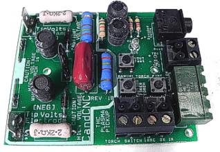

if i want thc i am just buying the RAV-01 Raw Arc Volts Voltage Divider Card its only 42 dollars and tossing the one in my plasma would be easy to change since the everlast card has the pin connection labeled on the board . also checked out the DIGITAL CURRENT PROBE DCP-01 neat so you can see exact voltageAttachment 6635Attachment 6636 also hers a pdf on these things nice instructions http://www.candcnc.com/PDF/DTHCII-se...stall-full.pdf

burntable wanted his arc divider set a 20:1 and the cnc board in the everlast only is 1:16 or 1:50 choices
Burntables didn't want me to do anything other than tap into the torch (+) with a 100K resistor, and the torch (-). I don't want to do any internal modifications if I can avoid it (might be different if it was not a brand new machine).
The Arc-OK should work, but doesn't seem to when I try to use the THC, but since the THC doesn't work at all, I want to get the THC functioning before I worry about the Arc-OK (because it may start working)
Why not ohm out from the torch - 100K pit to the end of the two 100Ks and when you get a short, that is the negative one. Then make a clip in jumper and jumper that one out. No real mods to the machine and gives them + with 100K and minus without. We are 1:16 and 1:50, some mod will have to happen to get 1:20 either way.
for under 50 bucks i would just get the rav-01 card , but i would get matching connecter so you don't have to cut of the plasma cutter original connecters. then you would have more arc voltage settings . been searching the internet all the cnc sites and find a lot of guys have bought this card since there original card would not work , that what i am doing when i do my plasma cnc table . what would help us a lot if everlast would post the inside welders wiring schematics like most usa welders do so you know were all the pin outs are and were the wires lead to instead of having to rip the welder apart to see were connection start and end . just like my plasma the wires come out of card and then go under main circuit board so you can not see were they go and connect sorta stupid to me . trying to get my buddy that builds and dose electronics to come over and use his pin out test , its cool has all sorts of connecters that match plug the has a break out board to back ohm meter to see were they connect , will ask him how a divider card works he mite know hot to convert it to 1:20

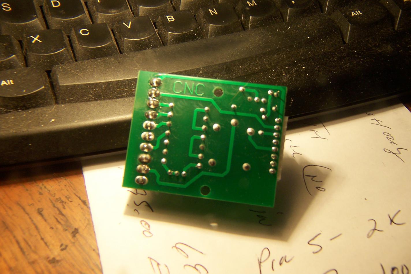

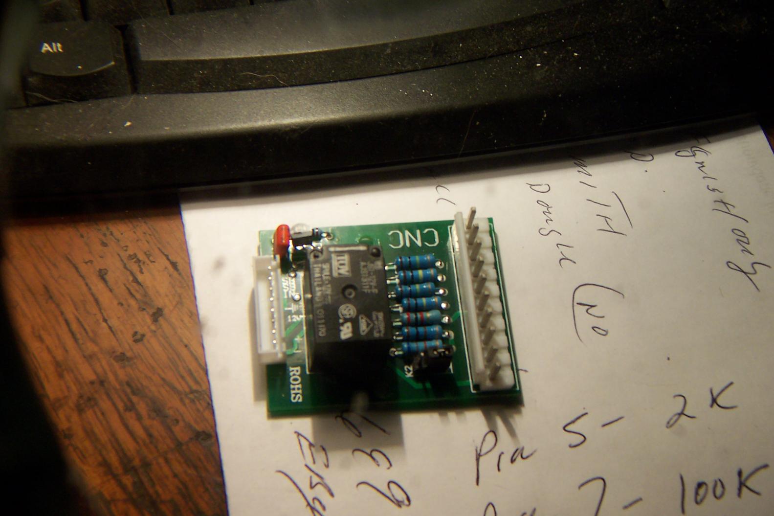

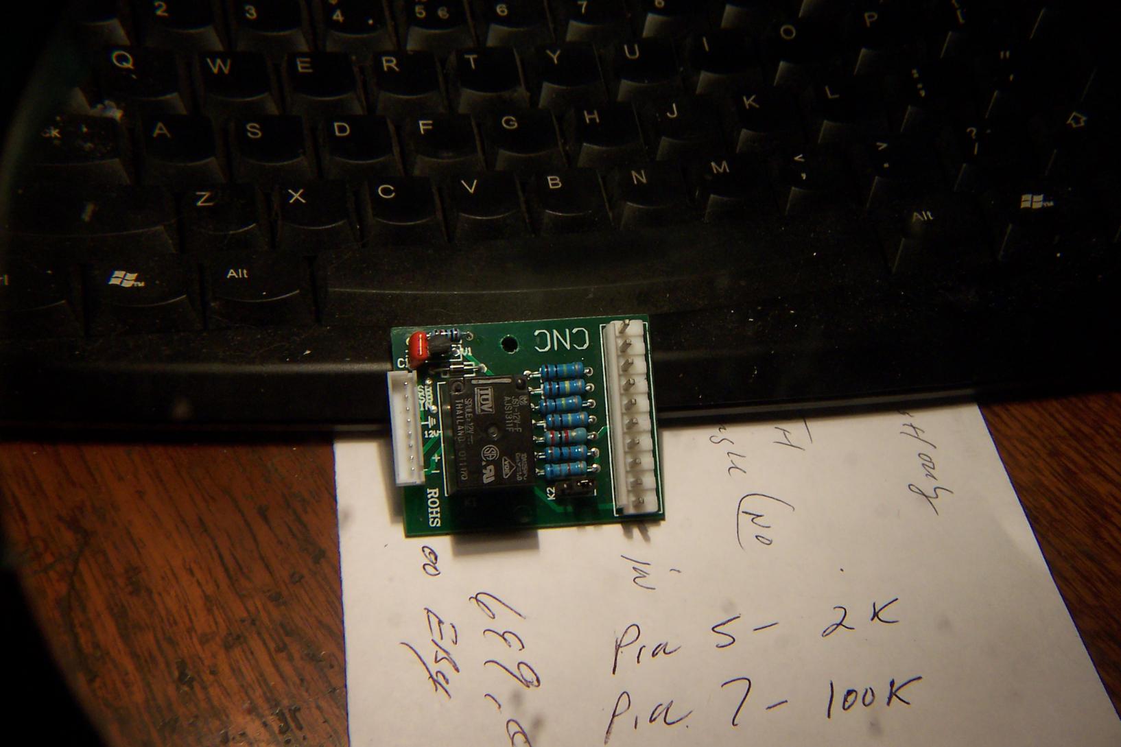

Attachment 6644Attachment 6645Attachment 6646Attachment 6647I pulled my divider card and ran the resister color code , pin 5 is a 2 k resister not a 100 k and pin 7 is 100k resister so that pic of card is wrong . pin 5 resister is bands red -black -red - gold that 2k bet if you replaced the 2k with a 100k would solve your problem
Attachment 6648found out this diagram is wrong pulled my cnc arc divider card out of my everlast plasma cutter pin 5 is 2k instead of 100k but pin 7 is 100k its rite
If the two were reversed that would make his machine close to what the burntable people want in the first place. And the idea on the jumper would be shot in the foot as well if not 100K on both.
Rod, as I do not have this board and you do (well I have it, but I am not ripping my machine out of the rack and talking it apart). Maybe Ray can look or Oleg can mail me one. Rod can you ID the two resistors.
Better idea might be short them both out jumper clips (no mods to the machine that he is worried about) and add a 100K external to the control board line as needed?
Can you ID the resistor for 5 and 7.

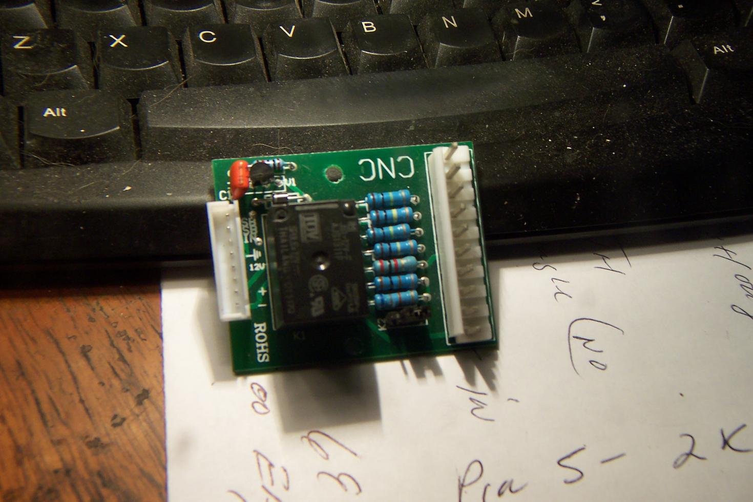

Attachment 6650pin 5 is a 2 k resister not a 100 k and pin 7 is 100k resister so that pic of card is wrong . pin 5 resister is bands red -black -red - gold that 2k bet if you replaced the 2k with a 100k would solve your problem on pin 5
never jumper a resister can short stuff out adding more resisters ok but removing can fry components in a circuit board since like the relay on board is tied into some of the resisters . i think if he takes the 2k and replaces it with a 100k would fix his problem
