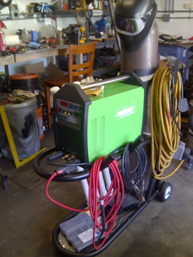

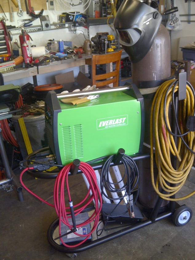

Where do you find these? That might fit well if you remove the lifting handle. Looks like it would be better suited for a table though. I envision consumables all over the floor when you go over a bump!

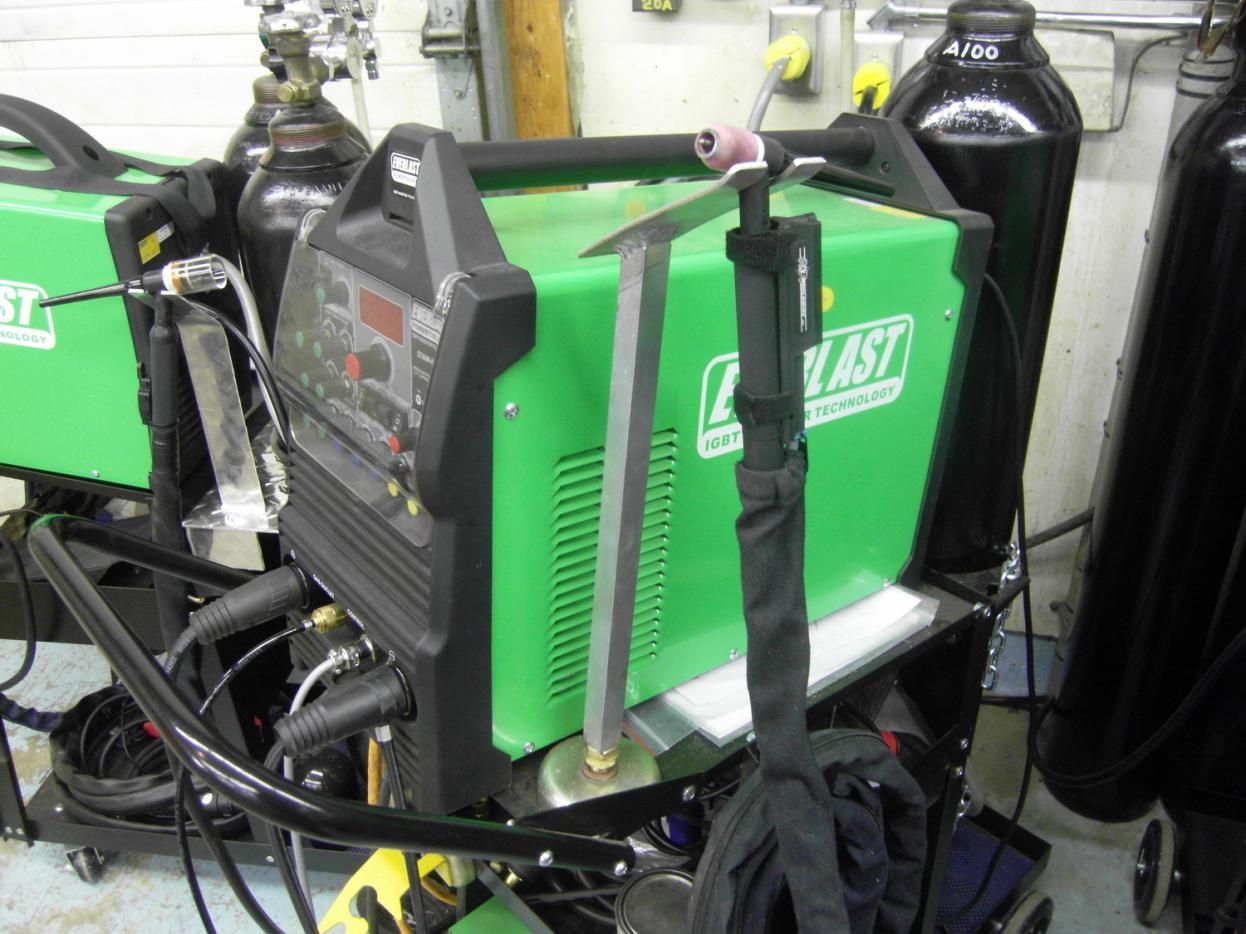

I have a different way of hanging my torch, a hanger that I made from 1/4" stainless stock and stainless sheet metal (scraps). The best part about having any type of hanger for your torch is that you can hang the torch up if you're done welding for the day and you don't have to wait for it to cool down. It can take an especially long time for the torches to cool if you have gotten them hot and they aren't water-cooled, and coiling a hot torch up probably isn't a good idea. If nothing else, you could create a meltdown. :O
It's funny you posted that magnetic torch and accessories holder. I was just remembering the fancy stainless sheet version that a Journeyman at my previous job made from scratch, using the Rotex punch to make all the needed holes in the base. I thought he was a genius, but now I see that he simply copied a store bought design. His version looked way cooler though.

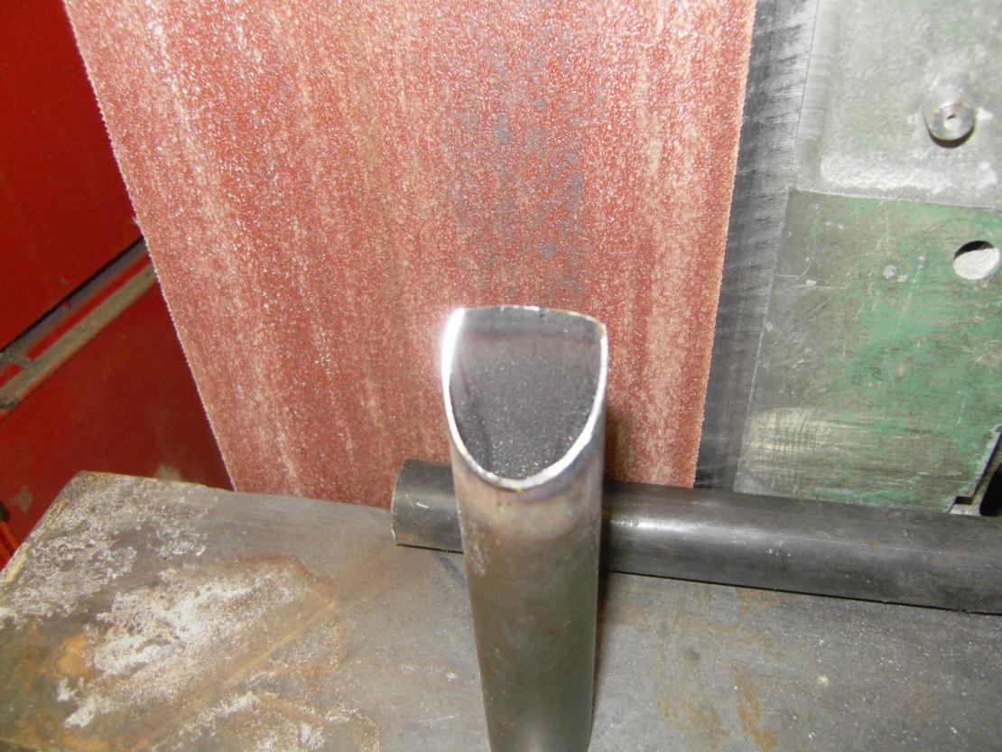

The chop saw I don't like but belt sander is what I use and works very well it is quick and you can do many angles fast.

I used a Sears 4X36 for years and yes I usually do tubes up to .125 in. wall and max. dia. of 2.50 in. if it is heaver I saw it close and then sand it.
I notice you are not using the miter guide. Do you do all these by eye? I move between things so much lately, I doubt I would ever get enough time to get a good eye for this anymore, and would resort to using the miter guide. I also had to hunt down an older cast iron 6x48 belt sander, to get what I wanted.

Thanks, Kempy. I stole your torch holder idea and fabbed one up today.
Attachment 10814
Attachment 10815
Glade to help and you did a very nice job on it. I find the ones you buy put a stress on the hose bending it over time and some times they are hard to get out with a long tungsten cap but they are only $10.00 at P.A. you can use the magnet mount.

T3t4 I see a lot of people use tube notcher’s but that’s OK if you are doing the same size tube a lot. I use 3/4”, 7/8”, 1.0” and 1 1/8” tubing a lot changing the cutter is a pain and clamping the tube that is why I use the belt sander all in one it notches any size tube.
