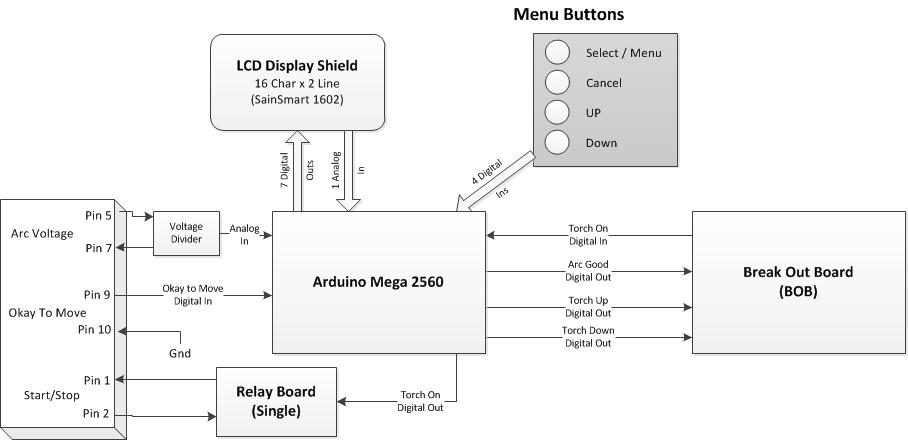

As time has gone on, I've found multiple posts about building an Arduino THC. They always have a lot of discussion and disagreement on voltage isolation and positive versus negative arc voltage.
Then, they always just end. I've yet to see a resolution.
I did some more testing with a scope. It reinforced the belief that the divided voltage coming out the CNC port is isolated. If you measure it, you get a reasonable positive voltage.
If you hook the ground of the scope to the ground clamp and the positive to the CNC port, you get a very dirty negative signal with voltages well out of the digital logic range. So, it looks like its bad to have earth ground connected to any logic circuit in the overall system (torch, Arduino, motor control). The PC is not an issue for the normal interface as I'm using an isolated BOB with seperate power supplies.
Since the Arduino runs on a wall wart with no ground, there shouldn't be an issue with ground loops between the Arduino and the CNC port.
I looked at the 5 volt supplies I have for my motor controllers. The chasis-A/C ground on that is indepenent of the negative signal. So, I think that it is isolated enough that it wouldn't cause the any problems. (I need to run that by my EE friend.) But, it probably wouldn't be a bad idea to put some opto isolators on the logic signals that go to and from the break out board.
I now have all the parts for an op-amp filter circuit. Once I figure out if optoisolators are necessary, I can get any final parts and do the electronics build.

I spent the day at an Analog Devices seminar. They presented isolators for a couple hours. They have some really cool stuff that could be used for this project - if I could solder fine pitch packages/surface mount - which I can't.
I run two power supplies on my Break Out Board so that it is truly isolated (it doesn't share a common power supply).

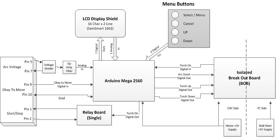

I realized that I could take one potential ground loop out of the picture by powering the Arduino from the 5 volt power supply that runs the motor side of the BOB and motor controllers (rather than its own supply).
The updated system diagram is below:
Attachment 7931
I haven't build the op amp circuit yet, but tonight I wired the Arduino to run off the motor's 5 volt supply and had it reading the torch voltage.
It was pretty noisy, but I didn't have the op-amp circuit yet and the filtering was pretty crude. But, it was reading the voltage, scaling it and then displaying it.
At this point I feel pretty sure that this hardware configuration will work from an isolation viewpoint, which was my biggest concern. I just need to start working on the filtering to get a decent reading.
Sounds great. I really like the approach you are taking with this.
I think you are going in the right direction! I like that you are using the full arc voltage instead of the divided arc voltage. I'm sure there is a very good reason why one would use divided arc voltage for THC. Using the full arc voltage will allow anyone with any plasma cutter to use your THC. I also like that you are developing the OK to move as well. My setup does not use the OK to move, and I know other people have had to jump the OK to move pins to work. This could potentially open up the cnc plasma market for all plasma cutters to have a THC ability.
I haven't looked at the okay to move pins yet. Have you heard of any problems with them on the PP50?
I didn't have any special plans for that yet, I just figured it would be cleaner to put all the signals through the Arduino. But the side benefit is that they are there if you need to do anything.
I had thought about putting the E Stop through it, but decided not to for now.

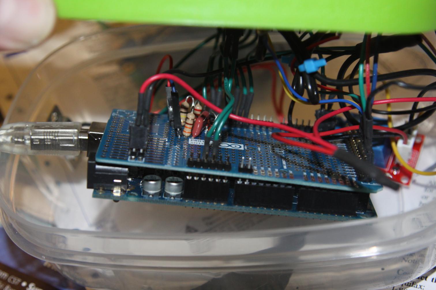

So I could test the software, I wired the buttons before I had an enclosure. I make the wires long, so now its a bit of a rats nest.

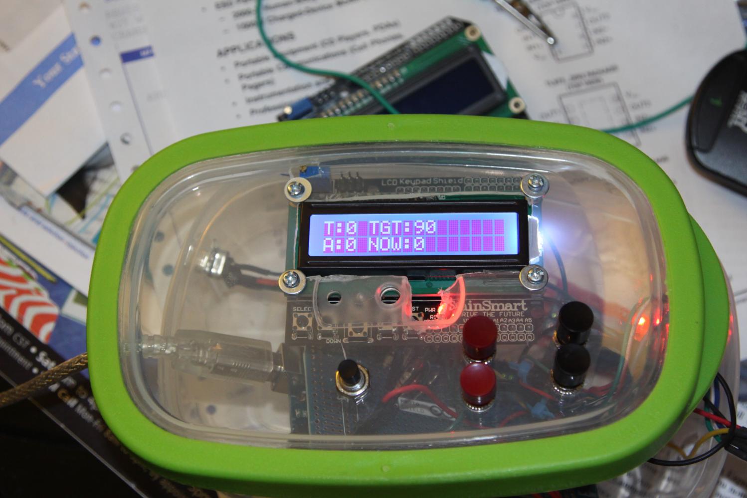

To prevent any issues with ground loops, I wanted to put the electronics in an insulated box. Project boxes are expensive and I didn't feel like making a wood enclosure for it. So I went to Walmart and bought a cheap plastic food container. They didn't have much to choose from and I ended up having to get one with a vent in the middle. (The hole in the lid.)
Attachment 8141

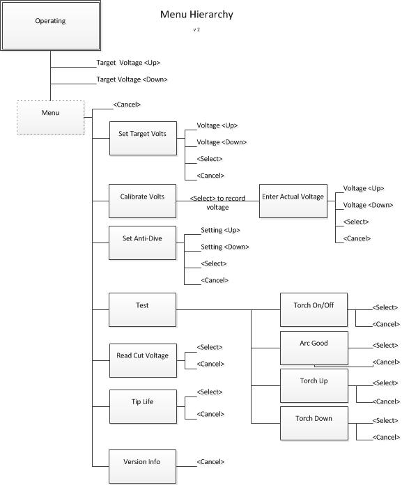

The single push button on the left is to set the mode (disabled, run, manual torch moves). I haven't wired it yet because its a late addition.
The two red buttons are for voltage up and voltage down. They will also allow moving up and down through the menuing system.
The black buttons on the right are for the menuing system and are "Menu/Select" and "Cancel".

Attachment 8142
The box has a DB-9 at each side. One goes to the CNC port and the other goes to the motor control. Since I knew I'd have to work on it, all the wiring connects to the board with plugs that go on header pins.
I had to change the LCD display mounting. It usually mounts on top of the Mega board, but I wanted the proto board there. So, I made a couple "extension cords" that all them to be separated.
Looks pretty good to me. I use containers line that for all sorts of things. No sense in trying to make everything neat and tidy when you are 99% sure you are going to want to add in another feature or change something.
All it needs is for you to break out the sharpie and label it :-)

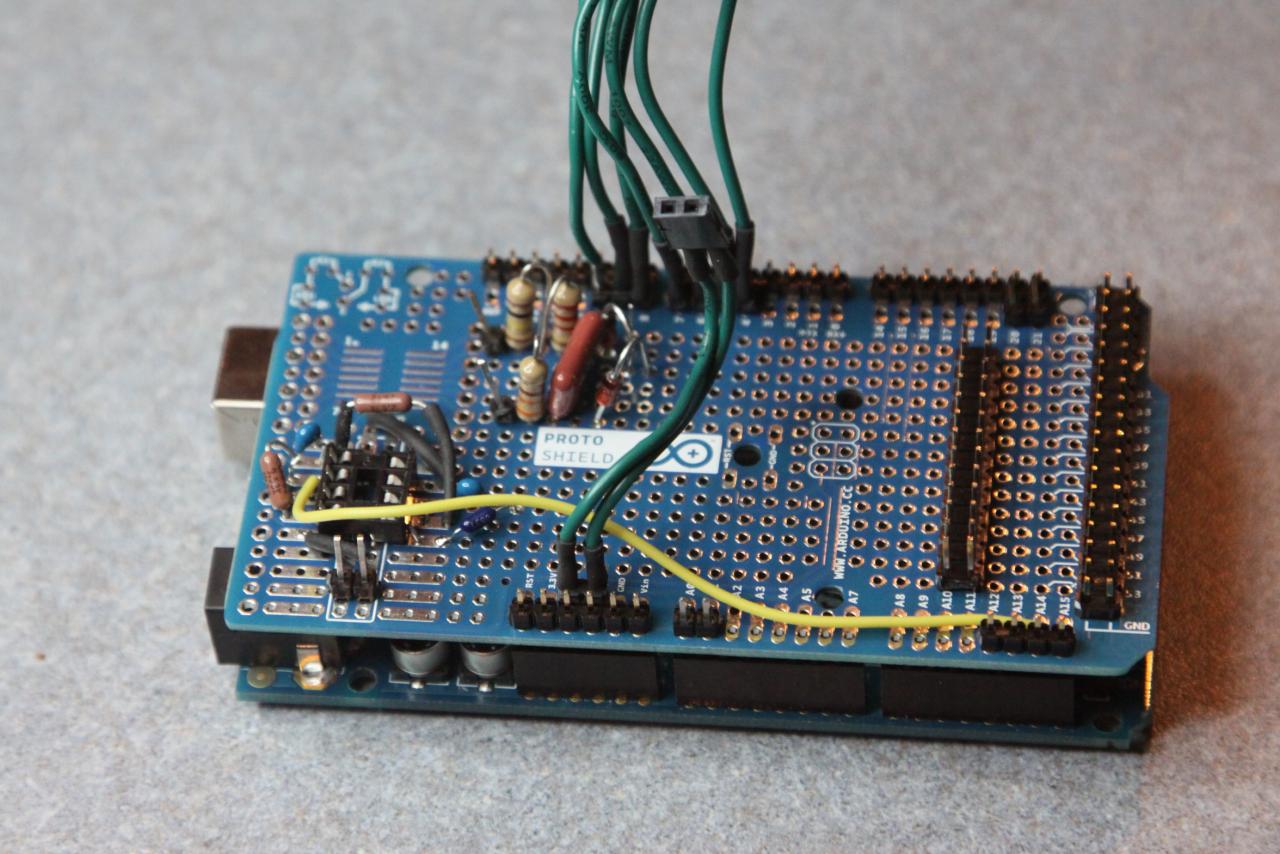

I've just finished wiring the op amp circuit. It is a 1:1 amp circuit (no amplication), but should filter out any frequency over 100 Hz. Hopefully, that will deal with the noise.
I've check the wiring tomorrow and add a couple resistors on some signal lines. I started "cleaning up" the software last night, so once that's finsihed, I can load it up and see how well it does.
Attachment 8220
On the upper half of the board, the components to the left of center is the voltage divider with filter cap and zener diode overvoltage protection.
On the bottom left corner is the op amp circuit.
The green wires are so the display can be mounted away from the proto board.

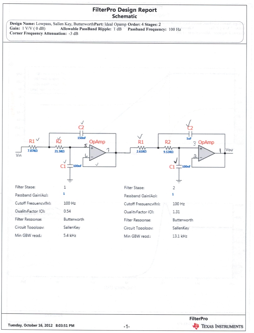

There's a great free program from TI. It's called "Filterpro". I used that with input from my "consultant" to come up with the op amp circuit. It's in the attached image.
Attachment 8261
It probably won't be until mid-week that I can get some help figuring out what I did wrong.

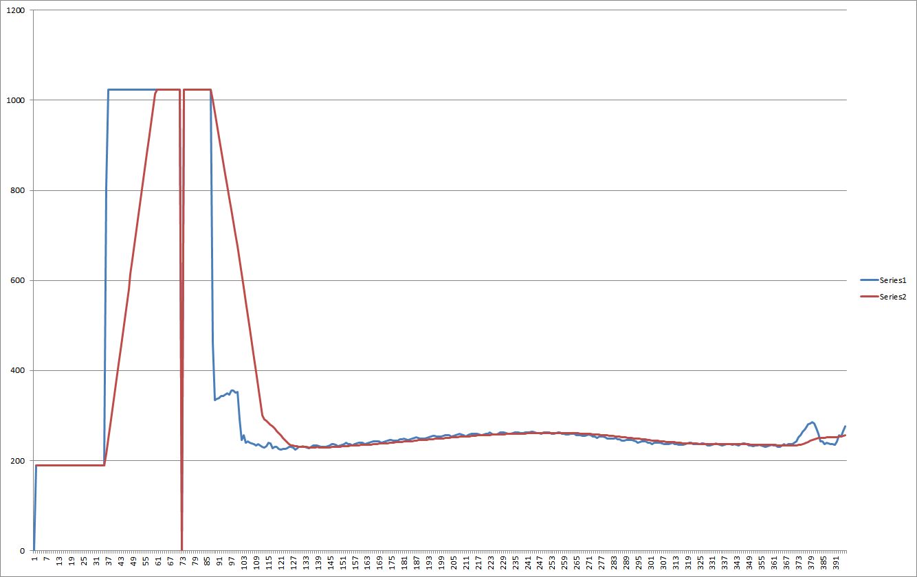

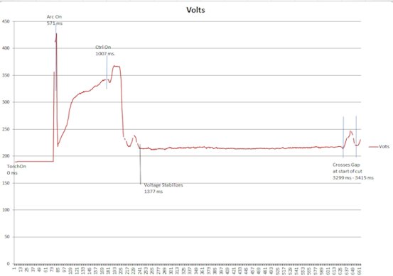

Attachment 8492
The blue line is the raw voltage as red from the A/D. It is in counts (it's a 10 bit A/D, so it ranges from 0 to 1023). The red trace is the value after software filtering.
I started capturing voltages when the torch on signal went active. I put a 0 value in when the software had waited 500 ms. after the "arc good" signal went active. The 500 ms. delay doesn't seem like long enough to wait before starting height control.
Using the 500 ms period as a reference, it works out to an average of a sample about every 7 ms.
The software was running pretty slow (I think due to the slower than normal serial library I was using). I expect I can easly ramp the sample rate up higher, though it seems to be doing pretty good at the current rate.
You can tell that the software averaging is too slow. I was doing a sliding window average over 25 samples, so that ends up being a 175 ms average. The voltage is clean enough that I can do a much shorter running average (maybe 3 samples or about 20 ms?).
The op amp filter circuit is filtering well, but I ran a circuit simulation and found that some of the wierd behavior I'm seeing is actually how the circuit works (at 0 V in you get about 1.3 V out and the output won't go higher than 3.7 volts). So, I'm just going to need to play with the voltage divider more to get the cutting voltage in the middle of the op amp's range.
I had taken a class on LTSpice (analog circuit simulator) and it helped me figure out parts of the voltage circuit I didn't understand. It turns out that the 100K resistor on each side of the torch voltage coming out of the CNC adapter reduce a signal in the 110 V range down to the 60 V range. I had though I was cutting at a much lower voltage than is normal, I now know its due to the CNC port resistors.

The X axis is the sample number. I think that the 73rd sample was at 500 ms, so I just divided 500 by 73 to get an average 7 ms. sample time. (Now, I'm not sure if that is exactly right, but I have some newer, better captures to analyze.

I'm not sure I understand why the voltage goes up and down as it does after the "Arc Good" signal. I'm guessing that "Arc Good" must come on when the pilot arc ignites so that Mach will start the pierce. But, it that's the case, would the pierce cause it to drop then rise like that?
The interesting thing is at the end. You can see where the torch crossed the kerf from the start of the cut. At 50 ipm the width of the kerf takes about 116 ms. to cross. That means it should be easy to implement "anti-dive" by looking for steep slopes on the voltage changes.
