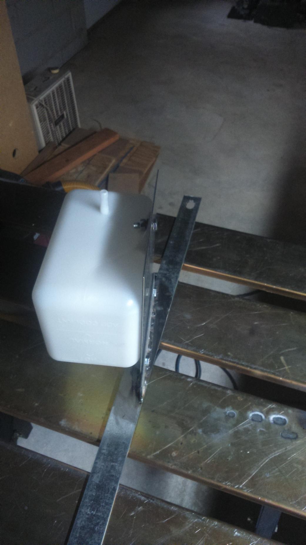

Rambozo, I did something between what you suggested and what I wanted to do. What I did was, Cut the 1/8" bar to fit underneath the Support Bar. Welded a short piece underneath at a slight angle. Drilled holes. The picture is the underside of the unit. Haven't test fitted it yet. I drilled slots in the ends just in case. And where the Bottle is mounted, I gave myself an extra inch. If I need to slide the bottle forward more to fit over the wheel well hump.

On a Hind thought, I Probably should have welded the plate to the rail. Left it loose to paint.

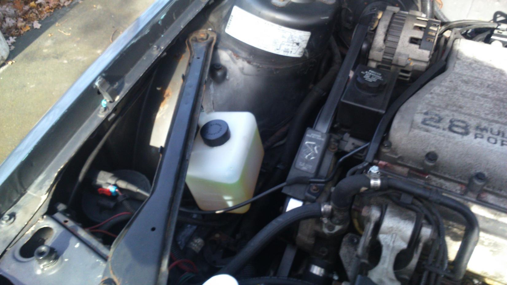

She Finally got the car back tonight. Tomorrow I am going to run over there and put the bottle in. I may have to wait to replace the Module and Coils.
