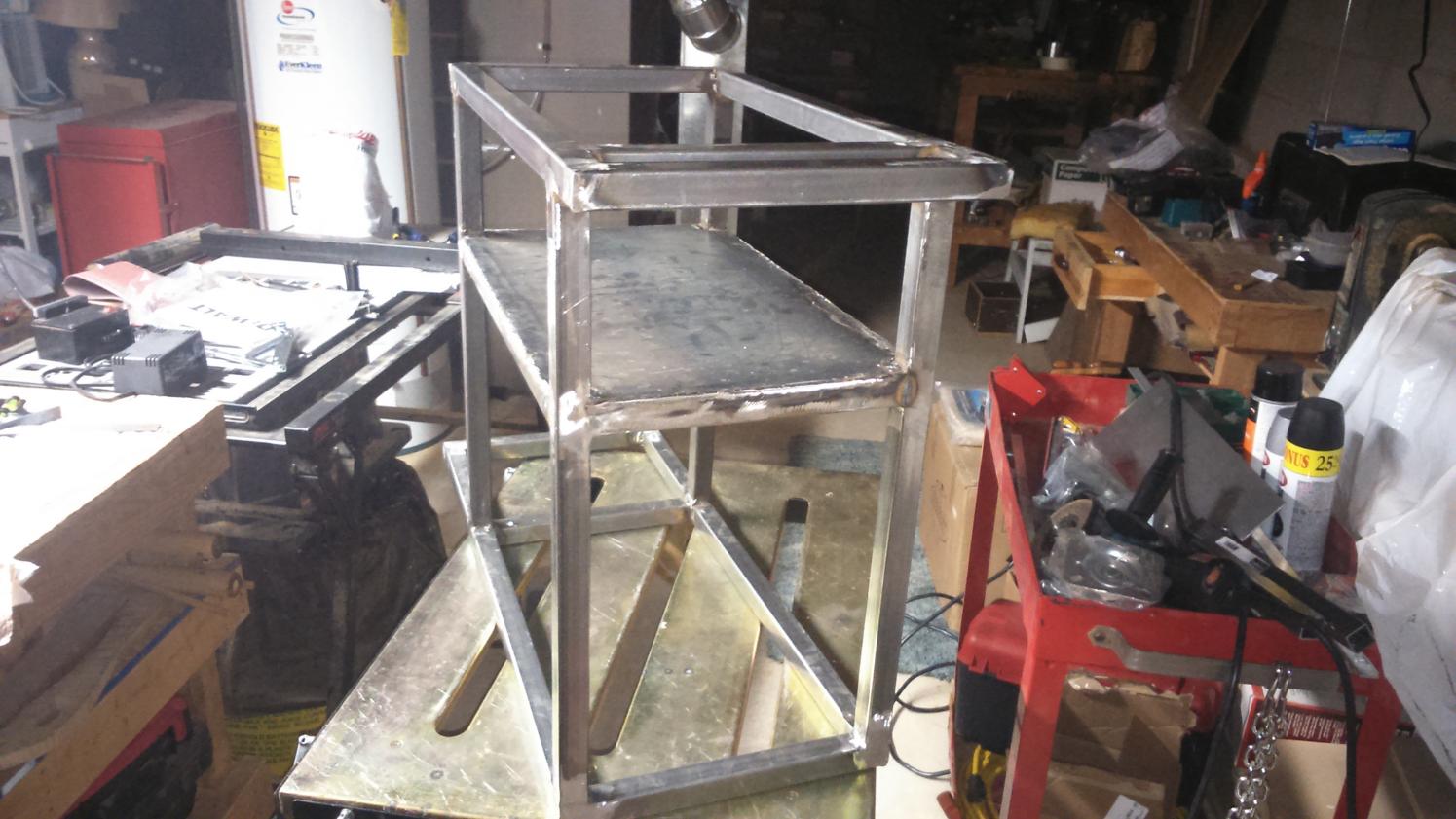

HD lied. It is actually 18 gauge. Too thin for what I need. I'm going to return it. I may just use my original idea of 16 Gauge shelves. Solid pieces
Attachment 12401Couldn't wait to start
Met the BeaveAttachment 12402. And this is where we are in the Project.

I am thinking that when I make the Top, I should use a Third bar. In the middle to help support the weight of the welder. I have enough scrap to make one more. What do you think?

I started welding on the Middle Shelf. Figured it would be easier to do this now. Tried doing a Spot Weld. I had the Blue spots on the backside of the Shelf. But not in the Tubing underneath. Just doing a Filet on the outside. Maybe on the inside as well when I am done.
That's what I meant. Problem was it wasn't going through the sheet metal. Even with the Volts all the way up.
To do a rosette weld, you have to start with a hole in the sheetmetal, drilled, punched, plasma cut, etc. Everlast has a pretty good example in one of their trailer hitch videos as I recall.
To do a spot weld or resistance weld, you typically use two contact electrodes and a different type of power supply.
Thanks. At least I get to practice some beads. The Self was slightly larger than the frame. Grinder will fix that.

All you needed was a few tack welds on that self to hold it in place.
It doesn't rattle. Today I added an additional support bar to the top shelf. Once I put the 16 gauge sheet metal on, Should be plenty strong for the weight of the welder. Even with the 8" Roll.
The Rosette Weld. What size hole should I drill in the sheet metal? 1/8"?

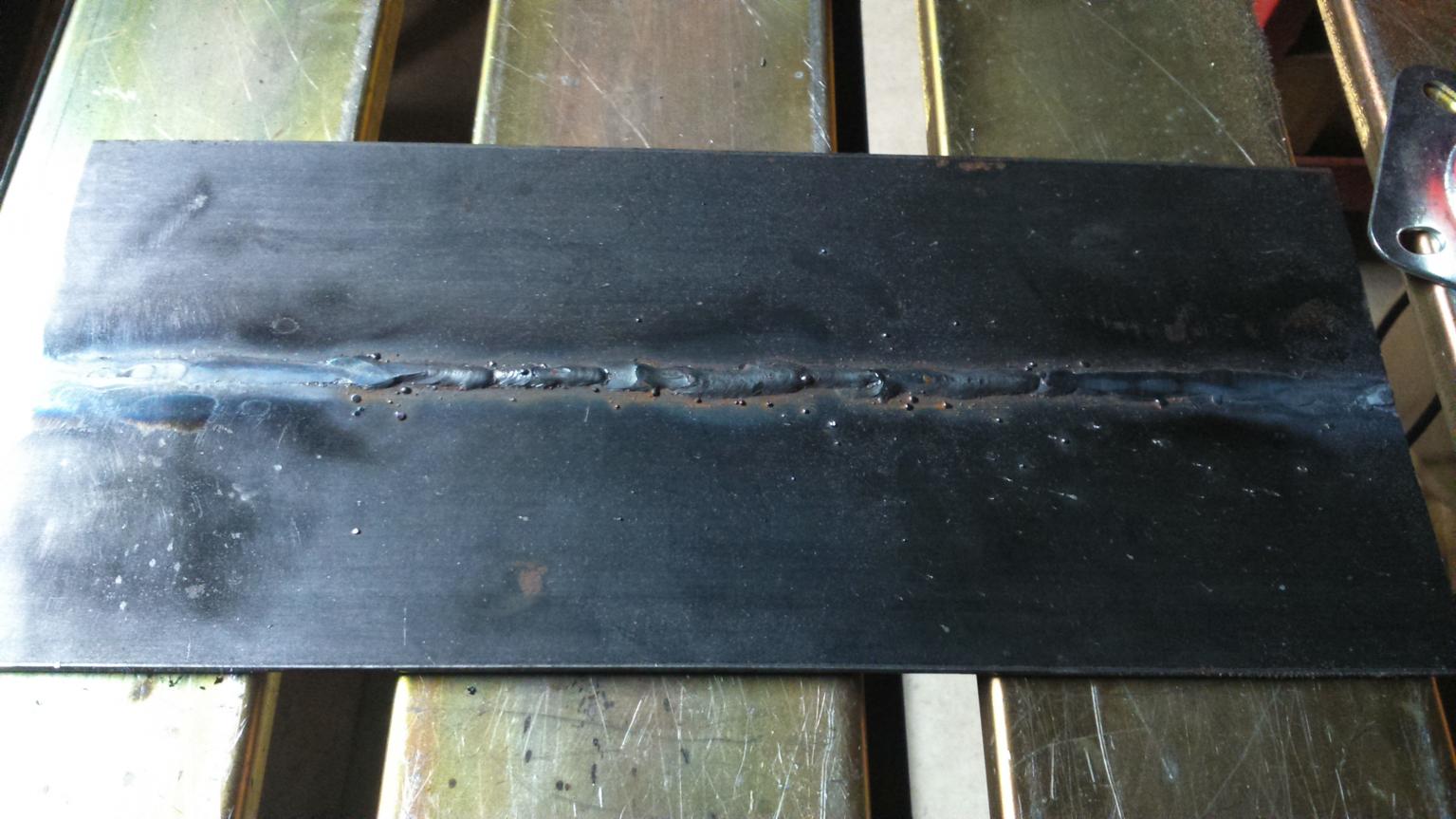

Just welded together two 3" wide pieces of 1/8" flat steel. Blasted the one side so hot, It warped the table a little. Flipped it over. Welded the other side. Polished the one side down. Today I was curious as to how well the weld is. Laid it across two pieces of plywood. And stood on it. The 1/8" plate bowed under my 140 Lbs. But the welds seem to hold. Attachment 12442Attachment 12443
