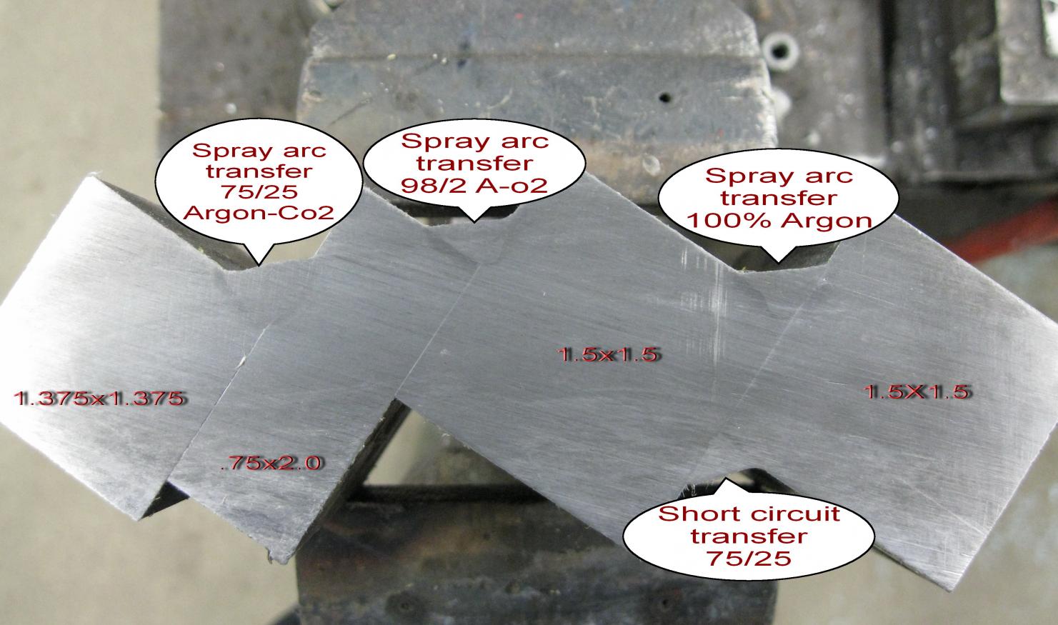

this is the test piece cut with the saw.

Yes, that is shallow...not as good as it should be with a mix...
It was 3/4" welded to 1 1/4" steel plate with no preheat or bevel cuts. I will try some mix gas I have 25% Co2 / 75% Argon in a small bottle.
kempy, certainly not a 'sloppy' weld. As I've said, I'm not a steel guy but there is nothing inferior about a weld that has that kind of root penetration. Root penetration is root penetration. The AWS doesn't say much about it because it's not easily measurable like the leg or face of a weld.
AWS D14.3-94, paragraph 2.3.1.1, reads as follows:“Design values based on depth of penetration or effective throat, or both, which are beyond the root of the joint shall only be used when the values have been determined from a significant number of cross-sectioned samples which reflect the range of materials, material thickness, and welding conditions.”
Imagine a spec'd 1" fillet weld - it wouldn't have any more 'root penetration' because that would be accomplished on the first pass at the root!
Of course, it is a 'good thing' to have adequate root penetration but not in the sacrifice of other things.

Test different gases. Used MTS250S in Mig mode not SYN/Mode all welds done with the steel cold using 98% Argon 2% o2 and 75% Argon 25% Co2 and 100% Argon. The eases to weld was the 2% o2 and 98% Argon all welds same settings except the Short circuit weld. The Spray Arc set to 25.5 Volts gas flow 12 LPM.
Attachment 12013Attachment 12014
The 75/25 showed the best penetration, but it is too much CO2 for proper spray. A little less and you won't see much difference in penetration but a lot smoother easier flow. The 98/2 even showed better penetration at the toes than pure argon. That's where a 90/10 or a 85/15 or even 82/18 (C18) would help out...and give better penetration with lower settings. The short arc is pitiful, but the lack of fusion is a result of making one heavy thick, gobby pass. This lesson can be carried over to aluminum as well by the way, not in the gas mix, but in the penetration and fusing at the root and at the toes...(short circuit versus spray)
