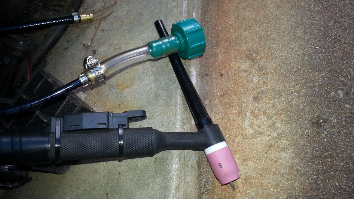

No, do not use it or you will melt it. Whoever told you it was good for 150 amps was wrong! Create a rudimentary cooling system with a water hose and some fittings. Talk about contamination.

On the water cooling, hook up the hose or tap to it, done it for too many years to count. Get a arc flow (as Mark would say) "about like a water fountain" and just drain it outside the shop or in a sink. See below.
Attachment 11252
There's a number of ways to adapt the torch. It doesn't take a lot of flow so you aren't wasting a lot of water.
Old school shops have done it this way for years. If you've ever walked into an old welding shop there's a water spigot right beside the refrigerator TIG sized welder, and a floor drain right next to it.
This isn't anything new...and works just fine...especially if you've got some flowers that need watering.
