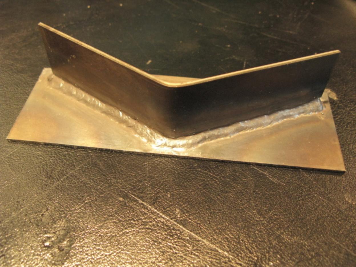

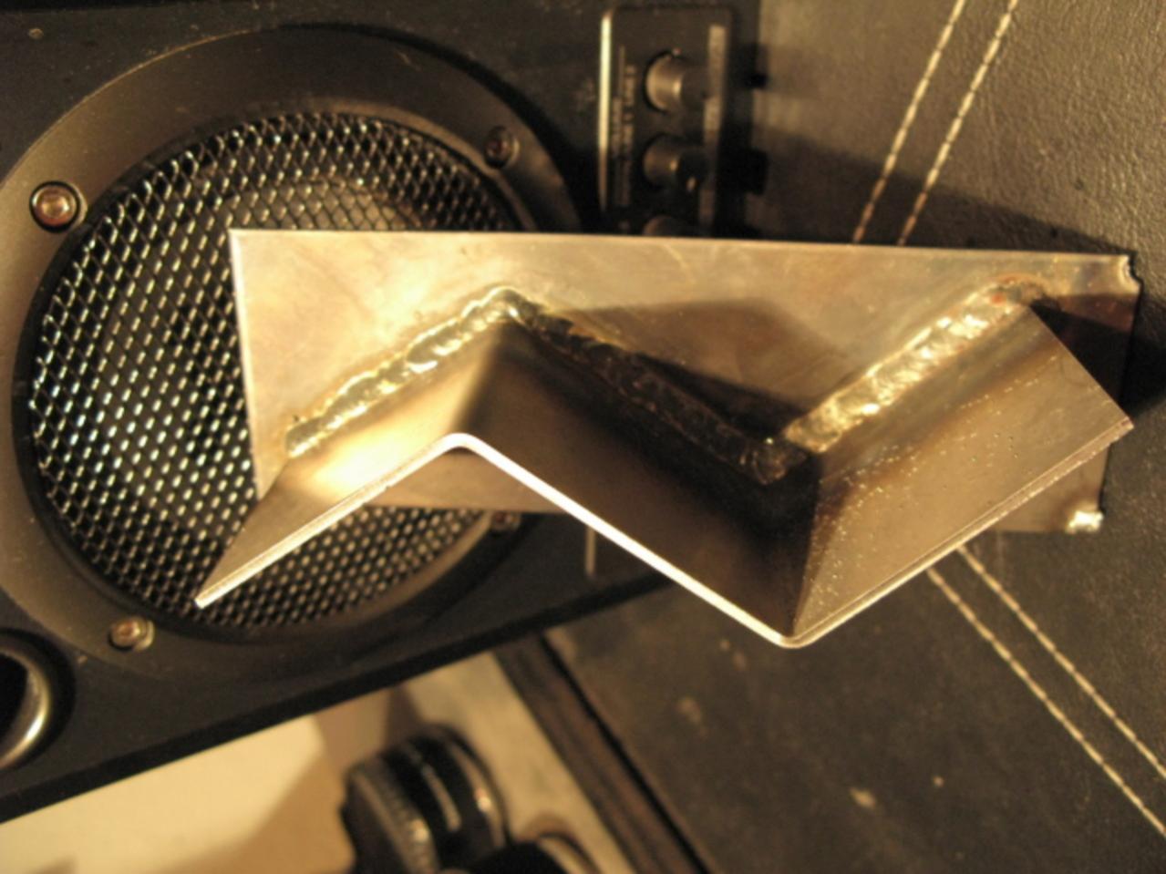

I have used both and for short cicuit trasfer I think it is 90% as good if not almost the same. Once you get to globular and spray transer 22 volts and up it starts having a spattery arc and argon fixes that. Here's some shots of a couple test plate I welder yesterday in class....both 100% CO2 Attachment 9214Attachment 9215Attachment 9216Attachment 9217
Geeez I need to learn to type! Anyway here is a Vertical down test I did today using 100% CO2. ALso just to not confuse anyone from my last post. You can't to spray x-fer with 100% co2. You need a mix of at least 75% argon, but that is still to low. 80% is the min starting point most use for spray x-fer and 92% makes the arc more stable an you can use less voltage and amps getting same results. Only problem with spray is the deep penitration and big puddle weld deposit rate, but on thick stuff it really kicks but.Attachment 9222Attachment 9223
A note about spray transfer. You actually need LESS than 20% CO2. A 75/25 mixture yields anything but satisfactory results with spray...too high of voltage requirement.
For the best test, you should do a vertical UP test since vertical downs are typically frowned upon unless you are "zipping" things together in a cheap trailer plant somewhere throwing together thin tubing...running it hot.
