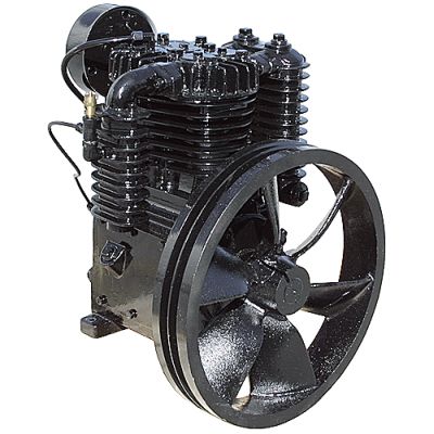

Rated at 25 CFM at 100 psi. no way that small pump would make that a Attachment 722925 cfm pump is huge
Very strange. It's obvious that it came with the 3ph motor and someone swapped the 1ph. The pulley sizes mean that thing is really running maxed out. Never a good thing for compressor life. Much better to have a big pump running slow than a small pump running fast.
