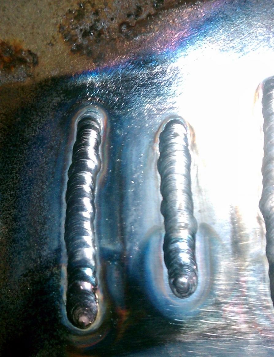

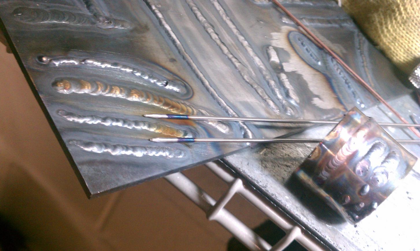

I found an old piece of 4130 that I used as practice material a while back and decided to lay a small bead next to it for comparison.........the bead on the left used a dynasty 200dx with footpedal...it was set to about 60 amps but I was probably only using half, and the two on the right were with the powertig I had it set to 40 amp.....just comparing the difference in how shiny they are...both used 70s-6 rod and red tungsten.
Also is if you look at the two tungstens (1/16) I did a very small bead then removed the tungsten and it had those haz/scorch marks on them (single bead after grinding).....is that normal for them to form that quickly and where they are?

Scorch marks are also a sign of lack of shielding gas, whether from flow, torch angle, cup size or gas contamination. The width of the beads suggest you are welding much hotter than with your dynasty...which is very possible. The Dynastys don't pack quite the punch of our inverters. I have a customer running Dynasty's side by side on a CNC welder with our 200DX's. The Dynasty is set at 120 amps, ours is around 98 amps. He sent a picture. He had a little shipping damage which we rectified as is visible in the picture, but here's your proof. Same CNC, Same duties, same everything, running simultaneously, but different welders.
Performance- whatever is causing the scorch marks on the tungsten, could that also be why I am having the slightly grey welds (if there isnt enough gas for the tungsten I doubt there is enough for the workpiece).
Yes you are right about the powertig penetrating more and being a little hotter than the dynasty as is evident by the penetration when viewed from the back side (I doubt my phone would capture it well enough).
Anyhow, with a fresh collet and tungsten and with varying the flow rate a good bit, what else can I try to remedy that situation? I am using a #7 cup already.......perhaps a different set of consumables altogether ?
I'd try using a number 5. Sometimes bigger isn't better. Go lower on your amps.There is a big difference in the weld you laid down on the dynasty and on the Everlast. Its about twice as hot from the looks of it.
performance- I will try that for sure, honestly with the dynasty I usually used the smallest cup I could find b/c I was doing tight corners, but I will try some smaller cups and report back.

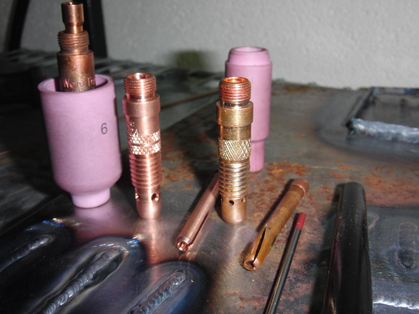

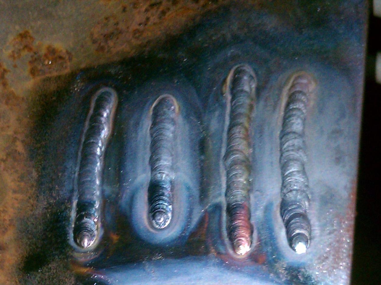

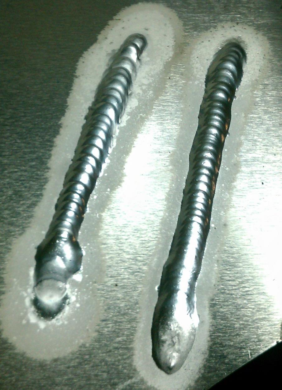

Hey everyone, I just thought i'd give an update after my week long beach vacation :)......I was going to get a new torch but thought i'd try a cheaper route first and picked up a new collet body and 2 collet's and #6 gas lens/cup all for $13 and got a new tank of argon......I am not sure exactly which made the difference, I am assuming the gas lens but my tungsten are no longer instantly contaminating or getting any HAZ/scorch marks and my welds are coming out more shiny like I was used to. In short if you have a local airgas or similar welding supply store I highly recommend getting a gas lens :). This is not to say my welds are perfect yet but it does help being able to see a difference....for instance I think I still need to slow down a little in the middle of the beads b/c it has a slight haze to it that I am assuming is due to lack of coverage (so either slow speeds or bigger nozzle needed?).

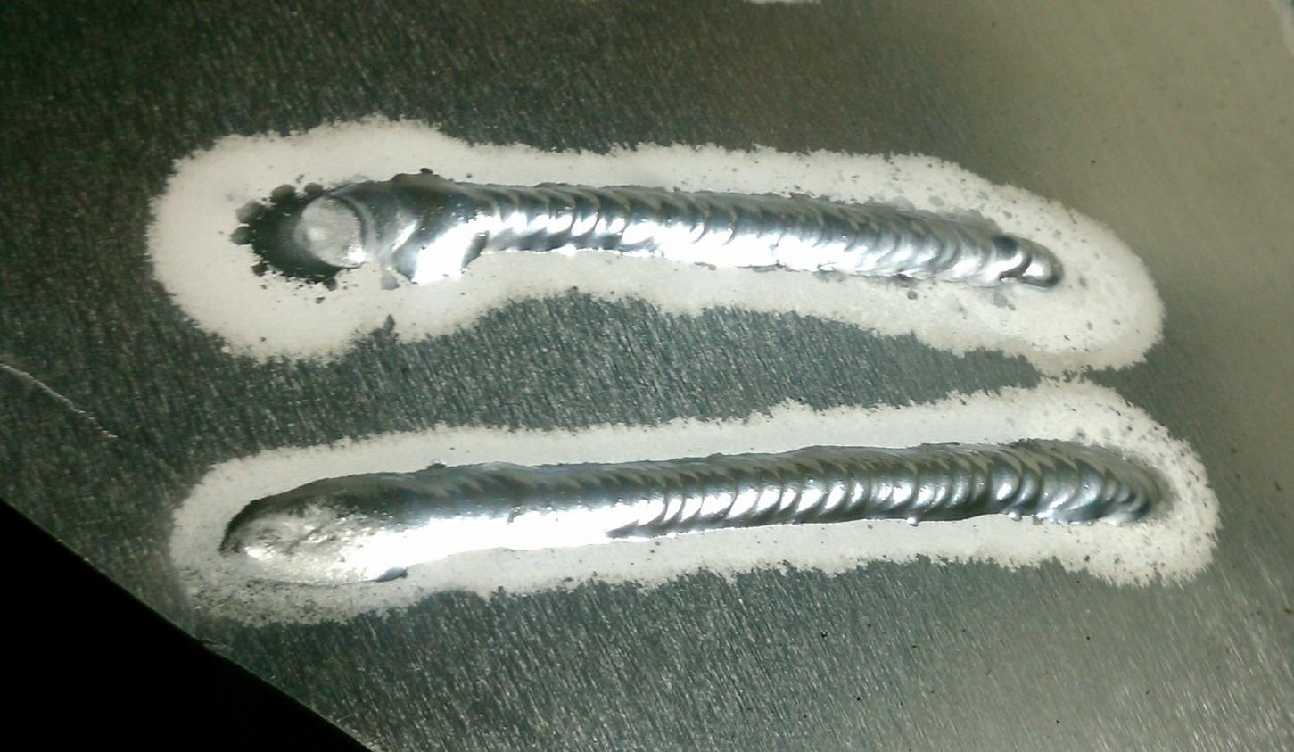

Also aluminum welds seem better and different....the machine doesnt seem to be getting as much penetration for the same amperage but is producing a much better bead with a lot more cleaning. Again these are by no means perfect and could probably have used a little more penetration but it is getting better :)

Ram48- Its no problem, that is what forums are for :). I did notice another difference that I forgot to mention, then weld puddle actually seems more stable....but I assume that is due to the lens making a uniform flow of shielding gas. The scorch marks on my tungsten used to be right at the tip of the collet body.....I compared the oem one with the weldcraft one I got at airgas and the weldcraft one has a slight different design and fits a little better.....I dont know that is what my problem was since I changed a few things but I think a collet and collet body are only like $1.50 each so it cant hurt to get a new one. Plus the oem I had deformed after a short run at 200 amps anyhow. Also with the gray welds try lowering the amps some and slowing down, that helps, but only once you solve your shielding gas problem. Lastly check for leaks....a while back I thought my hoses were tight but the one going into the machine would leak a little if you pushed on it and cause tons of porosity.....so make sure everything is tight :)

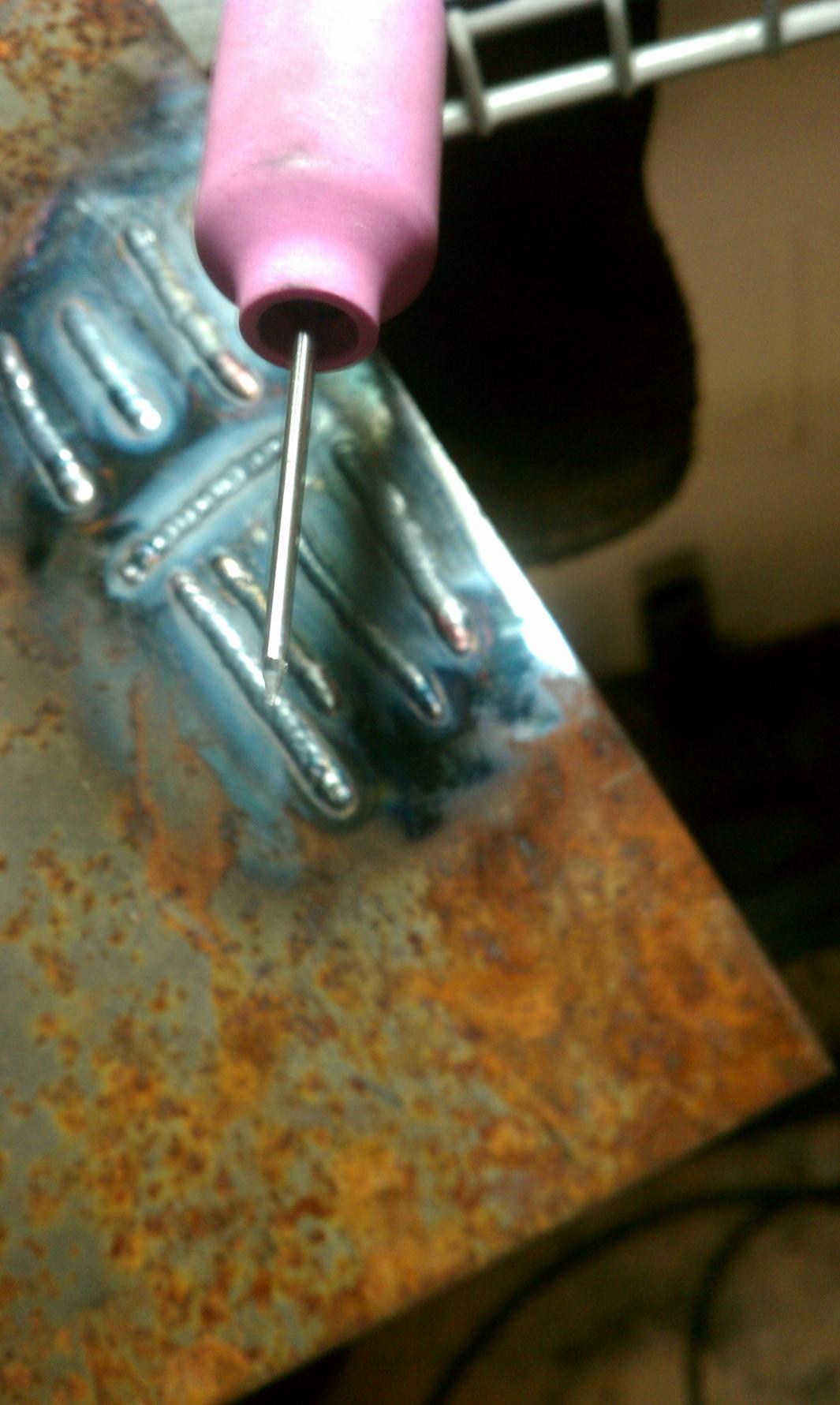

I decided to do a quick test on a rusty piece of steel I had laying around, I took a sander to it but no acetone. I did three tests....new collet and gas lens, old cup new collet body and collet, old cup old collet old collet body, respectively. Honestly, though there seemed to be some minor differences, I think the gas I had in combination with possibly poor torch control and possibly argon leaks were the culprits of my prior issues. Anyhow I hope to get some more pictures of a different type of weld (instead of just plate).... but I think torch angle/flow rate/cup size and good cleaning are the main things I will be concerning myself with for now.
btw the only significantly noticeable difference that I can visually tell between my tests is the gas lens provided better shielding at the end of the weld (hence little discoloration)(far left)

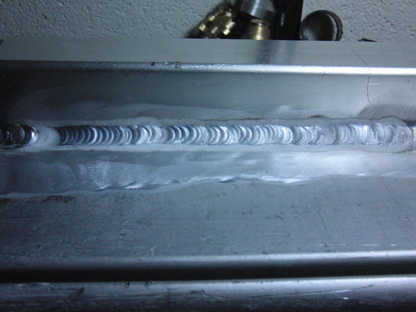

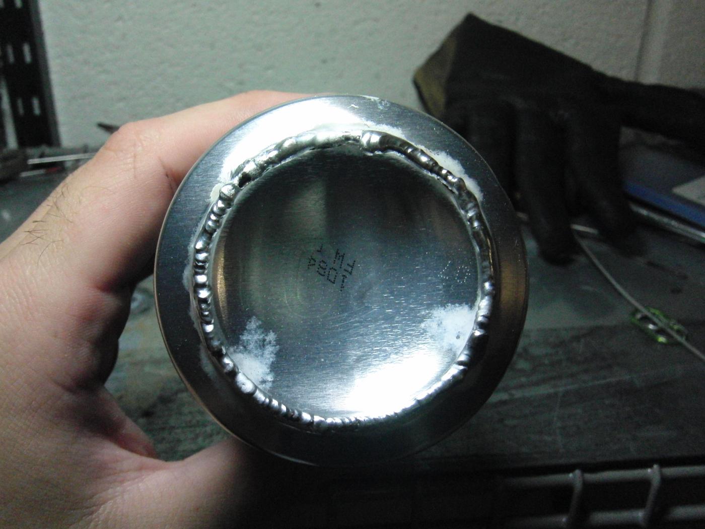

Just thought i'd post some pictures of a aluminum single step that I am making for my trailer. One thing I learned is that it is hard to maintain torch consistency when your hand is on fire lol....I suppose I could have taken a break though........but I was mostly doing 3" sections and then joining them, mainly b/c its hard to smoothly move my hand on my "work table" and I kept running out of filler and needed to adjust.
