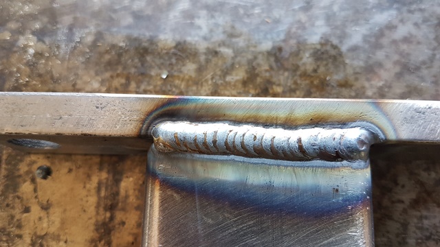

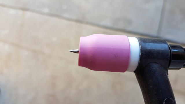

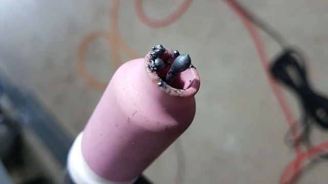

so when i received all the accessories, including gas lens, i happily and excitedly tried my 255ext for my project. i was so disappointed. the tungsten would flare and ball up after running 2-3inches of weld. i was only doing DC as i was welding mild steel. i even set the machine to DC easy setup. it's the same. the tungsten would ball up after 2 inches or a little bit more than that. i thought my settings were wrong so ok, let me put it to DC easy setup. and i was still experiencing the same. i had 10 2% lanthanated and 2 ceriated tungsten sharpened. i've used them all because all of them balled up. i even had to resharpen so i can continue troubleshooting.

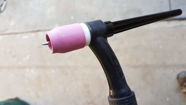

i doubled check all my dinse connections. i checked the gas. i even took a video of the flow meter to make sure the ball is going up and gas was flowing. but i know the gas was flowing because i'm welding 2-3 inches in length. the work clamp is connected to the + dinse connector and the tig torch is connected to - dinse connector. i also tried different torches. the CK torches i bought from weldfabulous and also the torches that came with the 255ext. i tried 17 and 9 torches. btw, i only tried 2.4mm electrodes,set up. tried different combination, still the tungsten was balling up. also, another thing i noticed was, sometimes the 2T was failing. i've already release my foot in the foot pedal and the arc won't die until i put the torch away from the material i was welding. here's another issue why i'm thinking the unit i have is faulty. i put the machine to 1 pulse per second. during the weld, the pulsing is almost not noticeable. at 1 pps, you should really notice and hear it. it's almost like a constant arc.

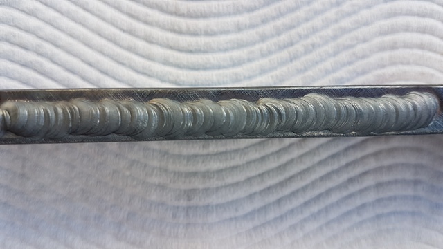

this time it improved. i would say big improvement specially using 17 torch. i can now weld around 6 inches before the tungsten flares up and balled up. but not with the 9 torch. with the #9 torch, it's still the same. roughly 1-2 inches into the weld and the tungsten would flare and ball up. btw, for dc easy setup, max amp is 90a. for my own setting, with 1 pps, maximum amperage was to 85. the #9 torch from CK is rated up to 125a.
