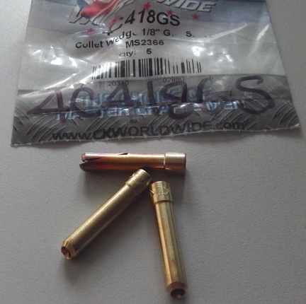

I’m willing to send two of these 1/8”, “4-series” wedge collets to the first Everlast forum member who posts to this thread or PMs me with a mailing address, on the North American continent of the so-called 48-state area, that also actually uses a stubby gas lens on a #17 TIG torch.
Of course, the wedge collets are far better than the slotted ones, which will twist or “cork-screw” very quickly.
These “4-series” will not work with a 2-series/#9 torch, either, I’m pretty sure, even though a 2-series cup will work with the stubby gas lens, on a 3-series #17 torch, that than will also will take a 4-series wedge collet. Ha, ha, ha… But it’s true, nonetheless.
Anyway, CK Worldwide packages these wedge collets in packs of 5, at a surprisingly good price per copy (about $20, I think it was, via Weldfabulous.) But I’ll undoubtedly never use 5 of them, as one or two would last me a few years, and I mostly only use 3/32” tungstens anyway. But I did recently have use for 1/8” tungsten on a higher amperage, so I got the pack of 5, which is really too many for me.
So, I’m keeping 3, and giving away 2.
Attachment 13662
You can see from this photo, how quickly 210 amps can corkscrew a typical collet. The wedge collets don’t do that.
