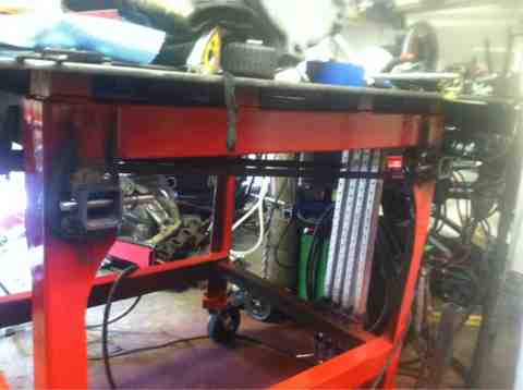

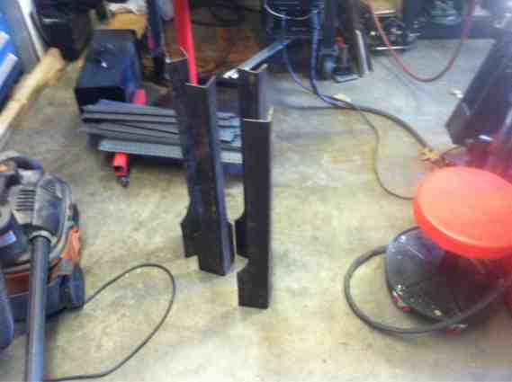

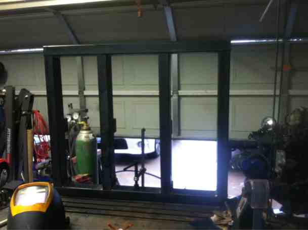

I decided to to a over haul on my welding table, right now it is 3'x6' and I'm gonna make it 3'x4' to gain some space back in the garage one section is 3/8" oiled and pickled plate the other part is a t-slot table from a big knee mill, I am going to incorporate the receiver style accessory ports and possibly cut slots in the plate like the jmr table. All I have done at this point is rough out the legs
Attachment 12709Attachment 12710Attachment 12711Attachment 12712
To make the legs I cut apart a 4x4 left over from a project

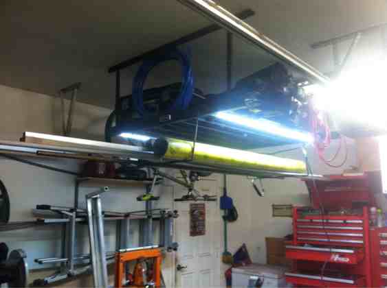

Why not put it on locking casters so you can roll it out of the way when need be ?
I use these 5" total locking ones on my welding table... 300lbs capacity each and cost about $7 when I bought them a few years ago. Weld a nut onto the backside of the mounting tab and you can level it with a washer if needed.
Attachment 12726

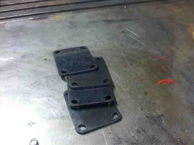

Caster plates cut from 1/4"
Attachment 12765
Attachment 12766
Attachment 12767
Attachment 12768

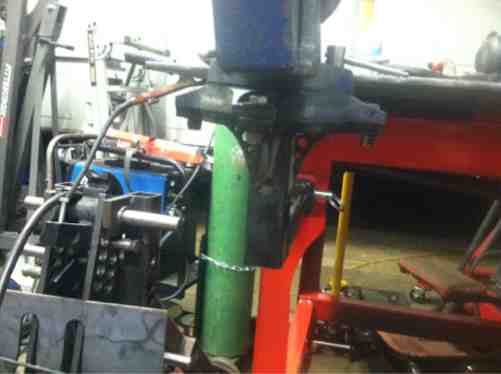

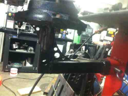

2 Attachment(s)
Made gussets for the vise mount
Attachment 12788
Attachment 12789
