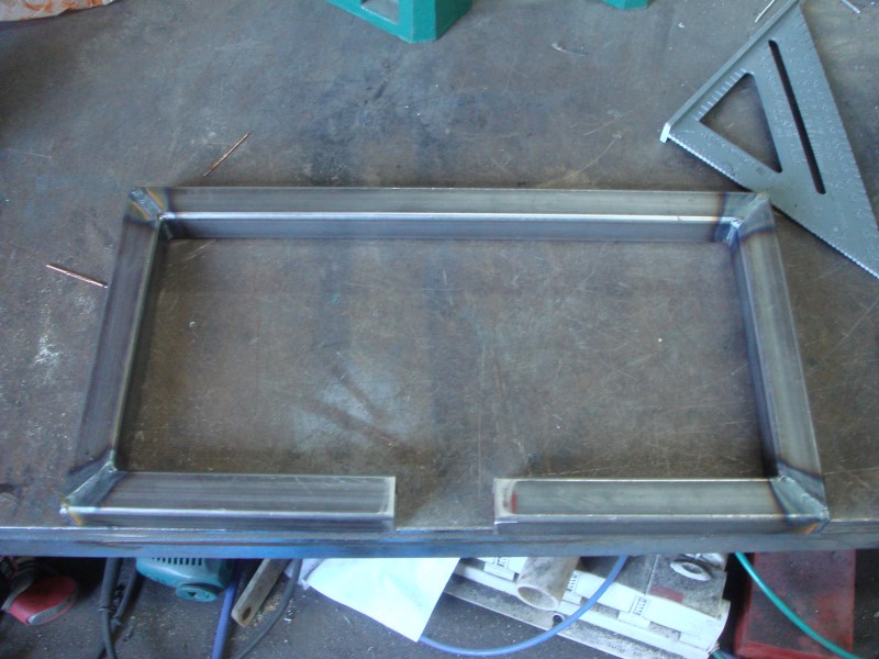

Then cut up all the pieces, and prep for welds. Still happy with the Northern corner clamps. Someday I have a few changes I want to make, though. I few gratuitous weld shots. All TIG and all with the 140ST
Attachment 12161 Attachment 12162 Attachment 12163 Attachment 12164 Attachment 12165 Attachment 12166
