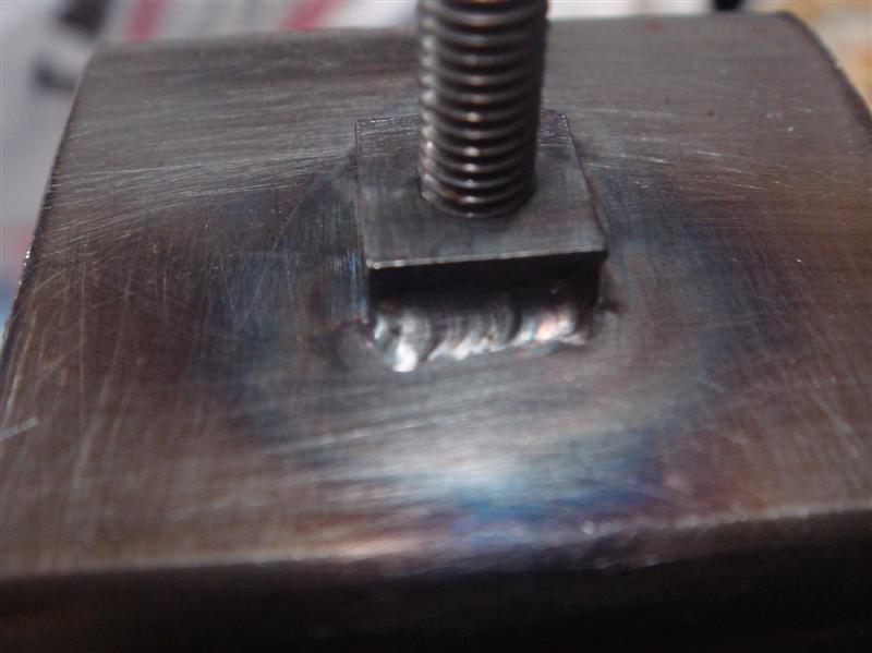

Hi all, just got a 200DX and am trying to learn the basics. I have gone through about a whole 60lb tank of argon am still unable to put down anything that remotely resembles a decent weld. I am using straight argon, 3/32 ceriated tungsten and 1/16 tig rod. I have experimented with varying amps and pulse settings so I am familiar with the machine. And yes, I have the torch connected to the neg. post and is set to DC :).
I sometimes get splatter from the rod and occasionally dip the tungsten into the puddle. Right now, I want to weld some 1/4-28 nuts to some .120 mild steel but all I get is a big glob of ugliness. I have the tungsten sharpened good, in my eyes anyways, and I would like to know how one would go about making the tiny clean welds I see so often. I have trouble getting a puddle started with lower amps (50ish) and burn right through the nut with higher current.
