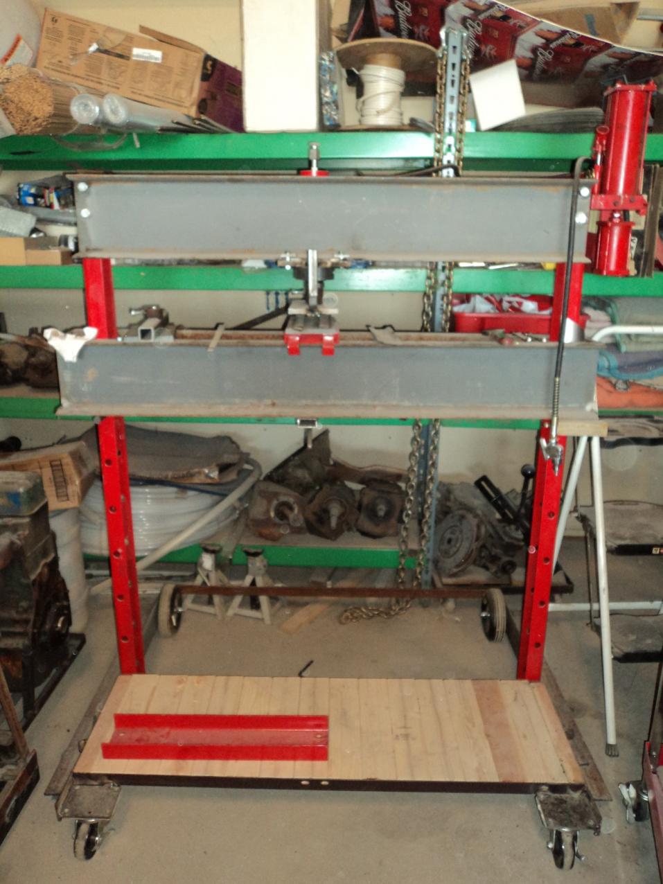

Custom 30 Ton Press Modification

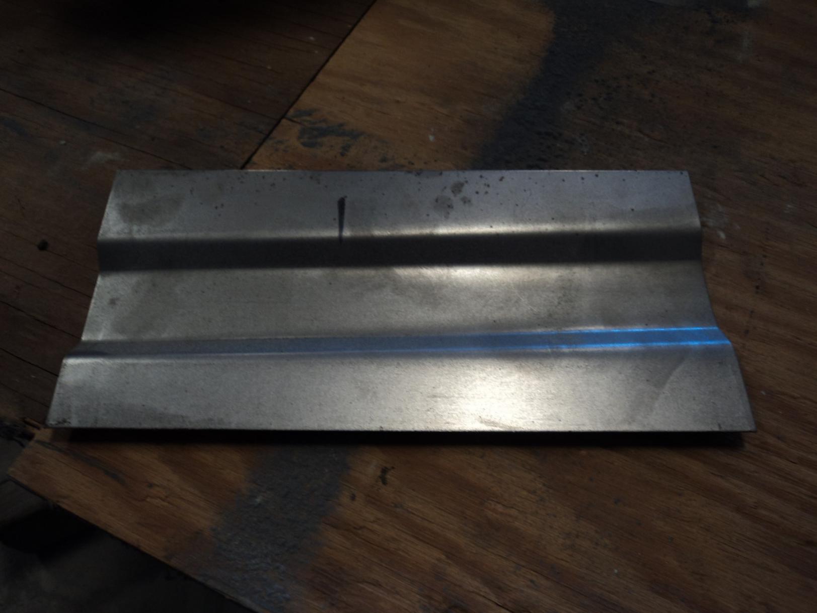

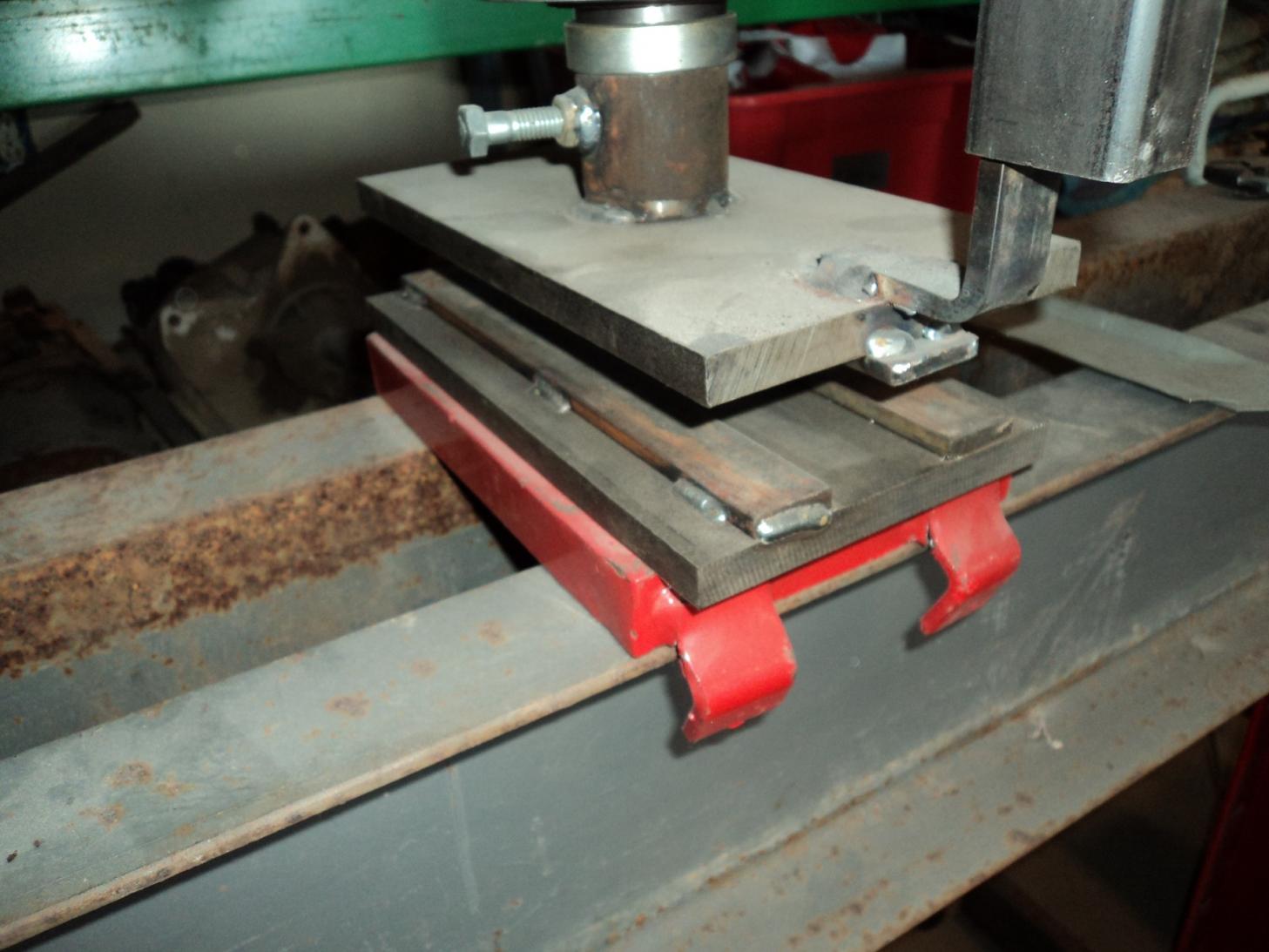

Needed more room in my press for making floor pans ect. had a new 30 ton air over hydraulic press 20" between the uprights. Used some 8" 13.75 structural channel. New inside width 48" this will let you stamp in floor pan channels across a sheet. I can now work a 30" square sheet and channels it across the sheet. I made a couple of dies to stamp in the channels and some flat dies for crimping and folding edges.Used the 200 DX in stick mode for the new 8" channels and the mig for die building.
