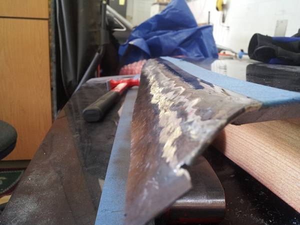

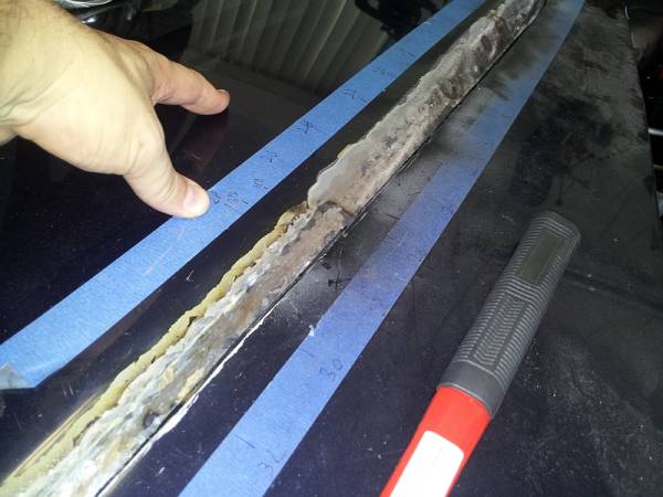

I've been working on a sheetmetal project where I'm making my hood into a cowl hood. This means I have to add some thin strips of metal to the existing hood. I cut and sanded the first part so it had zero gap when I butted it up to the edge of the hood. Then I started tacking it with the tig. By the third tack the metal started pull so badly that it overlapped. Next piece I put in I will add some shim stock spacers about 10thousands thick then the tacks should pull it tight. Anybody else experience this?
