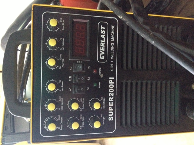

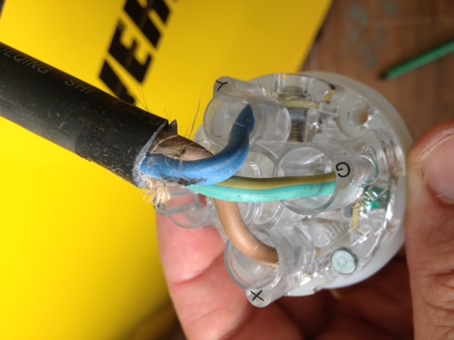

Greetings,
I borrowed an older yellow Super 200PI 4-in-1 from a friend who had never used it. After putting a plug on the end, assembling the air filter/reg, and firing her up, I have no current on the display. Power light is on. I tired some MMA, and cutting all per the manual, but no matter how much I dial up the current knob the display still reads "000". I was able to get a very small amount of current through the stick, but nothing close to what is needed to weld. I also was able to get a few short spurts from the cutter, till I got the red light. Shut everything down and tried again, but no luck.
Is she DOA? Any help appreciated! Thanks.
