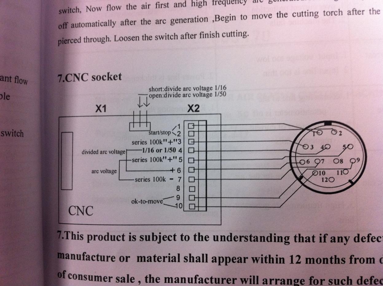

CNC port on back of PP50- Pin out validation?
Hi all; My manual is the one from the web. Seems old and the image of the rear is completly off? I did find the following image from one of the Forums for the CNC port on the PP50. Just wanted to post here, and also see if anyone knows where to download a current manual that does cover the newer model?
Thanks In Advance,
URL - http://www.johnhasmorefun.com/misc/p...ort-pinout.JPG
IMAGE:
Jeff. Attachment 10600Attachment 10600
