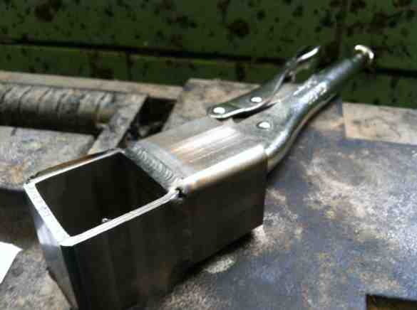

I finally got a chance to run my first beads on my new welder. Actually, my first beads ever. When I discovered that the local community college classes were all full, I just opted to buy a basic welder and teach myself through trial and error and internet research. I had a 2-foot-long piece of 6" square tubing, 1/4" wall thickness, left over from a project a few years ago that I'm using to run stringer beads on for awhile just to figure out what the heck I'm doing. It's rusty, but I brushed it off fairly well on one side, so it doesn't look TOO bad. Arc is supposed to manage light rust OK, right (or am I wrong on that?)? I'm plugged in to a 240V outlet, BTW.
I bought 5 pounds each of Lincoln 3/32" 6011 and 3/32" 7018 from the Home Depot and ran some 6011 first. I started right in the middle of the range printed on the box, about 60-65 amps, then bumped it up to about 80 amps after a few rods. I tried 90 also, but that seemed too hot to me. It certainly was a quick learning curve, seeing what the puddle looked like, sounded like, felt like, trying to hold a tight arc, trying to keep up with is as the rod burned off, etc. As expected, I'm not maestro with my first rod! I was moving too fast horizontally and I was pushing rather than pulling, so I couldn't see the puddle real well. When I figured this out, and corrected both problems, it got MUCH better results, perhaps
All in all, I burned about a dozen rods. I was secretly hoping that I'd be able to make welds that looked like Jody's from weldingtipsandtricks.com, but I knew that wouldn't happen right away (or perhaps ever). I'm probably still using the wrong heat, difficult rod, and possibly a rod too small for this metal thickness. I'll post pictures when I get some, because I'd like whatever feedback you guys can offer to help me pick this up faster. There's definitely a level of art to it!
