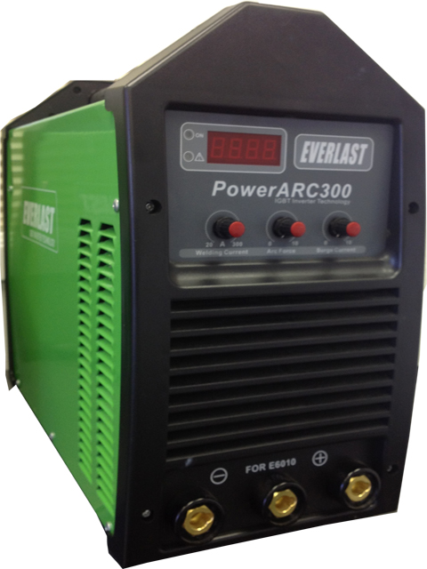

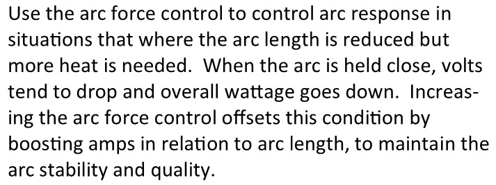

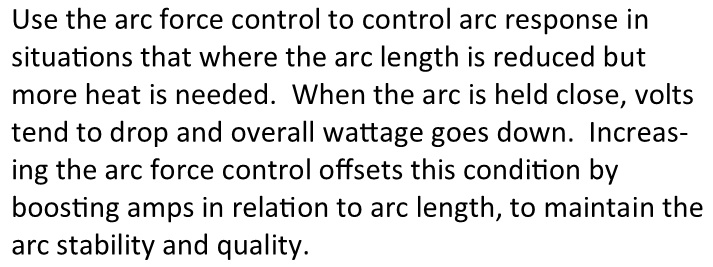

That's good to know. I wasn't really trying to find an off switch so to speak. But just wondered what it'll be like to have an inverter without arc force. Guess it would likely stick much more as you're saying. No problem, it is indeed my technique I know. There's still a lot of feeling around to get it just right.
