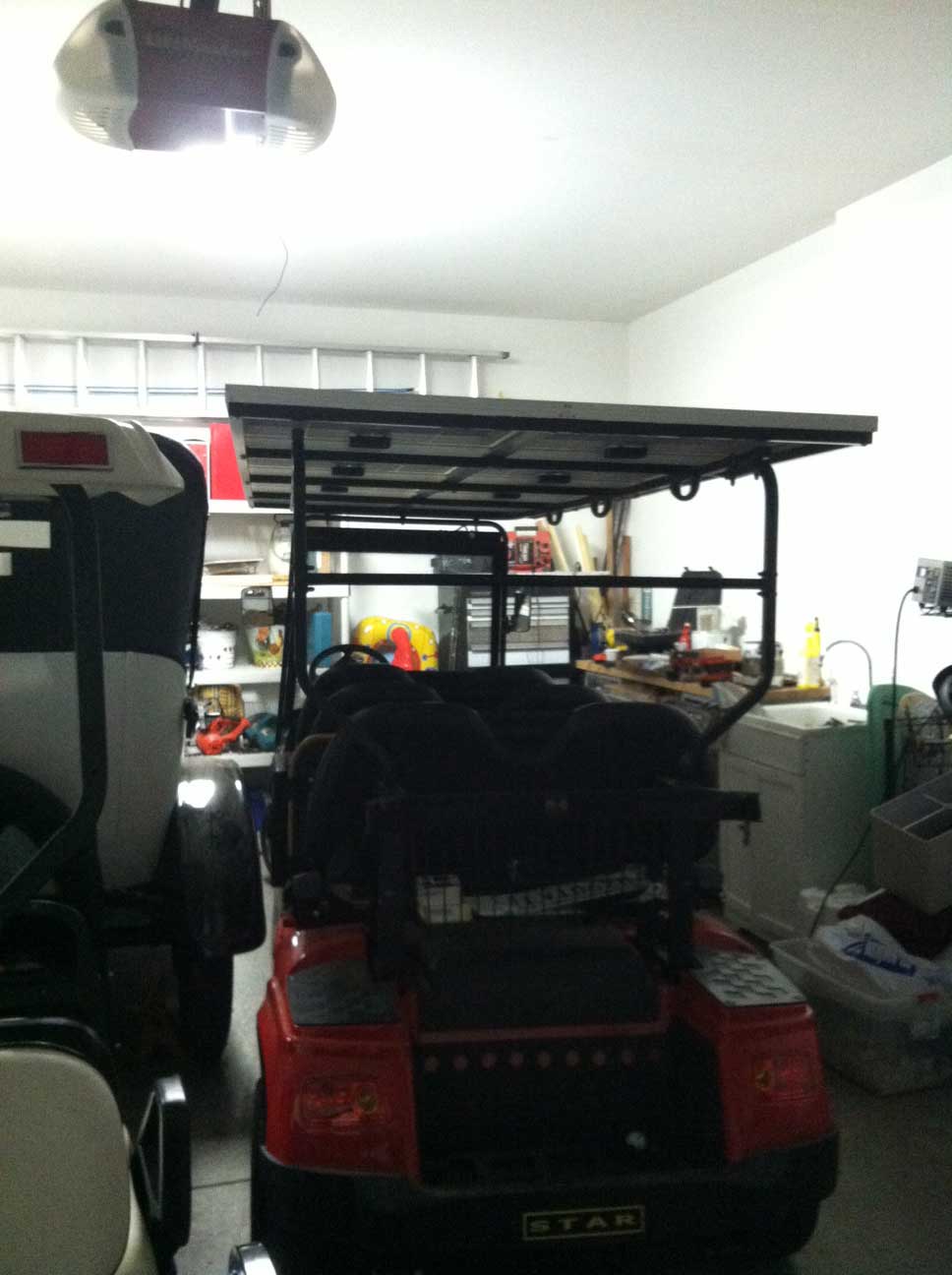

This is a fun one. I am building a custom roof for a 6 seat NEV car..... AKA a limo golf cart.

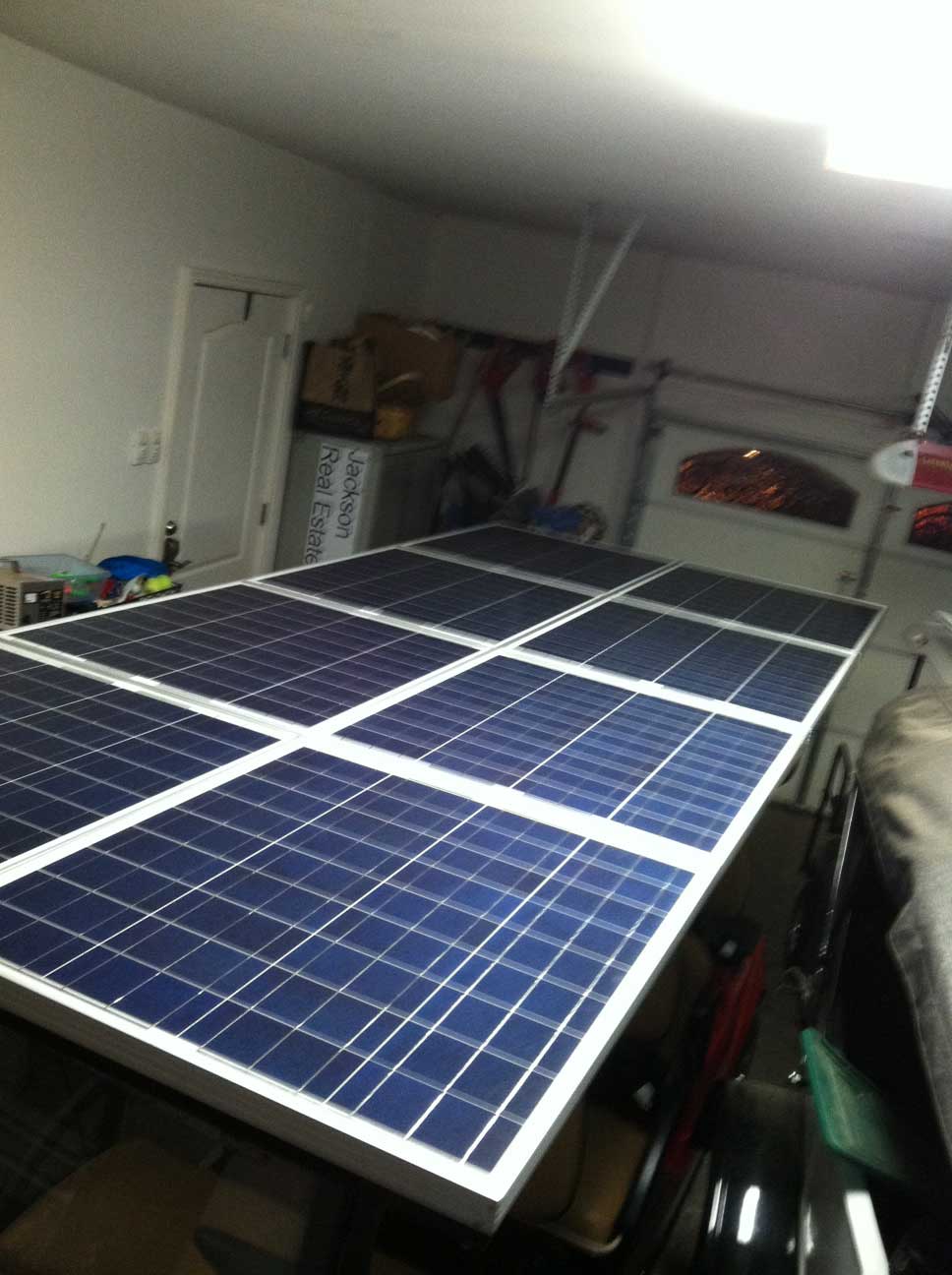

The original fiberglass roof will be removed and 8 - 60watt solar panels will be added. The plan is to add an inverter so the cart can be used as a solar generator in a power out situation. I may also add a small grid tied inverter so any excess power can be feed back to the grid.....
The original roof was held on with 1" square tubing so I will be building another frame out of 1" square tubing to match.
I picked up the metal at lunch today and will be cutting it this afternoon.... pic's coming soon.
