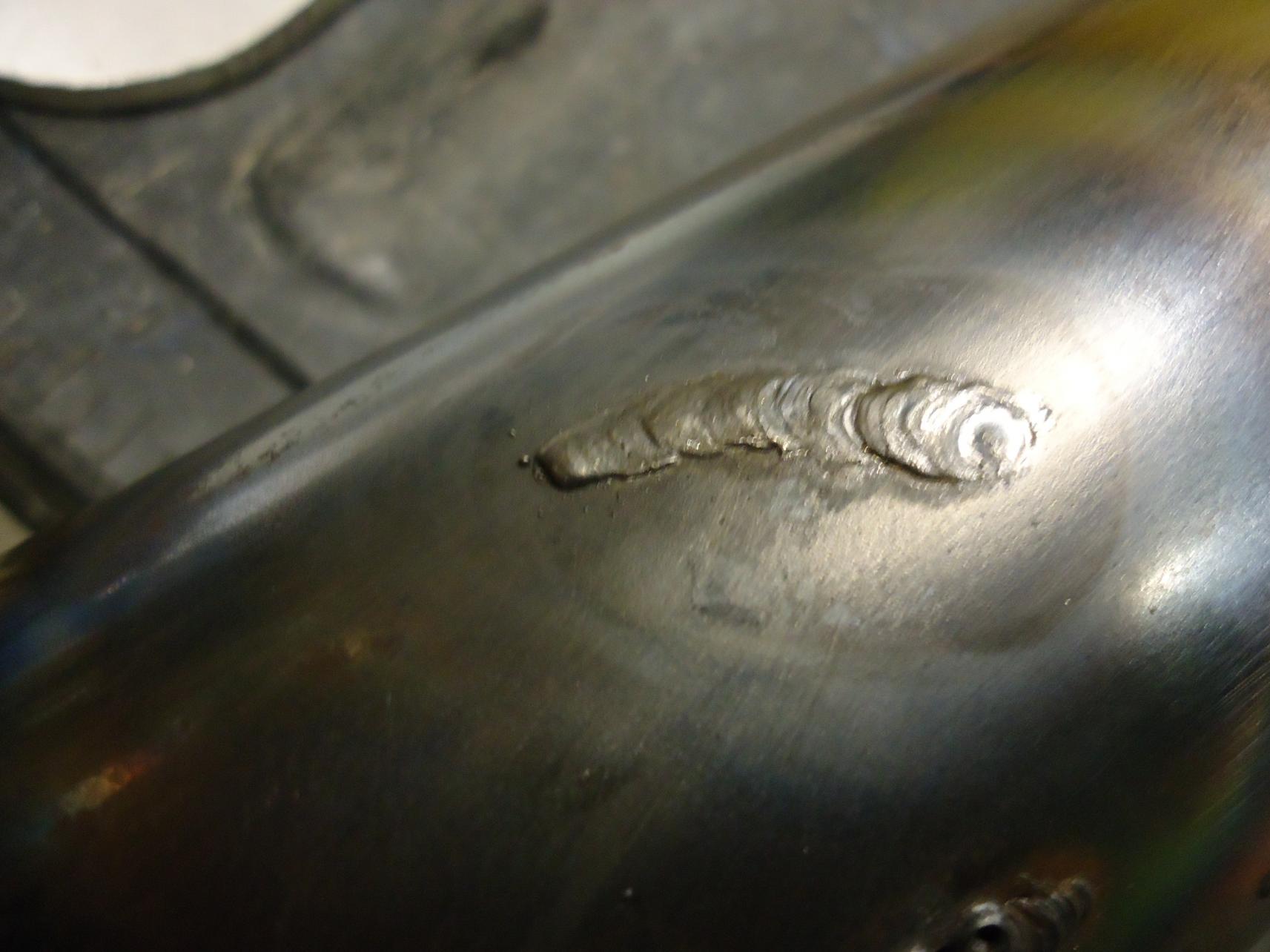

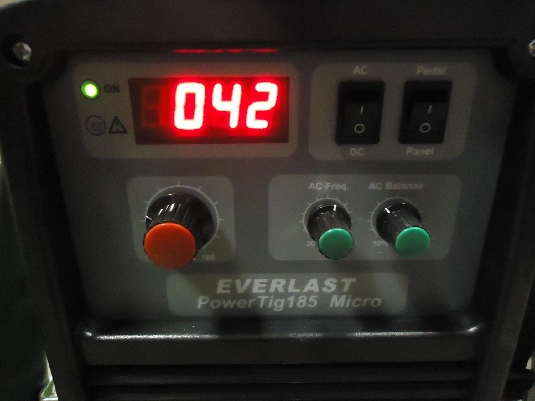

Trying to setup my new 185 Micro, I am getting an erratic arc that is not centralized at the tip of the tungsten, The tungsten also gets to hot.
Welds on Aluminum are not clean either they are black.Gas flow 5-7 lpm, have tried up to 10 lpm no help.Tried some mild steel same problem.Gas Flow seems good at the torch.I am going to check the torch for a lose hose.
