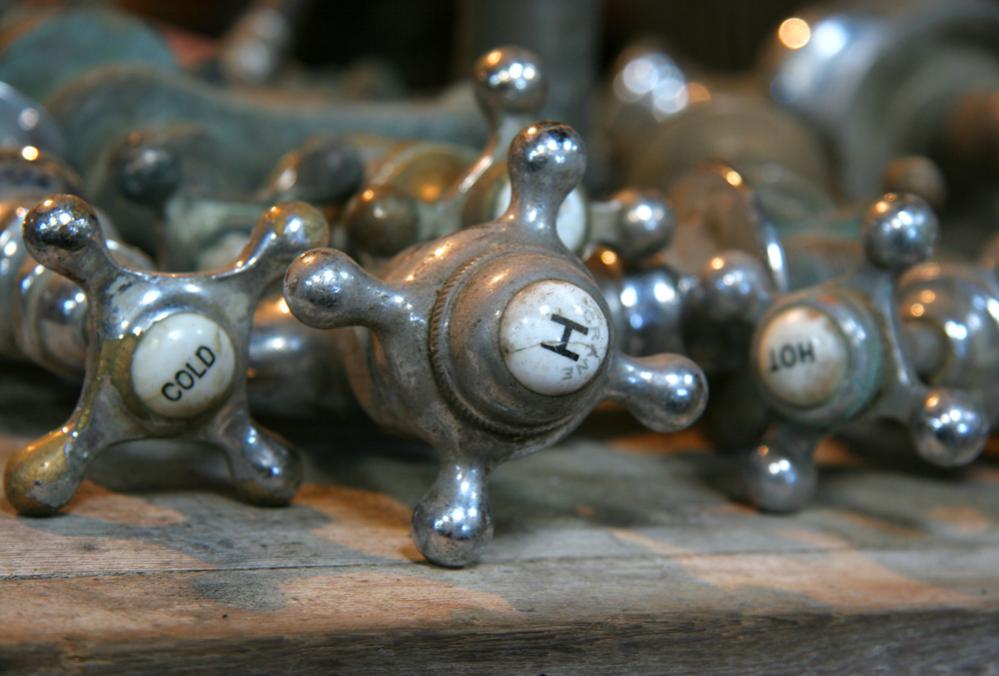

hey got new knobs for my 250ex lol Attachment 7291 think it will give it that redneck rustic look
