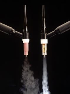

I was wondering what the difference is between the standard lens, gas lens and gas saver lens. I want to order a CK 130 amp torch (like Zoama’s) and don’t know the differences in the lens. Anyone have some explanation?
From what I have learned the standard lens works, but it has air current ripples that dissipate the gas quicker. The gas lens has a screen (or a couple) that act as a filter to smooth out the air currents so the gas comes out like a straight tube. At least until outside air disrupts it. Seems to work better for extending the tip out to see what you are doing better. Also the gas lens take a different ceramic cup.
Not sure on the gas saver.
Brian thanks for the info. I remember seeing the picture on CK's website with the standard lens and gas lens although I thought it was the gas saver.
Attachment 7064 this pic shows difference

I did some research... It looks like it can save you 40% over a standard tip. You just have to remember to turn your gas flow down to compensate for the better coverage a gas save or gas lens will make.
From what I have found the gas lens, like what I described above, has several screens near the tip of the torch to make the gas flow less turbulent. Now the Gas saver is a little different. It has the screen closer to the top of the torch. It is a little different design to make the flow better. They both tend to use a larger cup so they are tighter to get into corners. That is why they they went with the pyrex cups. so you can see closer into the corner. Kind of a give and take. You need to remember to turn the gas down to see the savings. It looks like you get more of a savings with the saver than the lens, but not a large amount.
