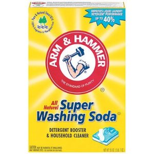

reverse electrolysis works better just need washing soda and a battery charger . throw the rust piece in a plastic tub fill with water add some washing soda . hook negative charger lead to part to derust and positive on a chunk of metal , turn on charger at 10 amps removes every bit of rust . . just make sure chunk of metal dont touch part cleaning. its call reverse de-plating http://antique-engines.com/electrol.asp have a cylinder head soaking rite now doing this since rusted solid and cam locked up in head from rust
its like baking soda but stronger safe to use . Attachment 6960 you can get it at your local super markets . I use it for getting whites clean when washing close safer than bleach on whites

Washing soda is sodium carbonate, baking soda is sodium bicarbonate. Washing soda can be found in market among the household cleaners and laundry detergents. It is more caustic (has a higher pH) than baking soda and is pretty aggressive. However I prefer phosphoric acid if you can get it. Driveway cleaners made for removing rust stains from concrete contain phosphoric acid. So does Naval Jelly. Best if you can heat it while derusting. It leaves a flat gray-ish colored iron phosphate deposit that is a good surface for accepting a primer coat if you want to paint over it.
