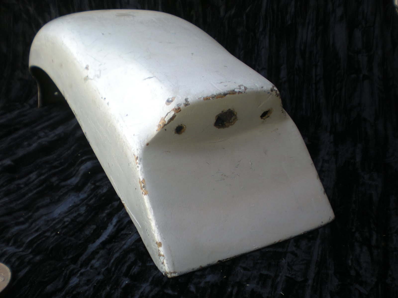

But the front end is damaged, the rear fender is glass and would need a ton of re-work to fit (and I want to put it back on the '59) so I started looking. I found a deal on a 22" over front end, the one above on the blue bike is 14 over for reference. I decided to make a new rear fender out of a 55 gallon drum, then decided to add a front, and figured since the rib from the drum would be a prominent feature, I'd add a strip to the tank too.

So that's about an hour with the wrong hammer. I picked up a better mallet and the shaping advanced. At this point though, as heavy as the steel is and the critical fit, I decided to redo it. I'm going to do it in 5 parts. I'll cut a two strips, form each outer curve, weld sides on, then bolt them up and lay a center piece with the rib. Cut, flange, weld, and be good to go. The back of the fender will mimic this style
Attachment 6869
With the rib built in to the top.
The front fender will be a single piece, small curve to it.
