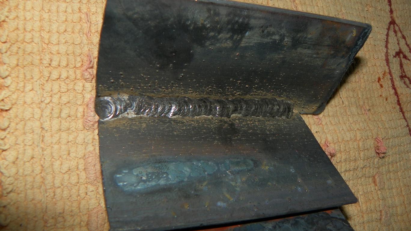

Attachment 5969Well, here I have an uphill weld...Four passes of 7018 at 90 amps on 1/8" steel.

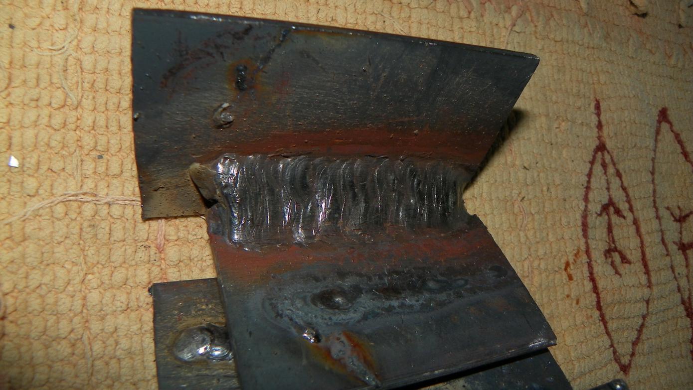

Attachment 5967Here I have just one pass of FCAW.

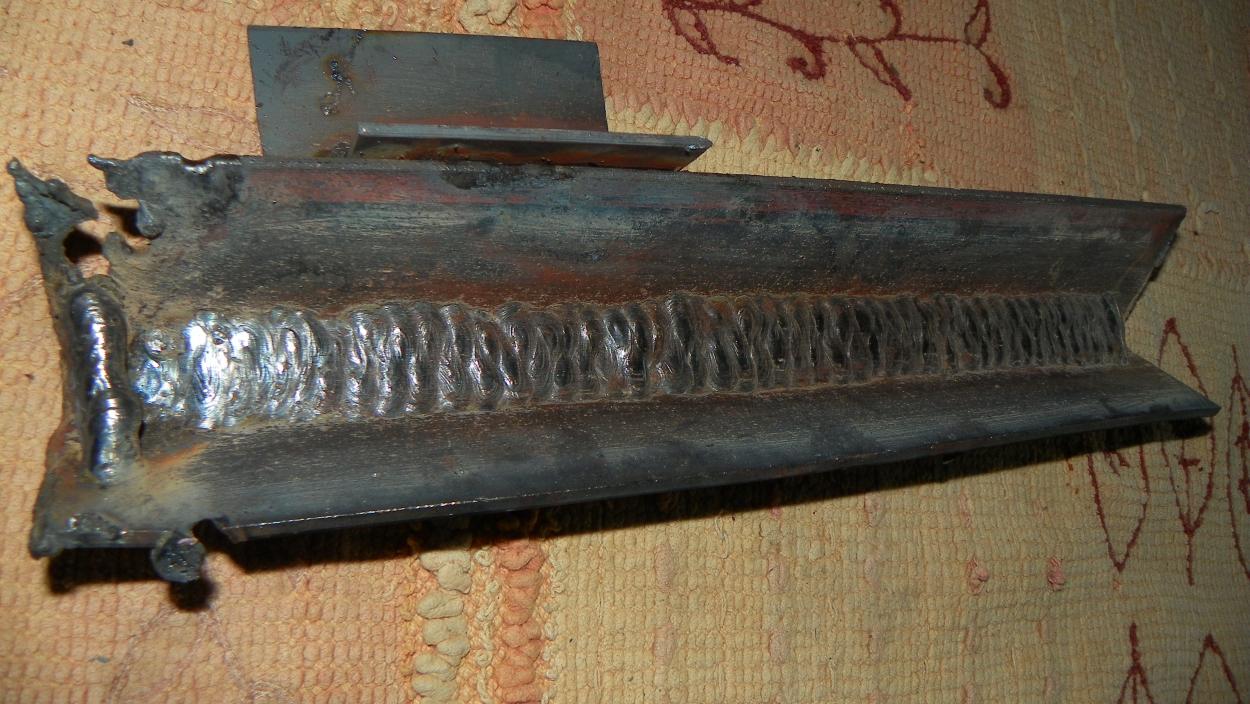

Attachment 5968And here I have 7 passes, yes seven passes, of 7018 at 120 amps. The weld is about 1-3/16" wide.
This was all performed with my Everlast IMIG 200.
