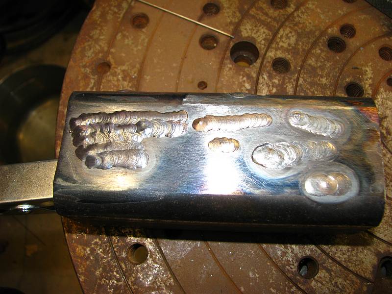

PowerPro 205 is the machine. I agree with the helmet issue. I had to turn the sensitivity up and din down. mutter mutter new fangled dang things...
I experimented some with the 2T torch control but it's not for me. I used a Wp17 150 amp for so long everything else feels like a pick axe and there seems to be no way to hold it without hitting the switch. I got no more heat out of it either.
I'm pretty sure it's running about 50 amps. It's just barely enough to melt 1/16 rod on 1/4 plate. You have to wait on it. If the torch is kept in one spot with the pedal all the way down, it'll melt out a place smaller than a dime in ten seconds.
I'm sitting here pondering how to describe something as subjective as heat in a weld puddle. :) I know my old machine would hum and rattle and burn a hole at 150 so I know something's odd somewhere.
Is there a way to check the foot pedal with an ohm meter to see if the linkage is slipping somewhere?
