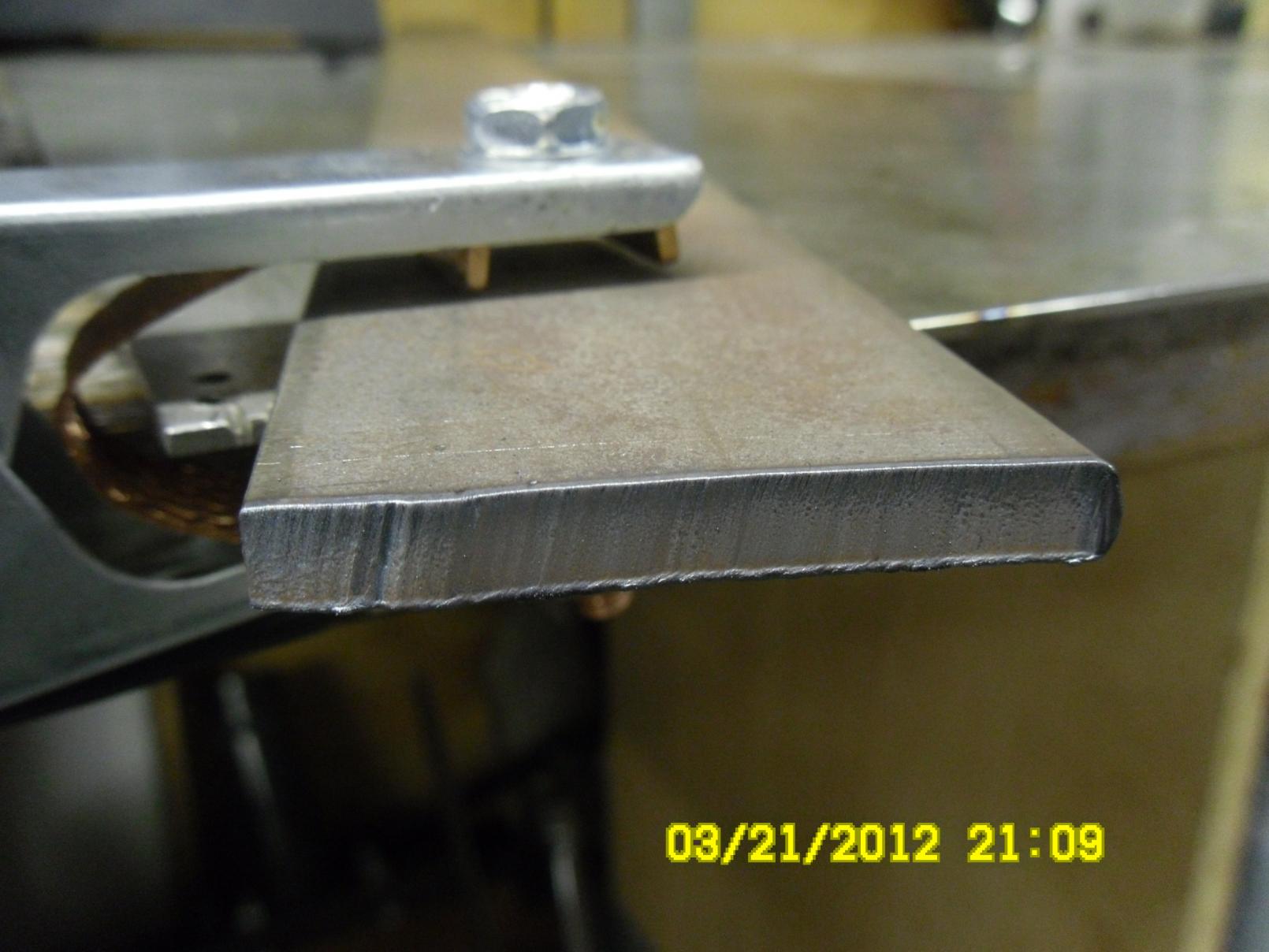

Here's what I got with the machine on 120v. oh and all i had was 1/4 steel. amps at 45. air at 65psi.
the welding was all pedal. with 3/32 lant. pure argon. 5 cup.
220v cut
Attachment 5939

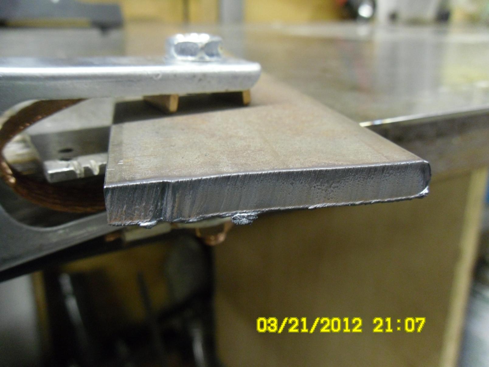

120v cut
Attachment 5940

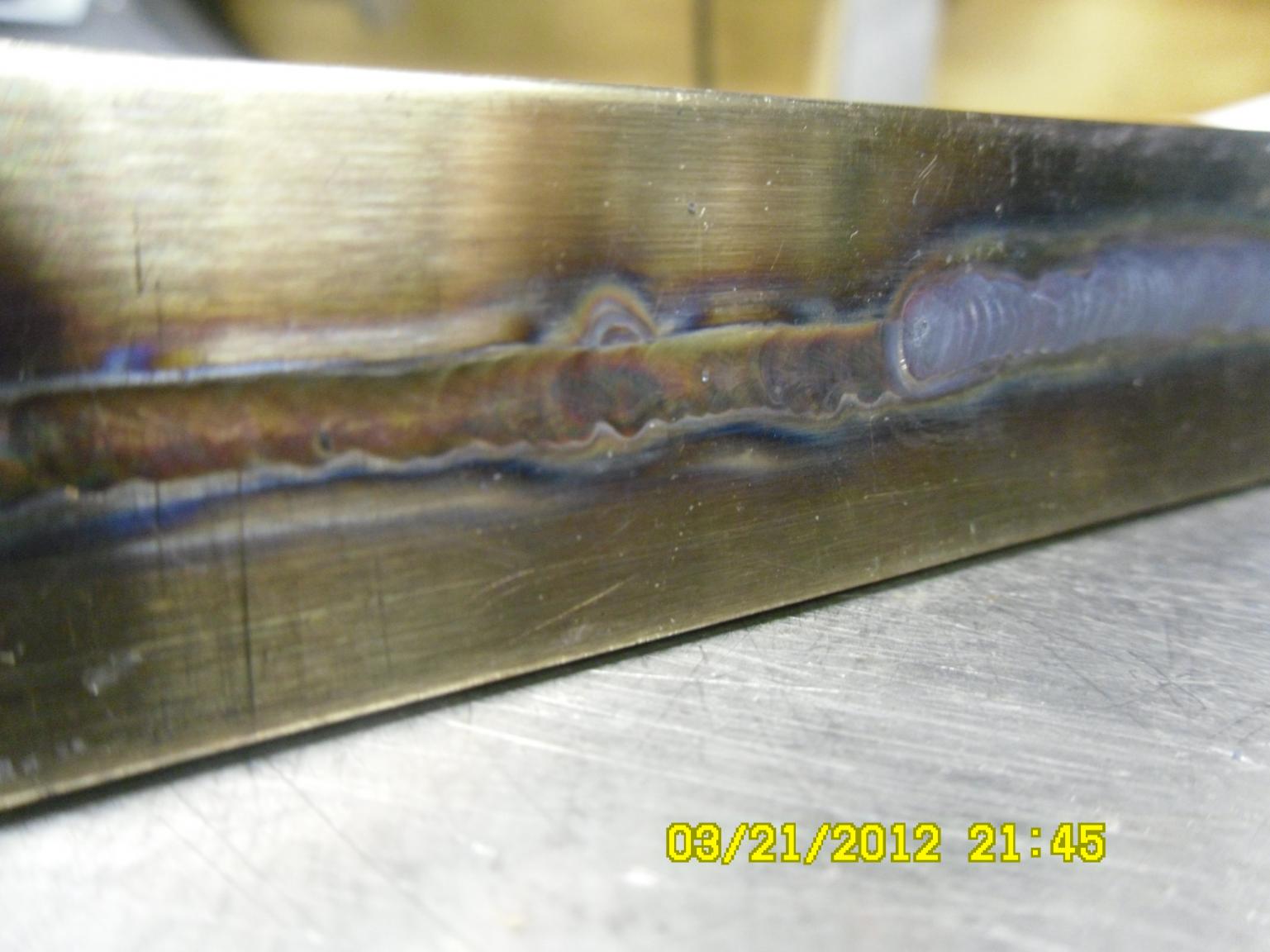

120v w/filler
Attachment 5941

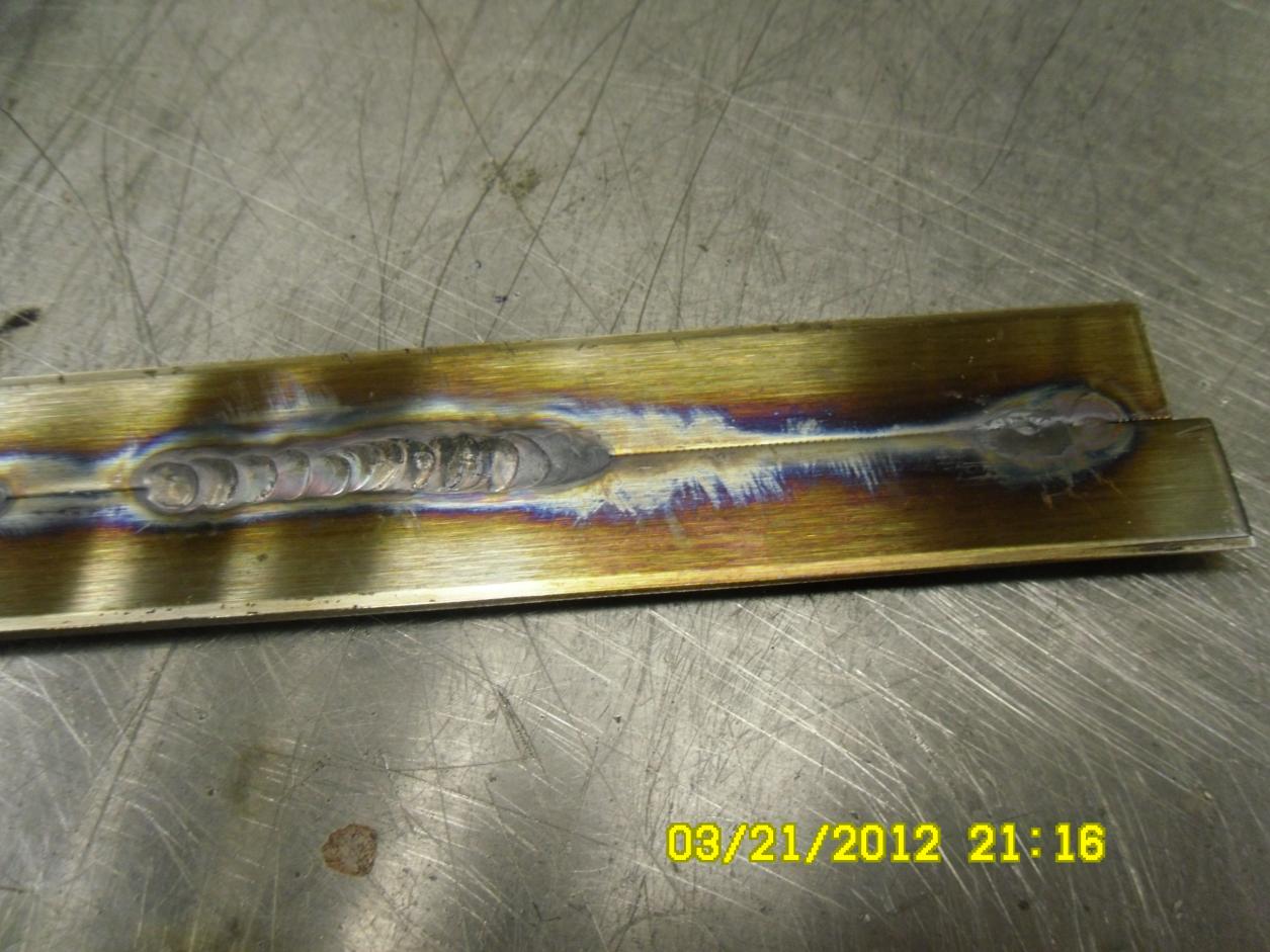

120v fused
Attachment 5942
The machine didn't hiccup at all. hope this helps.
