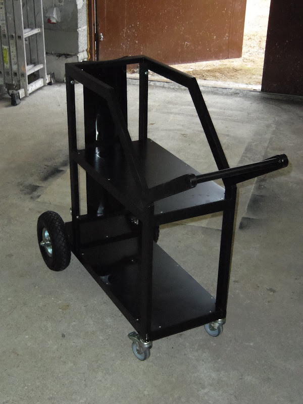

That standard cart seems to be flimsy on small wheels, so I did not order one. I've made my own cart from pipes using the very machine. It's already welded but not painted (I am waiting for warm weather). There are preliminary photos of the cart without front handle and other parts which are supposed to be bolted (wheels, loops, and plates).
https://lh3.googleusercontent.com/-S...0/IMGP0374.JPG
https://lh3.googleusercontent.com/-j...0/IMGP0375.JPG
