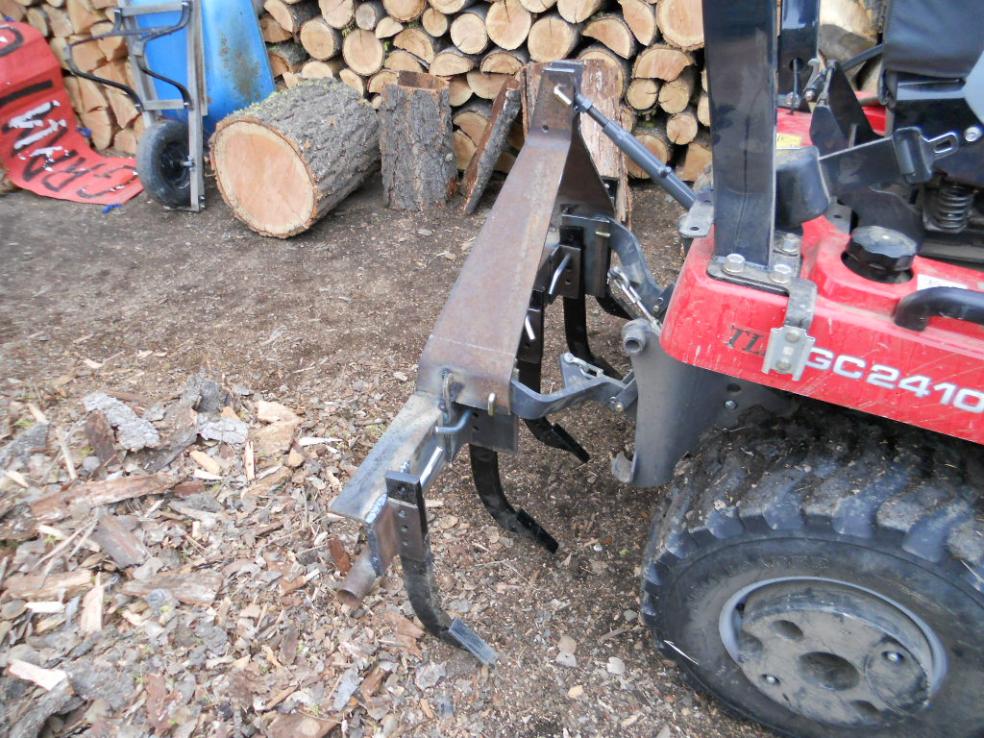

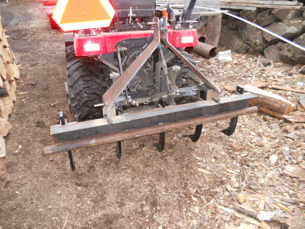

Attachment 3725
The main cross support for the shanks consists of a 3x5 piece of angle welded to a 2" tube, mostly because that was what the scrap yard had on the day I went shopping.
Attachment 3726
This is the progress to date, all parts of the ripper portion have been cut out and the holes on the shank brackets are completed to the point where the belt on my drill press broke.
