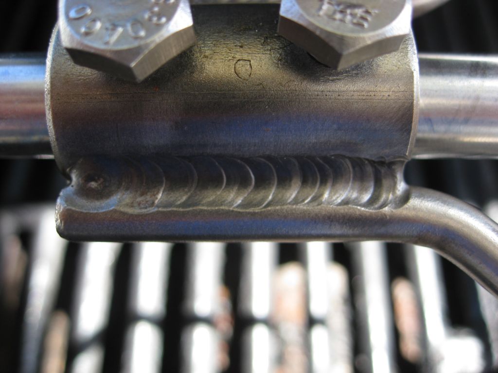

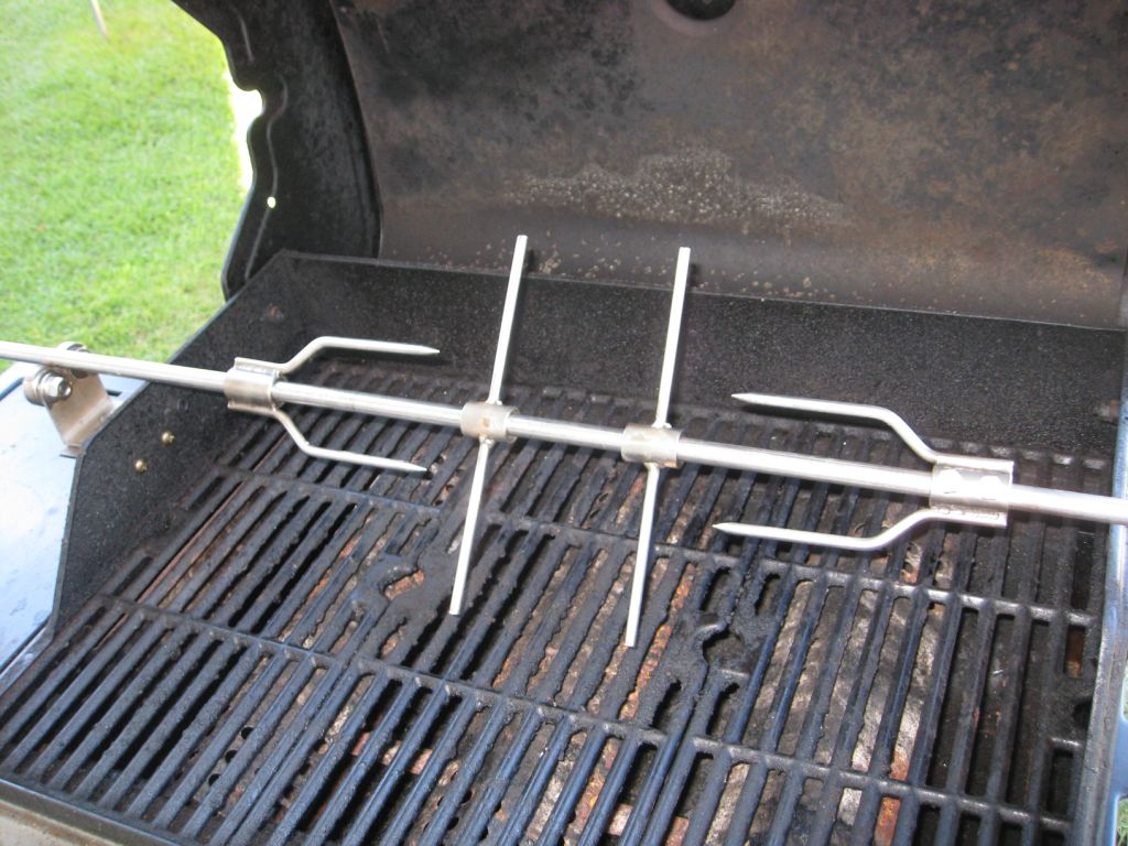

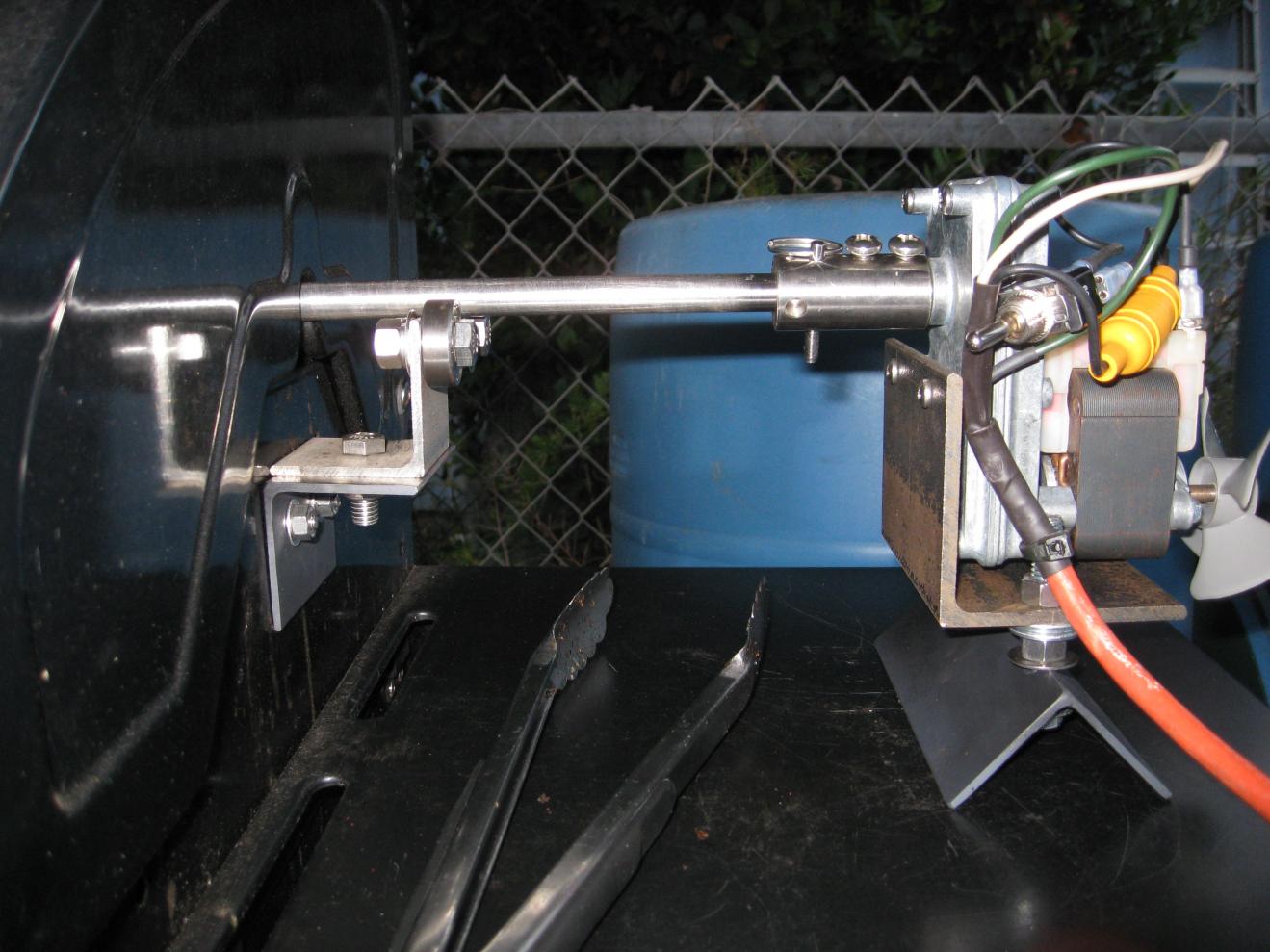

I made a pig rotisserie in February and wanted a smaller one for my grill. I already had the 1rpm motor so I put this smaller one together. The spit is 304ss 1/2” x 3’ rod and the prongs are 304ss 1/2” sch40 pipe and 304 1/4” rod. I used 3/32” ceriated tungsten, 1/16” 308 filler rod at ~80A.
Attachment 3222Attachment 3223
