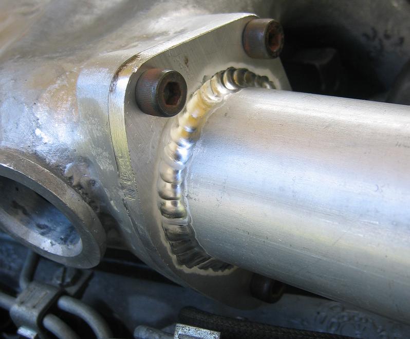

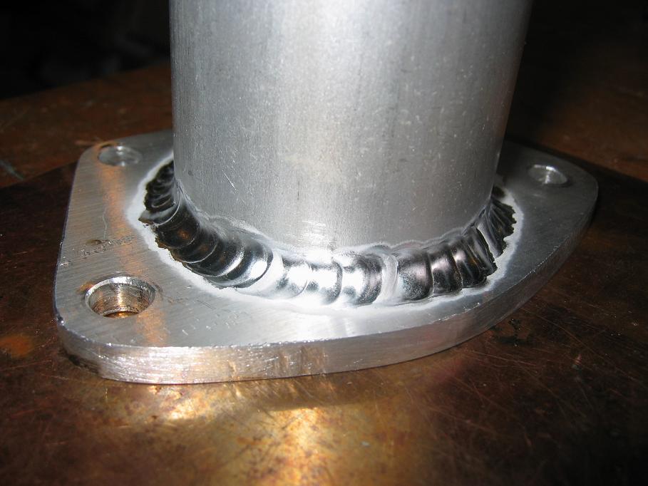

Here is a flange (1/4" plate of 6061-T6) fillet welded to an intake pipe (2.25"OD .065" wall 6061-T6 tubing.) I used 3/32" 4043 filler rod.
Prepped for welding:
Attachment 3170
After welding:
Attachment 3172
Attachment 3171
I didn't cut the hole in the middle of the plate until after I welded it. I did it that way to reduce distortion. But having the 1/4" plate being continuous, meant it would soak up more energy during welding and require more power for welding.

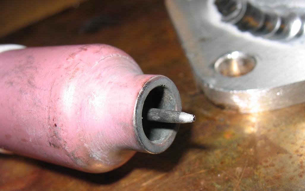

I used about 2.5 cfh Helium and about 12.5 cfh argon, with a #6 gas lens cup.
I used a 3/32" tungsten truncated point (like a crayon), 2% lanthanted. Only the very tip melted/balled.
Attachment 3173
I used 20% DCEP AC Balance (minimum on my machine.) The Helium seemed to really concentrate heat. It makes a puddle more effortlessly, and a deeper puddle, that penetrates much deeper, too. I set the pedal to give it everything it's got (200 amps) at full pedal down, but found that I didn't need to floor it. I probably used about 3/4 pedal to get the puddle going (maybe 150-160 amps?)

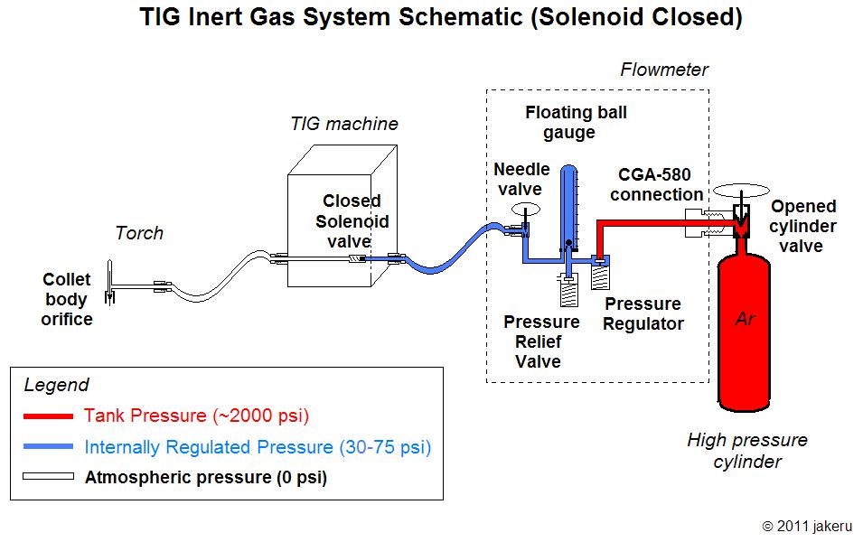

How did you mix the gases?
Just wondering how you incorporated the helium intothe argon. I have seen Jody's setup, which is a simple y-adapter setup where the 2 gases converge someplace upstream of the torch, and what you get at the torch is beyond me. I have also seen gas mixer on the action site made specifically for this purpose and the cost is around two GRAND!! Ridiculous. So, which setup are you running, and could you show some pics? Nice welds by the way.
