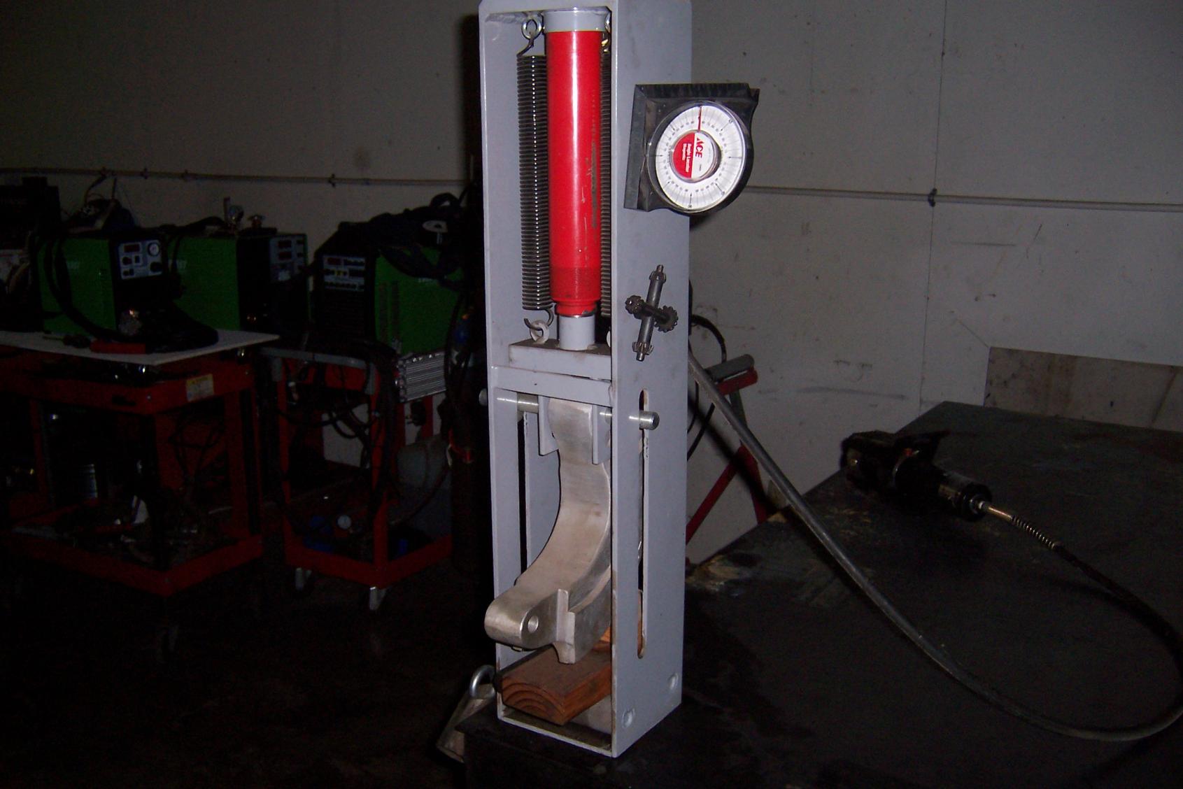

Air over hydraulic tubing bender build
Ok first Off I started with a set of plans from www.gottrikes.com I'm Building the B version.
