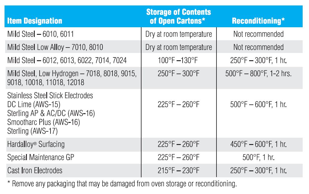

    So, maybe I dried them out with the desiccant? I'll pull a couple out and see how they run after being out for a few days. What about 6013? Should I be trying to keep them dry like the 7018?
    Here's a chart I found some time back- 6011s don't require reconditioning, but 6013s do. I predict a toaster oven in your future!
