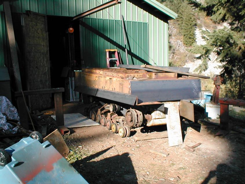

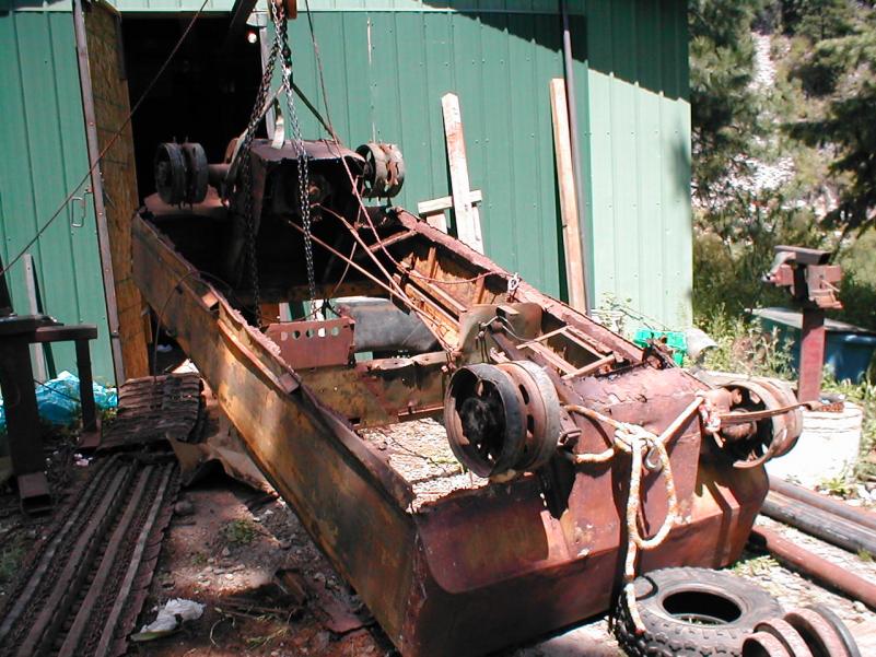

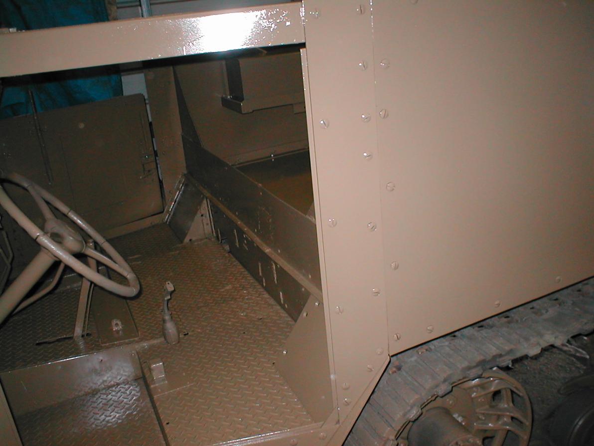

  4. Default 1943 ww11 halftrack restoration
    this partial halftrack came from the desert east of el paso tx, was used in the film LONE WOLF MCQUADE,which starred chuck norris, then left to rot, it was a down to frame build, all armor had to be fabed. our thing is military vehicle restoration, they come in as rusted out hulks and leave like new. we also build full scale cannons, mortars etc.bill .www.bigshotsofidaho.com

    MFGunner,
    Thanks,
    I was wondering a couple of things about your project rebuilds.
    The half track was originally German?
    What would the thickness of the original armor be? Was it special material?
    How do you recondition the tracks? I have a heavy equipment background and was wondering if you had a "secret" stash of old track material or something. My father has an old Oliver Cletrac he is rebuilding and needs some tracks for it to make it nice. It could have been originally a military unit. I am not sure.

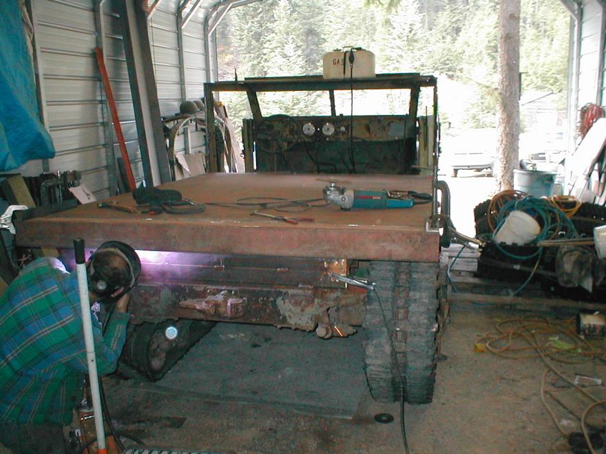

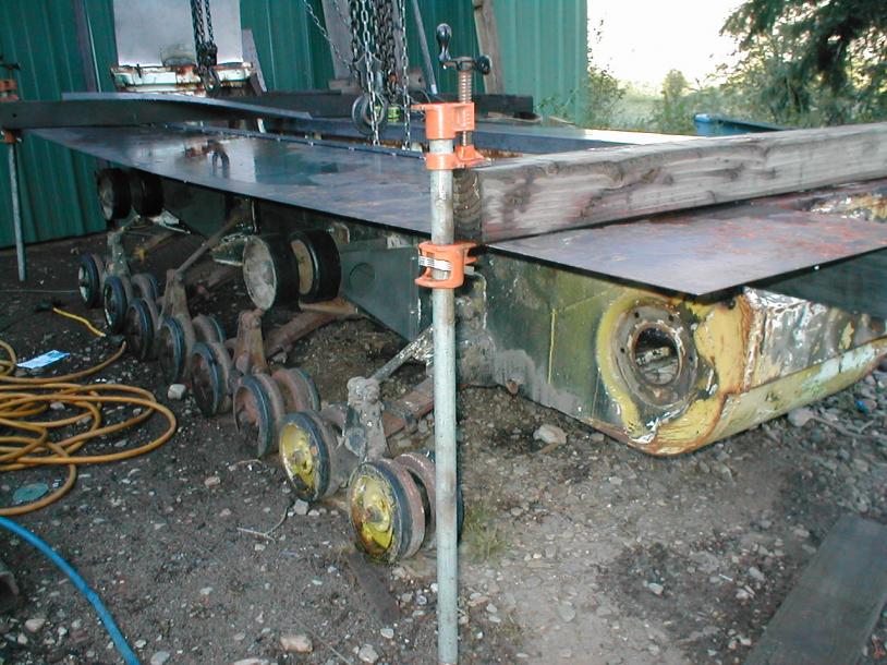

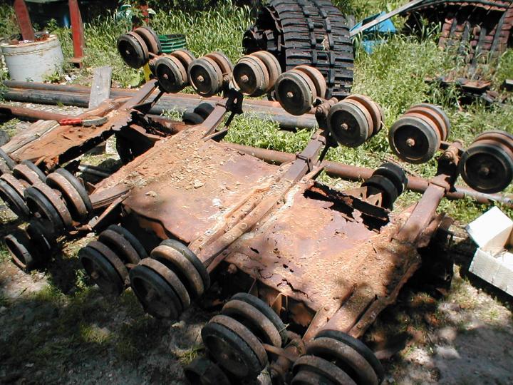

  6. Default another contest project,ww11 m29 weasel carrier
    this rotted out mess was a definite challenge, required new framework,floors,sides and skirts.a plasma cutter really saves the day on a project of this magnatude,if there is any steel left in the rust a plasma cutter blows it out!

  7. Default halftrack rebuild
    these halftracks are 1943 us m-15s built by white, their weight is 18000 lbs, armor plate is 5/16 ths, armed with browning machine guns 1919 or 50 cal m-2 browning
    Its a shame to see such history rotting. But, then again, I've seen old American farm tractors and equipment doing the same thing. I still hate it when I see a piece of equipment rotting down that I know someone could fix up and use, but the person will let it keep rotting and say "someday I'm gonna fix it."
    I am glad people have the foresight to rescue these scrap iron candidates from the heap.

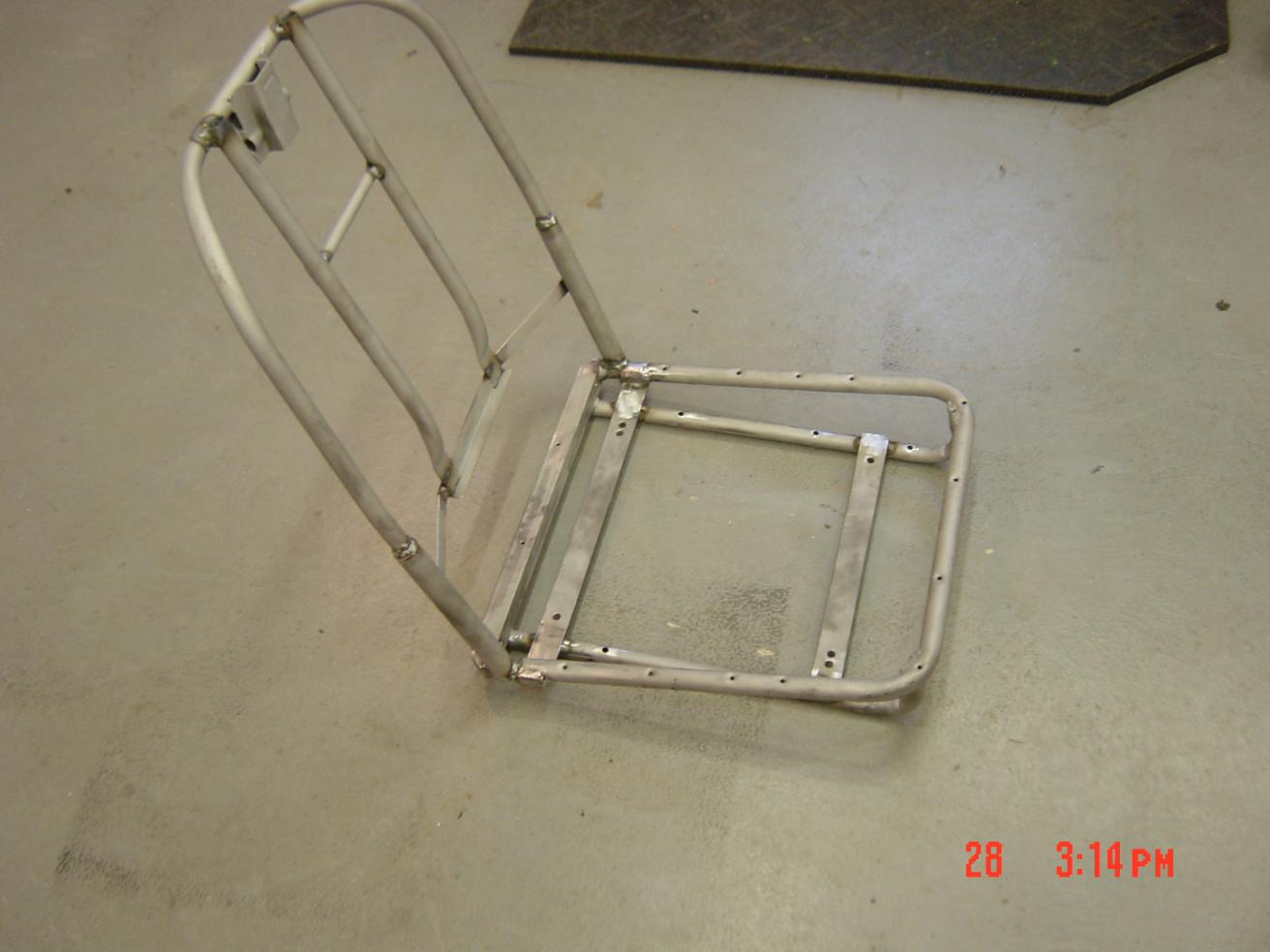

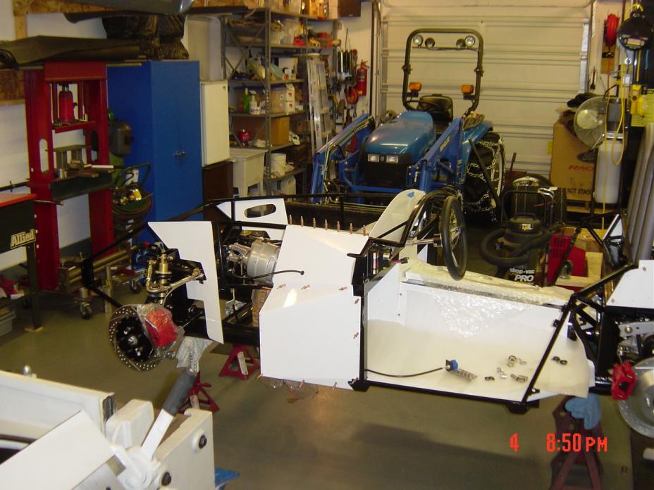

    Default My entry
    Here is my entry:
    It is a replica of a 65 AC Cobra. I have done all the custom machining, welding and fabricating to the kit including the frame, suspension, steering and aluminum panels. It has independent front and rear suspension, complete with aluminum SVO 8.8 center section and 13 inch power disk brakes with twin master cylinders. The brake bias is controlled from the dash. The steering shaft is polished 304 low carbon stainless steel. I also used an old set of MG seats but modified the frames by removing the reclining system, narrower and shortened the lower and upper sections and fitted them onto aftermarket slides to fit the cockpit. It will be powered by a 430 horsepower 5.0 small block ford with fuel injection. The transmission is a Tremac TKO

    Those old cobras were nice. But there are more replicas now than the original.
    But its the appeal of the car that makes everyone a joy to look at.
    I was wondering if a supercharger might fit this car?
    Mark,
    Yes a supercharger will fit. I was running a Powerdyne on my motor when it was in another car and was making 502 hp 498 torque but I took it off. I could not get that much to really hook up in the Cobra any way. This car is really just a fun car. I don't plan on racing.

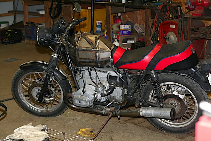

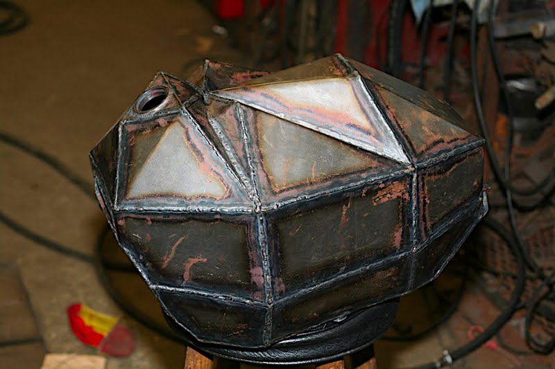

    I know the contest is over entry wise but I figured I would post my pictures here as well as on welding web.
    This summer I have been working on making a new gas tank for my motorcycle. Right now I have it all welded so it holds gas an the welds are relatively smooth. I still need to smooth and paint it. I am not sure how many feet of weld I had to do to make the tank but it was quite a bit.

    Great looking tank, shame you missed the deadline. Please send in a picture when you get it painted.
