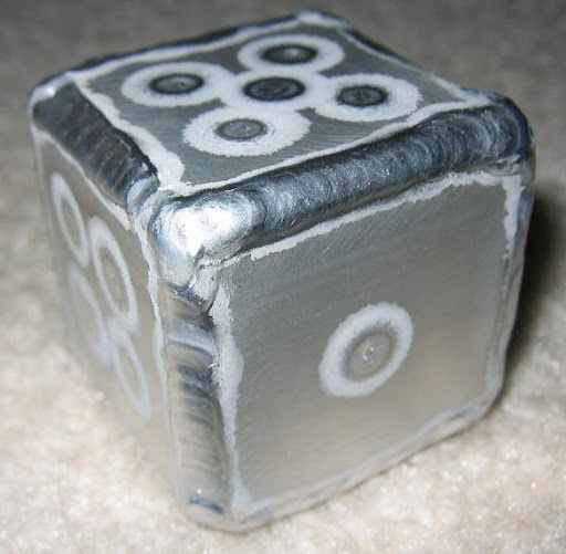

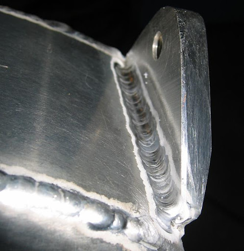

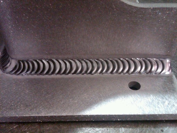

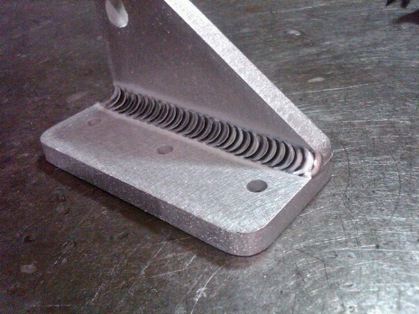

    All,
    I am looking to purchase a Powertig 250EX or better yet an EXT when they become available.
    I however haven't seen much for aluminum welding photos by Powertig owners. If you have some nice work please post it up! I am hoping there is some good stuff out there that will help sway me into purchasing a new Everlast Powertig.
    I will start by posting a few photos of some work that I have done with a Miller Dynasty 300. Hoping to see some comparable work with Everlast units!
    Best regards,
    Tony R

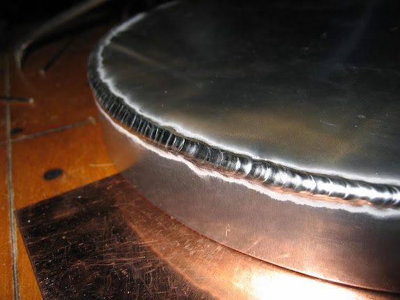

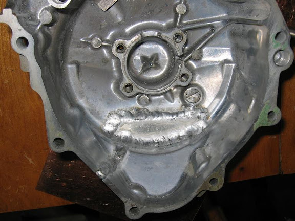

    Hey Tony,
    I don't know if they're as good as what you're looking for, as I consider myself *still* steep on the aluminum TIG learning curve!
    Anyhow, a few pics of some recent projects tackled with my Everlast "Super200P". It has been a very capable machine and solid reliable in its 3 year old age.

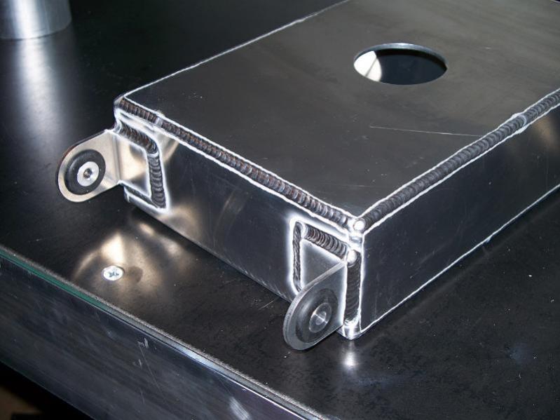

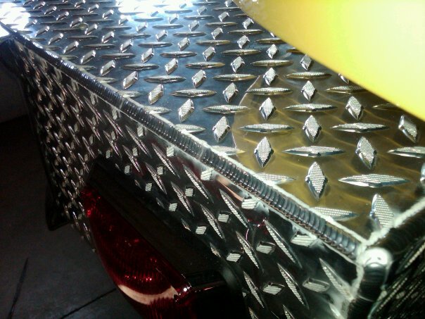

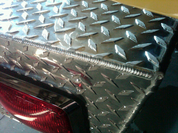

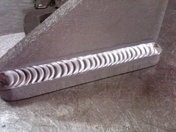

    here are some new ones

    Nice work Tony. Can you give some details?
    Thanks.
    Dynasty 350
    250 hz-300 hz ac freq depending on material thickness and joint design
    material is 5052 varying thickness
    filler is 5356
    EN to EP Amperage Ratio Approx 1.5:1
    balance @ 70% EN
    wave shape - advanced squarewave
    Quote Originally Posted by TonyR85 View Post
    Thanks.
    Dynasty 350
    filler is 5356
    balance @ 70% EN
    Didn't think it was an Everlast.
    Nice to see someone knows the benefits of a shiny clean welding table.. Makes a huge difference working on non ferrous stuff. I wipe mine down with Acetone to keep the oils and dirt from transferreing to the work piece. Sure cuts down on the head scratching.
    Steve
    Miller 212
    Everlast 250EX
    Everlast PowerPlasma 60
    Victor O/A

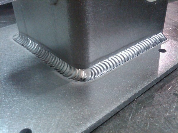

    Not my best aluminum welds I've done in a while (or best pics for that matter--cell phone) but these were done with the Everlast PM205, ~8 or 9 on the pedal, 1/8" filler. I've been stuck wrenching more than I have been welding at my new job where as the last one was full on welding/manufacturing.
