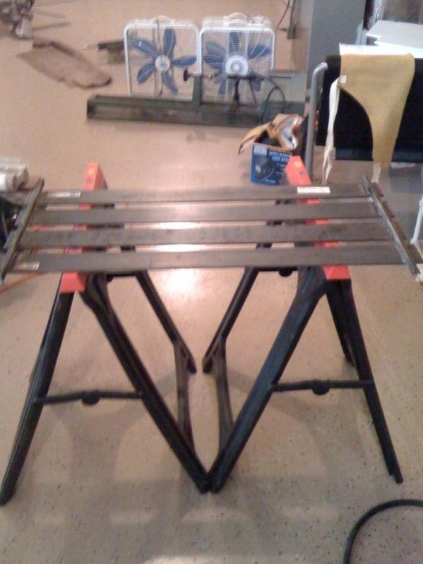

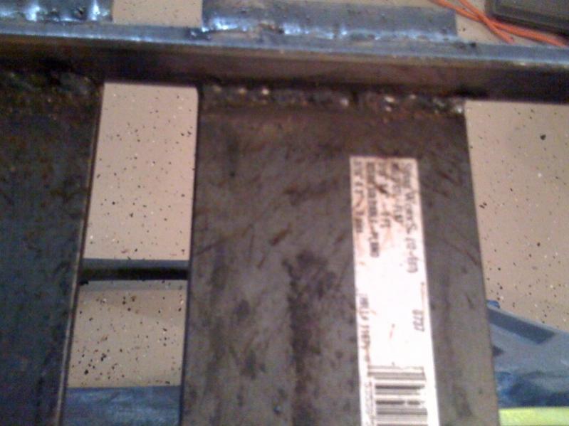

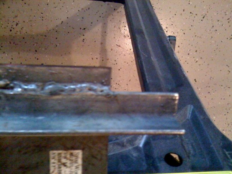

    I welded together a simple welding table top this afternoon. Photos were taken with a phone camera so I don't know if there is enough clarity and detail for anyone to comment on the results. But I'd sure listen if anyone does.

    Jay,
    No offense, but those welds need some work. What gas and gas rate are you using?
    What wire? There is too much spatter. That could be from too long of a stick out or too high of voltage. The arc should be stable and try the arc force about 3/4 of the way to the right. The sound should not be unlike a bumble bee or a mosquito like whine.
    Move your gun to about 1/2 inch off the metal to weld right now.
    A good point to start is probably about 18.5 volts with a wire speed a little over 200.

    No offense taken Mark. Other than watching some videos and maybe 30 - 45 minutes cumulative weld time I'm as green as they come.
    I'm using a flux core mild steel wire .030". Voltage for the above welds was set at 18V and wire feed speed was at "4" on a 0 - 10 dial scale. The material thickness was 3/16".
    Dumb question I'm sure but what did you mean by "try the arc force about 3/4 of the way to the right."? You mean how far I'm leaning the gun?

    Jay your weld metal is too dirty, mill scale reduces heat tranfer to the metal.
    Clean off the mill scale, you may be able to weld through mill scale with a stick welder and certain rods like 6011 but not with a mig, mig welding requires clean metal, Tig welding even more so.
    The welds look humped up which indicates you are not moving fast enough, this is almost the same as not having enough heat, because the heat is directed up on top of your filler bead instead of down in front of the bead into the base metal. Mig welding requires quick movement with the puddle chasing you as you move a head just keeping the wire on the leading edge of the puddle. Watch the leading edge of the puddle at all times so you can control the puddle, we all have a tendency to look back on the bead to see if we are doing good, avoid that it will distract you at this stage of your learning, move fast and throw as much heat as you can handle to make a better weld.

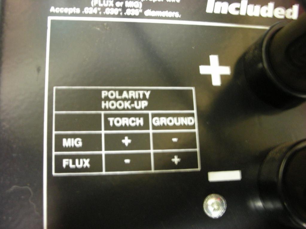

    Check your polarity, with flux core (yuck) you should use reverse polarity, the work clamp connected to the NEG - , you might have to change / check it inside your welder, usually around the wire roll feeder area. That could account for (some of) the splatter.

    Ray,
    Sorry to contradict you but most common flux core is negative, straight polarity. See here:
    http://www.weldingtipsandtricks.com/...ux-core-1.html
    Reverse polarity will cause melting into the tip as well on some flux cores. Dual Shield flux wire can be run DC+. There may be the odd brand that recommends a + polarity on flux core, but most that I am familiar with use DC-.

    I'm sure your right mark, I had it backwards from what I was thinking anyway, been a long time since I've used flux core. An old welder I have has a chart on the front , but it's way old. But that what I was thinking.
    Last word , check the spool..
    Thanks for straitening me out..
