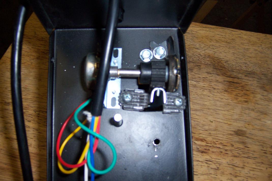

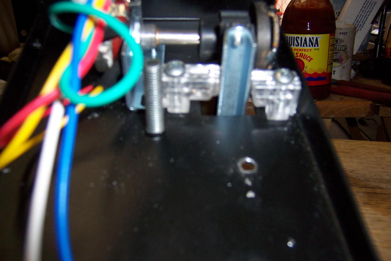

    installed better way to fix pedal guide problem . just takes 2 metal self tapping screws and 2 plastic mirror holder clips . You can get them at a hardware store for like 20 cents a piece . cheap fix .

    Great idea!
    Wayne
    they fit great since back of clip press against switch base and outer case so they dont twist sideways
